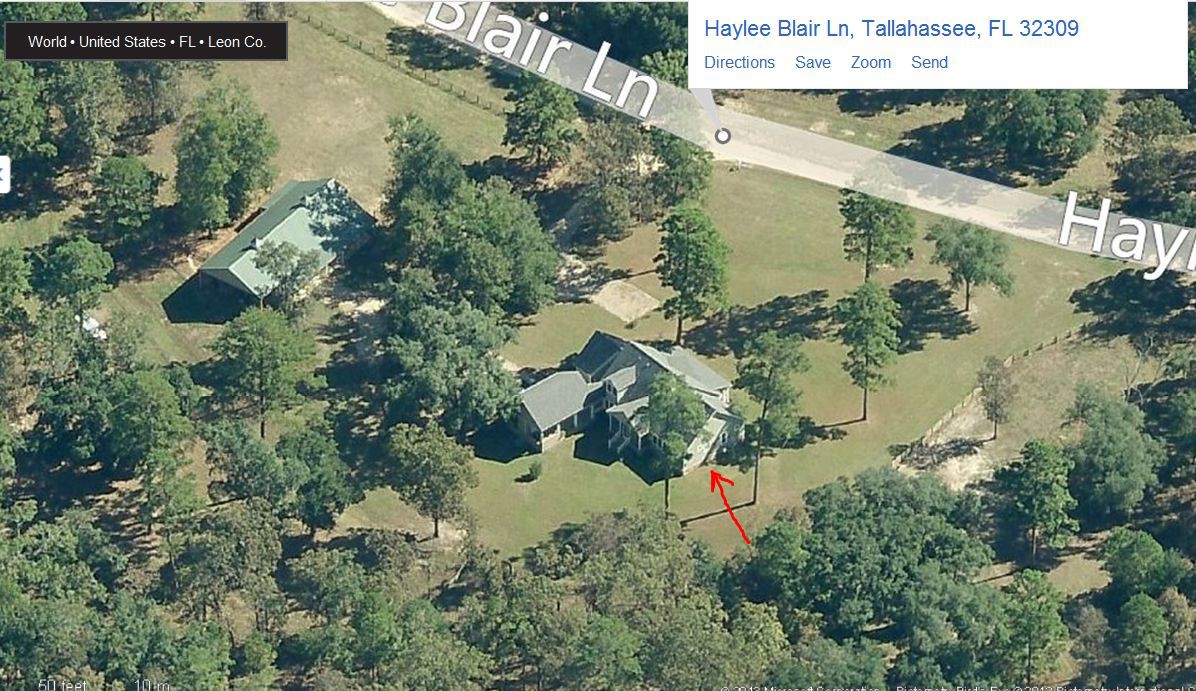

It's outside of Tallahassee city limits (Leon County). Art would never find you or your cat way out there if you wanted to try and get away from him! Allthough he does have all winter to try and track that little feline down.
(red arrow shows the gable end I was spraying)
-- Edited by Capital Roof Wash on Wednesday 20th of November 2013 03:15:22 PM
Andy that looks like 1/2 ag hose and a 0 degree #40 nozzle.

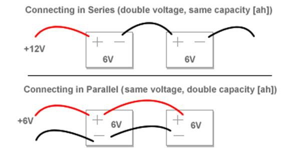

Andy, here's a diagram for my Soft Wash battery set-up in Parallel. 12v to 12v= 12v ... it's still 12v output but double the capacity (double battery life per charge). Hope this helps.

AhhhSooo. I can see clearly now. Thanks.

All you have to remember is that to hook batteries up in parallel you wire them positive to positive and negative to negative. You can hook up four 12 volts like this and its like on giant 12 volt with 4 times the run time minutes. If you hook up positive to negative you are wiring them in series and adding the volts together. four 12 volts in series would be like one big 48 volt battery. This is how they o it for golf carts.
