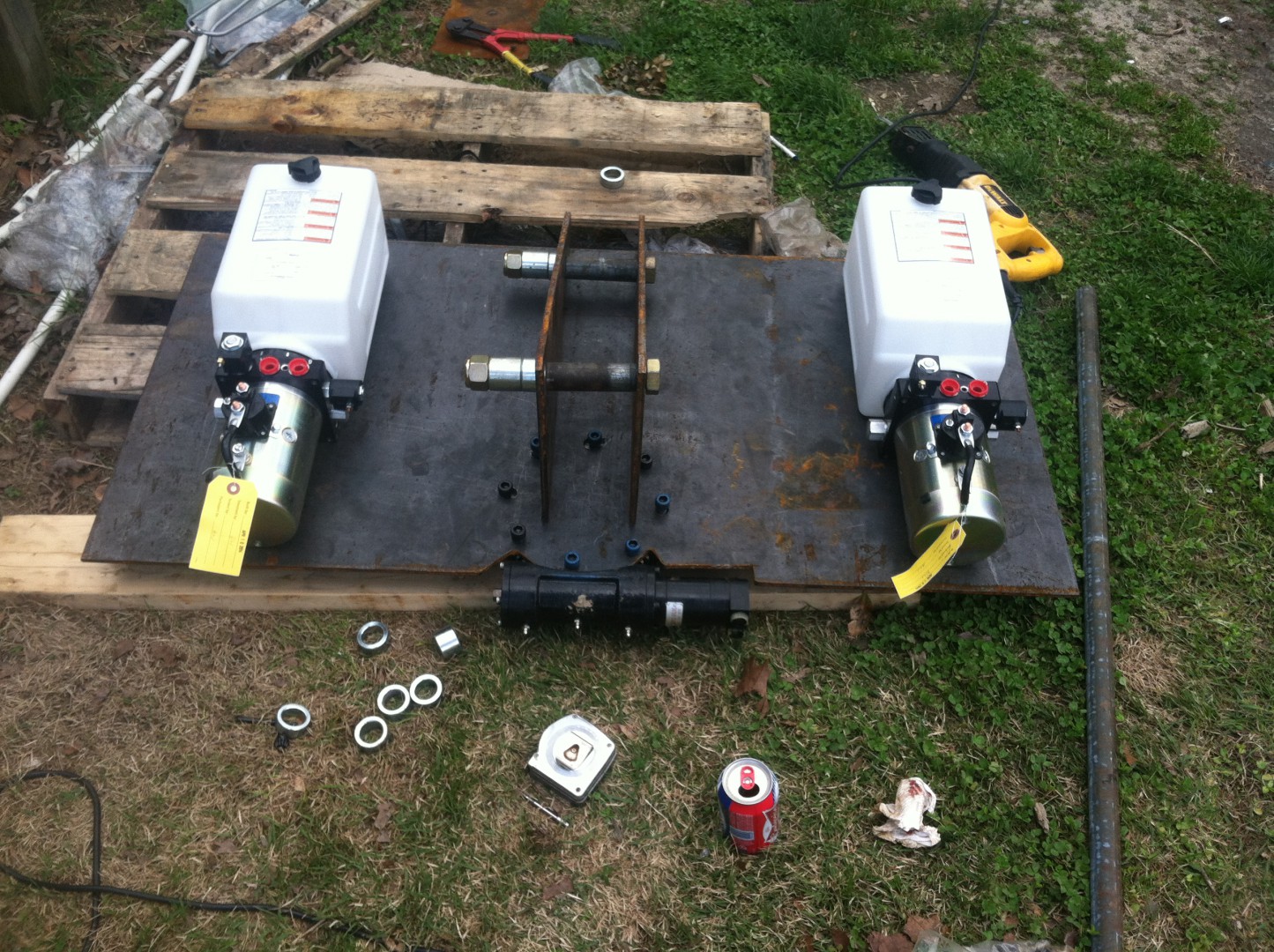

Lol between work & this dam idea I'm falling out.. I'm at the end but no we're near done.. I'm faceing a electrical nightmare! That's after the hydraulics.
I'm all in now! Not stoping! 1 more month...

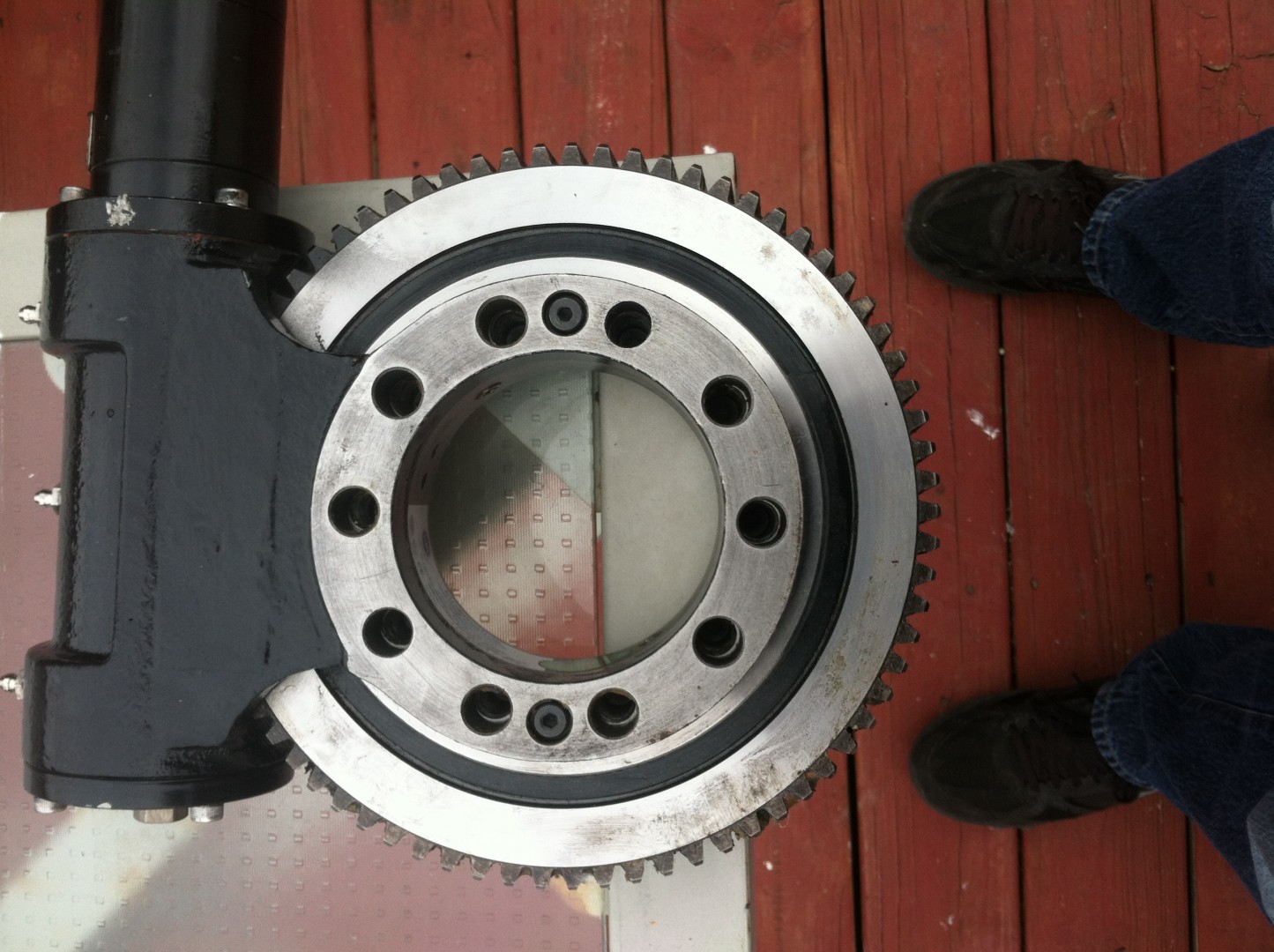

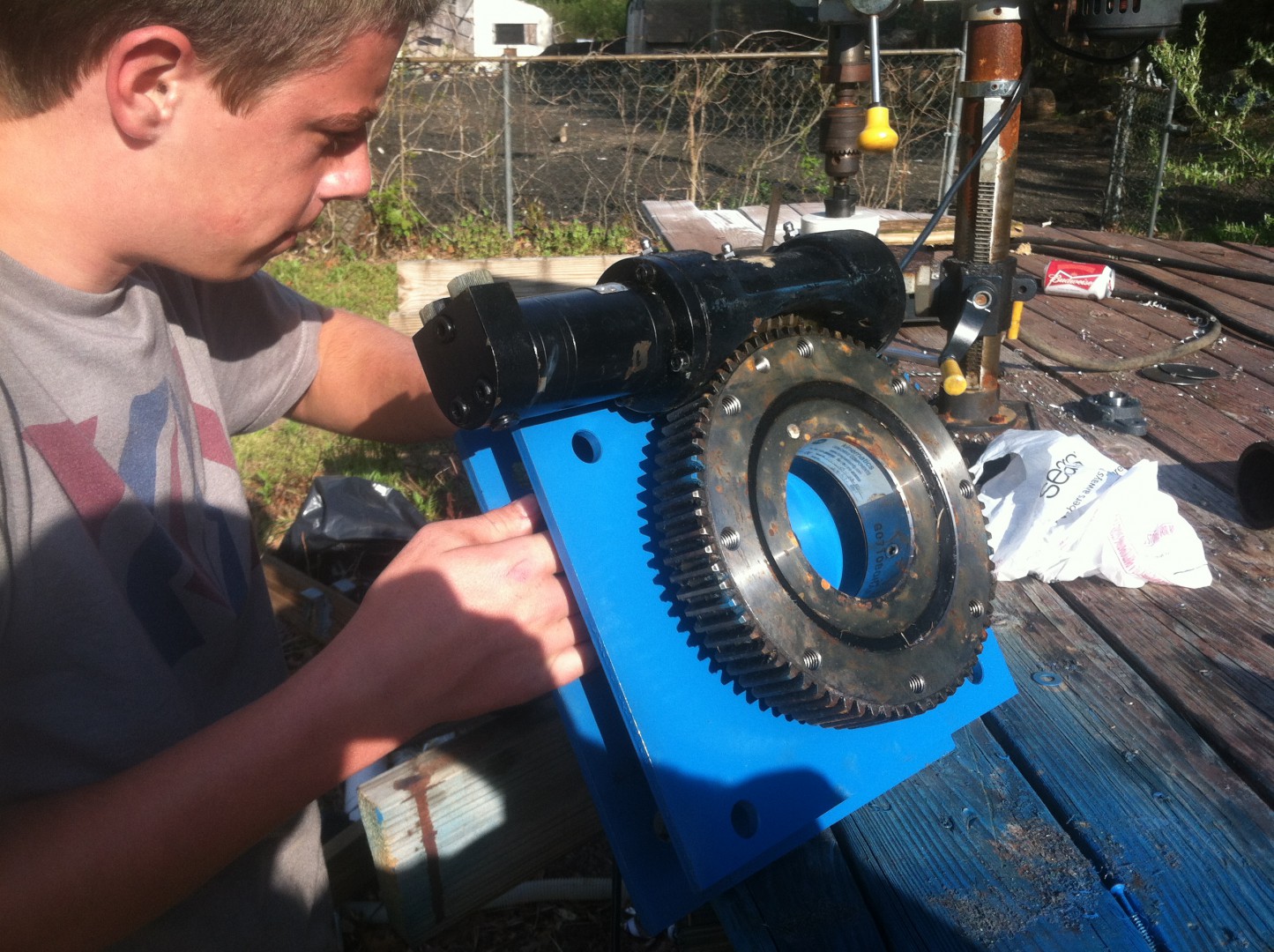

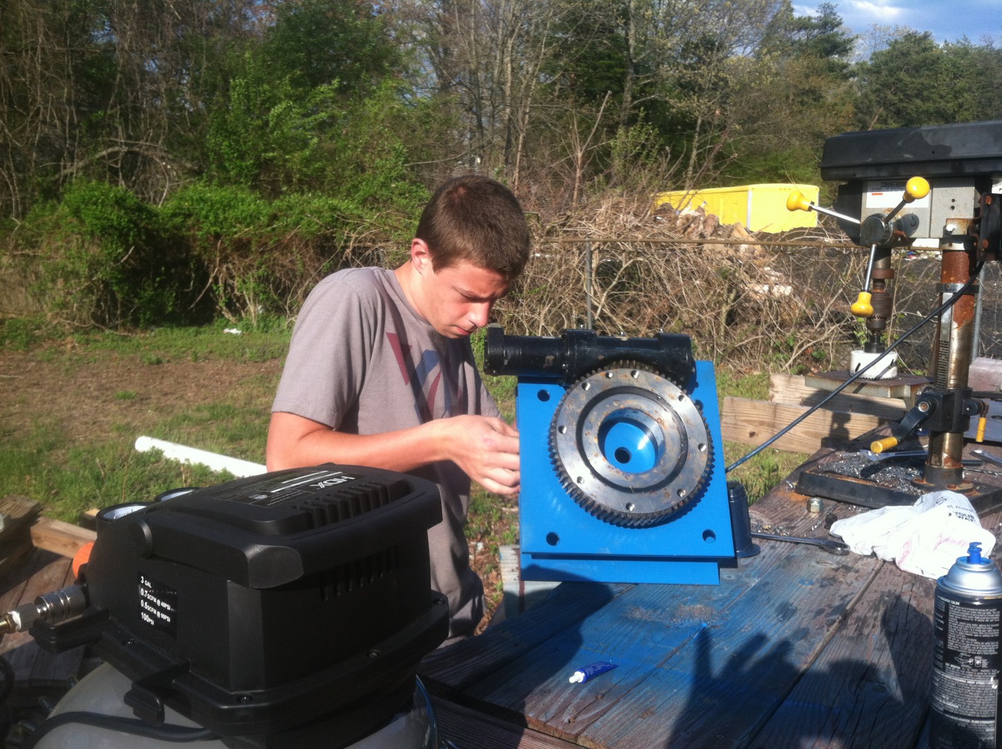

Is that a fly wheel?
PRISTINE ROOF CLEANING said
Apr 28, 2014
hydraulic worm gear

I love the beer cans all over the place dude! Is that drill left out in all kinds of weather? Is your neighbor in competition with you?
May 3, 2014
Pat...can't help but wonder if less beer=faster work!

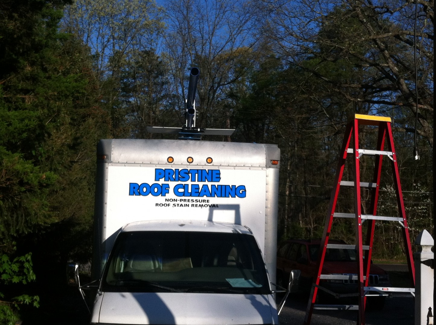

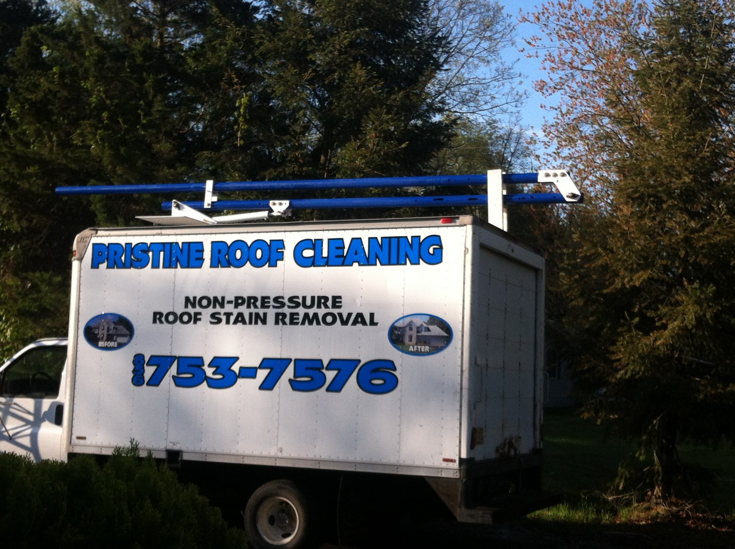

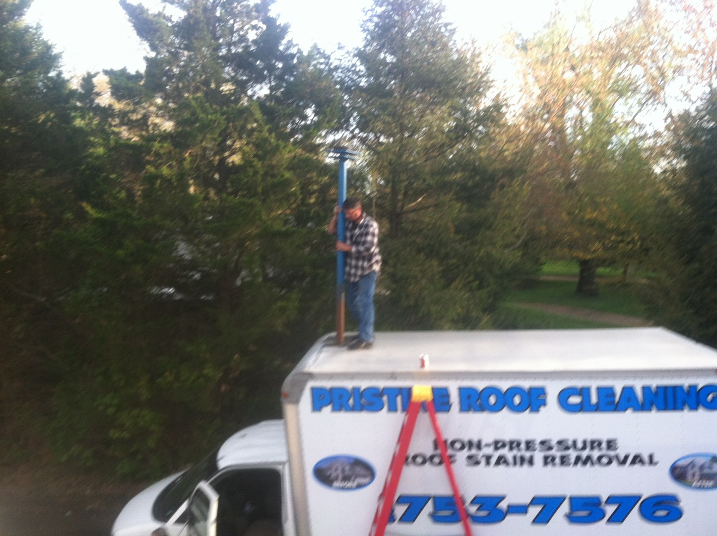

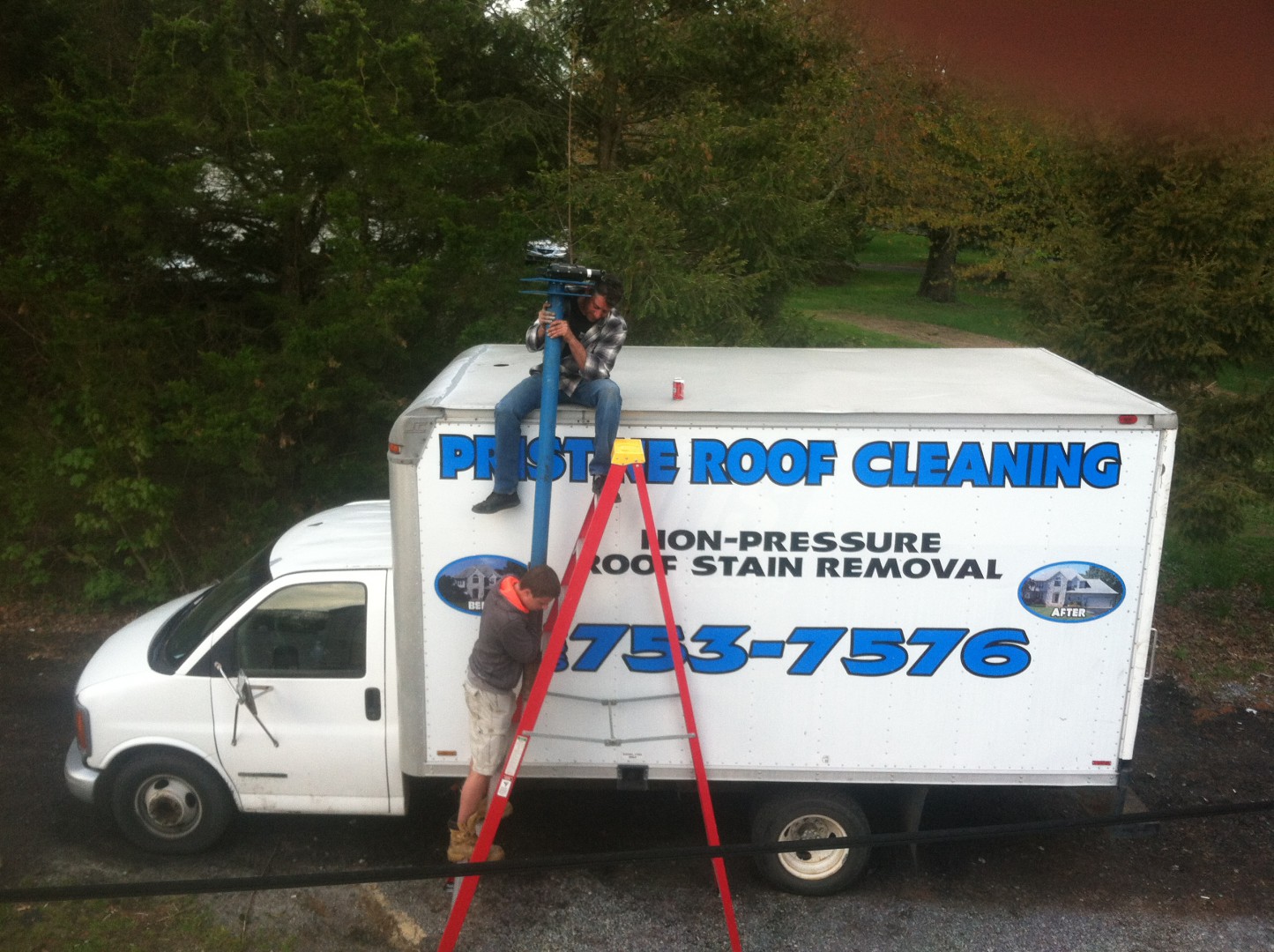

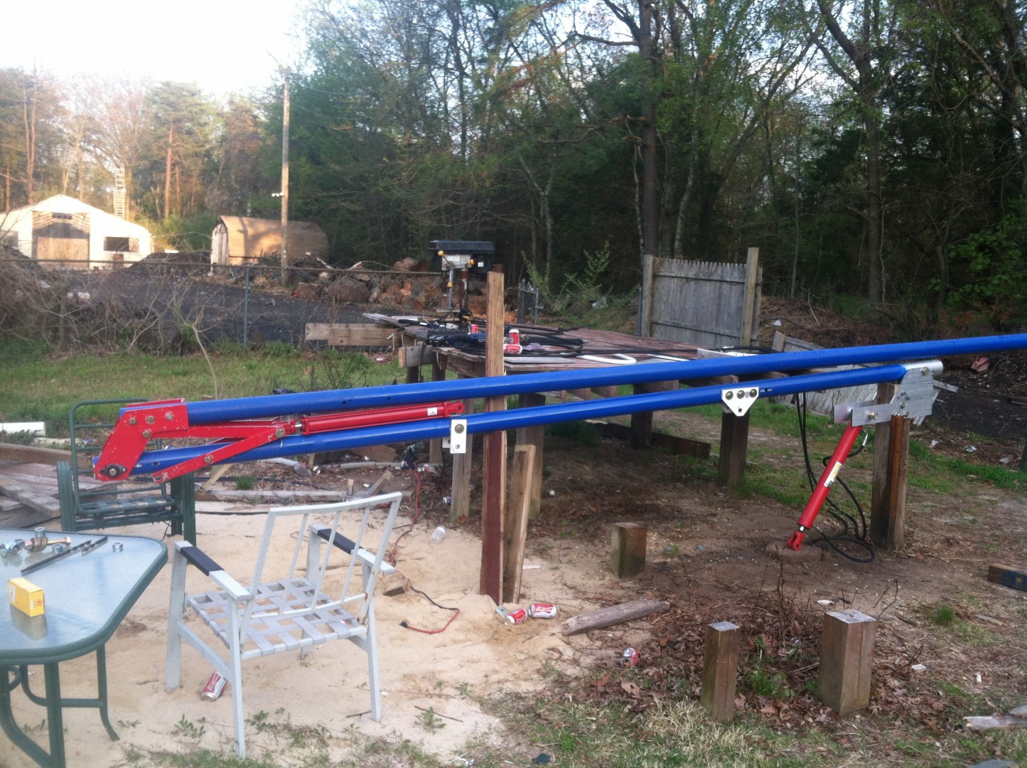

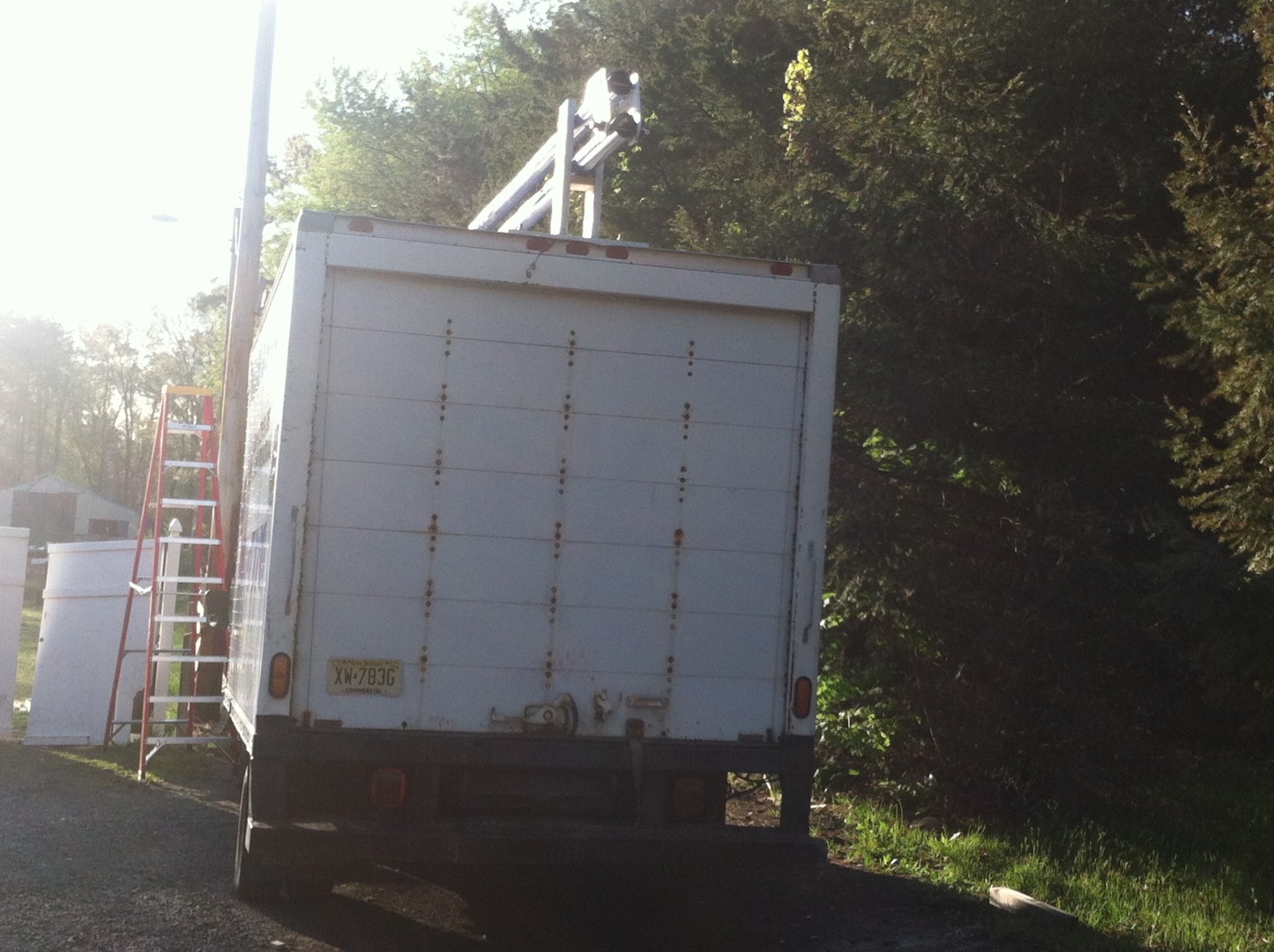

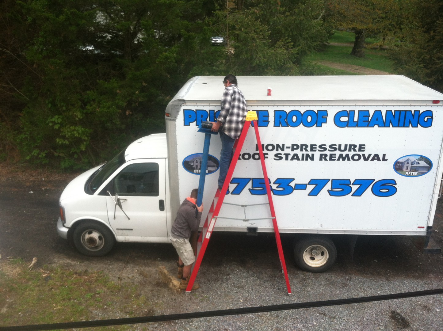

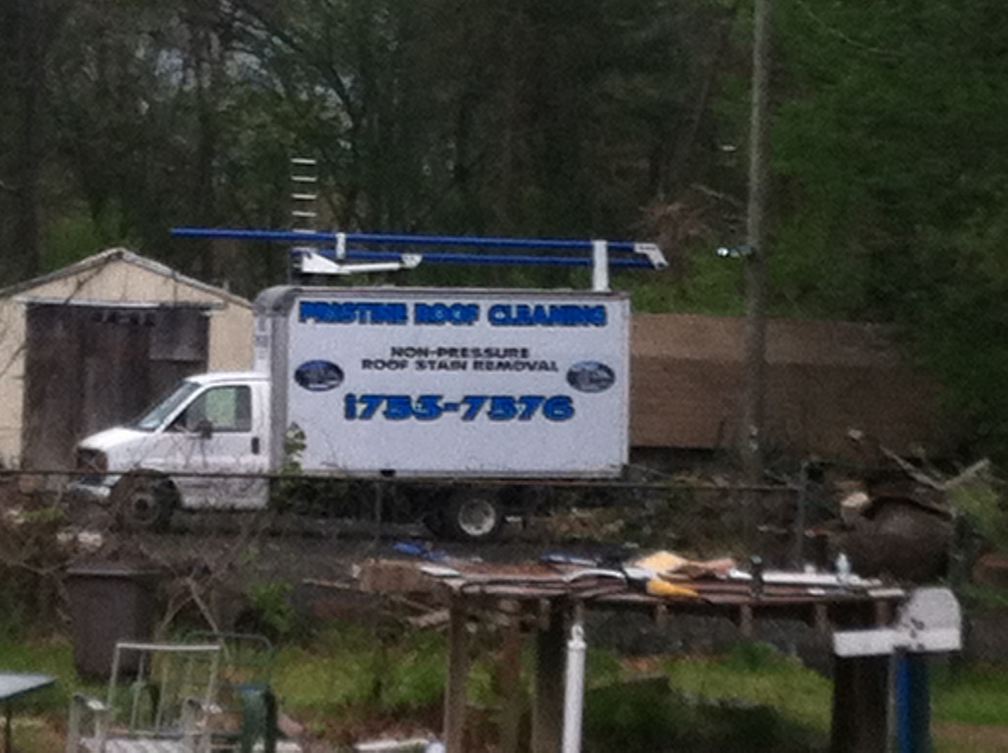

Screwed the pooch! Im a little high.. Wanted total height to be 12' 4" off the ground. Looks like im gonna be 12' 8" Oh well still with in bridge height... Pics are to show that im doing it strong.. After these pics i think you guys will get the picture of what ive been talking about for the past year...
You must do some extremly tall roofs. Unless you can get next to the home or business with it. How will it be used?
May 4, 2014
The same way your local tree guy gets his bucket truck to a tree.. In this case its easyer..

My truck is 10 FT my boom will extend 40 FT & my pump will shoot a min of 20 ft Thats 70 ft of love spraying 3 storyes up that ass baby....

How have you reinforced the truck. Get that baby 45 ft in the air with a decent blow and you will have a convertible truck.
What impact does that put on the load of the truck etc.

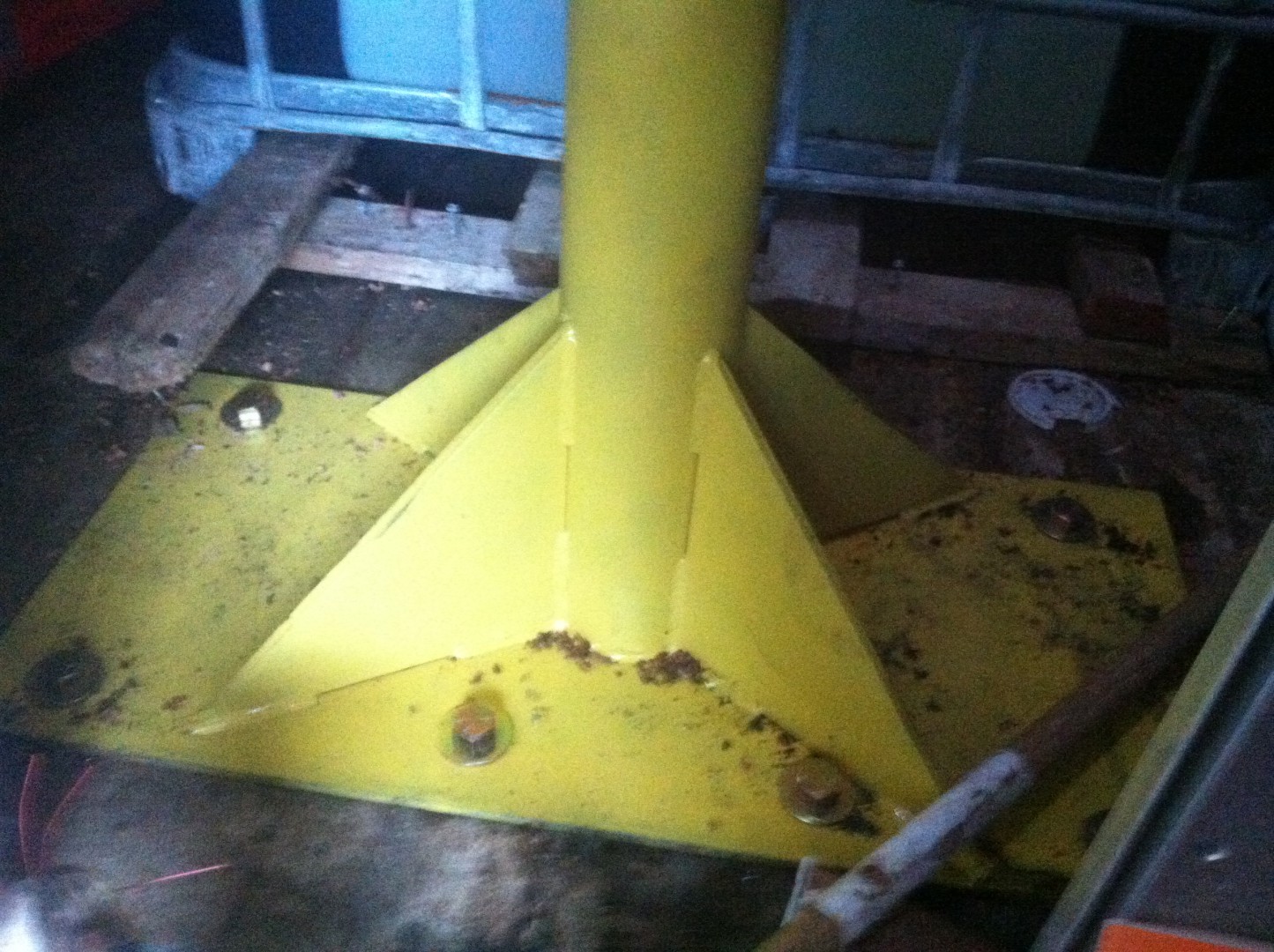

Ugg.. I thought a picture speaks a 1,000 words? ok..

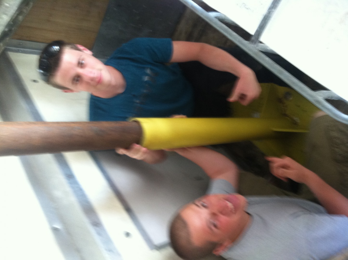

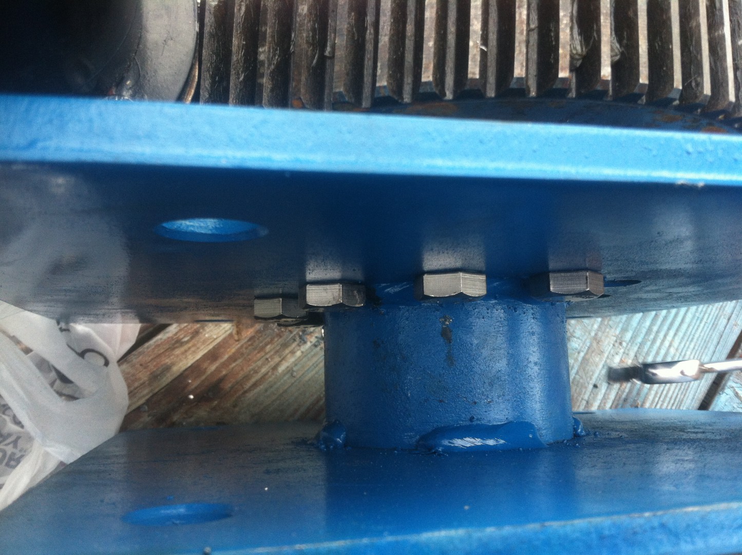

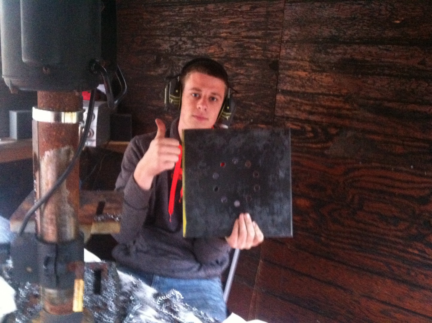

On the second pic post - 3rd pic you will see a yellow part. That is 1/2" steel monted to the floor wit 8"x 1" harden steel bolts going thru & in turn mounts brackets to the frame of the truck 10 bolts 5 -1/2" steel brackets.. A 3 ft 4" diamiter schedual 80 steel pipe is welded to this plate, in turn a 3-1/2" schedual 80 steel pipe that is 7' 4" long goes threw the roof of the truck and slides into the 4" pipe ( see pic #6 on the 3rd pic post) The actual sticks ( boom) only ways under 200 lbs, & is mounted on a steel spine. Please dont assume that its just mounted on the top of a box truck.. It hurts my feelings!
This is not ment to lift anything or anyone. Its only ment to hold its one weight. our same cleaning hose runs threw it.

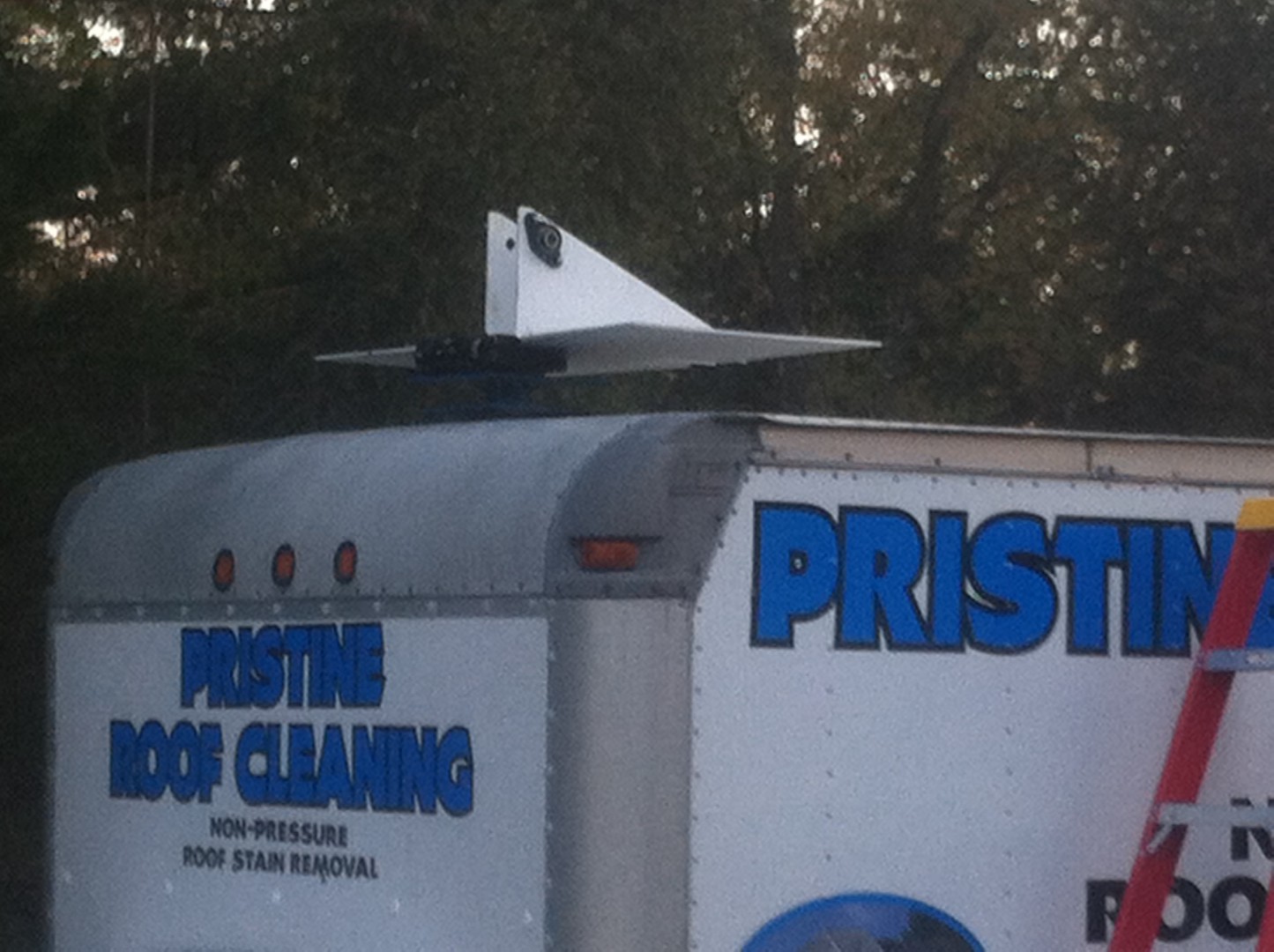

The assembley is finished and is mounted on the truck (pic's did not go threw) Now its moters, hydraulics & wireing.. Gonna take a little time. gotta pay attention to roof cleaning & walk away from this for a little while.

Its hard to see. There is a few hydraulic flow valves that alow for speed control. while your takeing out your ladder ill already be spraying the roof. In most cases i wont have to open the back door. just pull up grab the remote and fly it .. It will be done soon..
