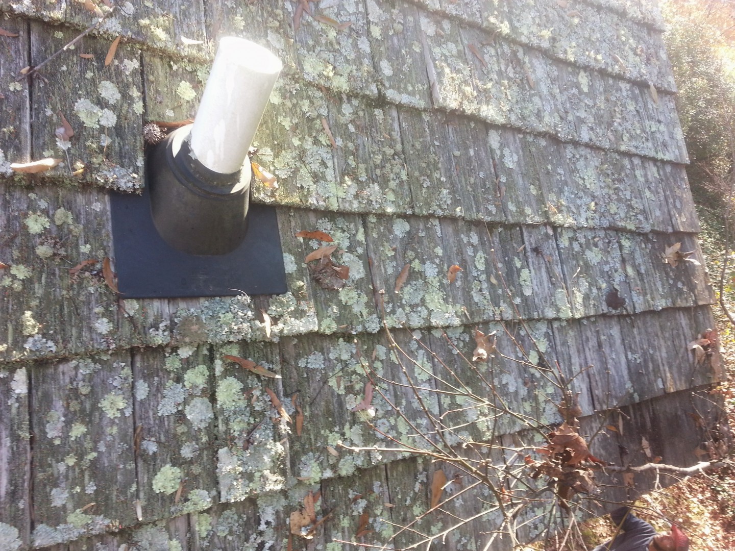

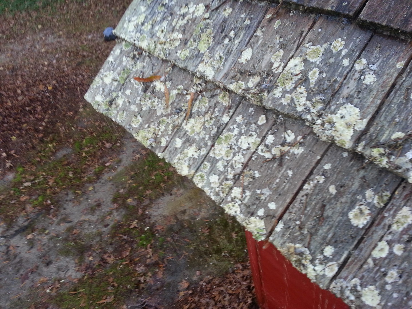

This is an excellent way to get it cleaned. Especially on cedar roofs that are just black with algae and mold. What would you say do when the roof has tons of growth on it? Would you spend time rinsing each shake thoroughly to get it all off or would you just make sure it's all dead then spray it with oxalic and let the rain do the rest? Thoroughly rinsing sometimes can take days. I've uploaded some photos for examples.

Josh Brown wrote:
Diamond Roof Cleaning wrote:
Pre wet the wood. Treat it with a 2-3 % solution. Let dwell. Then rinse using a garden hose with a jet or stream tip. When done treat with an oxalic acid at 12 ounces to 1 gallon of water and apply to cedar. Make sure the shake is not brittle or mushy. If so the replacement is the best option. If moss is present you just have to soak it with more solution. Letting it dwell is the important part. Never spray bleach on dry wood.
-- Edited by Admin on Wednesday 30th of November 2016 07:30:32 PM
Josh,
I thought you bought into Bruce Sullivan's Network? Doesn't he have an opinion on what to do?
