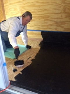

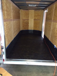

From experience, I would put some kind of paint on the rest of the plywood to protect it. I did almost the same thing you are doing with my first box truck and after a few jobs wish I had painted the whole thing. The plywood is going to get wet mo matter what. Plus, all the screws will be protected as well.
Thanks Brett, I was wondering about painting the rest of the trailer and also some lighting solutions.

Steve looks great but a suggestion is to coat well up the sides if not all so you can occasionally hose down all your equipment and rinse out the trailer. Personally I would go halfway up and coat the rest with a gloss finish industrial epoxy floor paint in white (so you can mark out with pencil if building shelving etc and tagging what goes in that position )

I would screw down a nice 3/4 inch plywood over that......In my trailer I put the plywood down first and painted over it. The plywood has some deep holes in it from spilled chemicals, leaking valves etc. Every year I go underneath the trailer and check for floor rot....nothing and it's about 5 years.

If I were to use an enclosed trailer with wood walls,..I would seal them and then put some shower stall type material on top of that,..would clean up easy and really protect the wood,.if installed properly,..and would also brighten up better than paint alone.

So you guys would put another layer of plywood on top of the actual trailer floor I just sealed?I really appreciate the advice.
Feb 17, 2016
Well it would help keep the current rhinoliner from being worn away.
If you tried to recoat after its been exposed to grease etc you will rarely get a best bond.
Think of it as protection for your protective layer.
Just fully seal around so you don't get moisture trapped between layers

I'm picking up a new 14' enclosed trailer. I will coat floor with herculiner and then 12" up wall, then I'm heading to Sherwin Williams to coat up the wall with something they recommend.

Tim, that is what I just finished doing. I would like to know what Sherwin Williams recommends to you.

I finished all the painting and getting ready to install some led lights. Meeting with wrap guys tomorrow.
