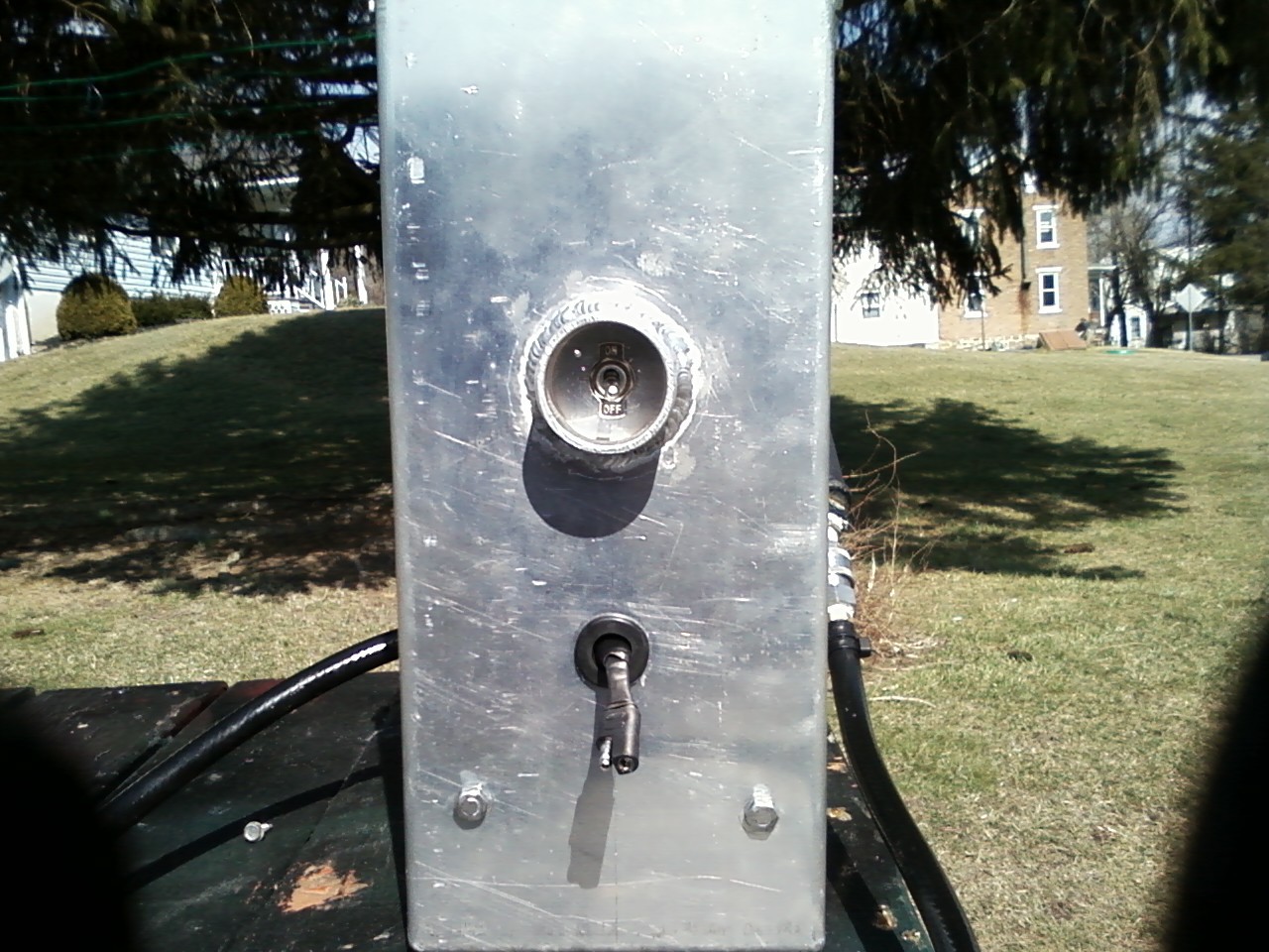

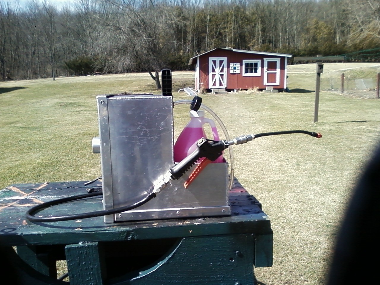

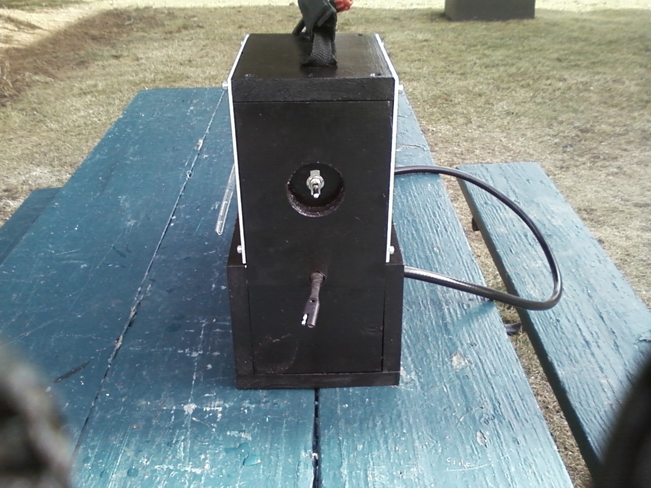

So I wanted a small truly hand held 12V. So here is what I came up with. I am gonna use this prototype for while and see where I'm at with it,..then I am gonna have the local weld shop make me one out of aluminum. I made this so I have total access to the internals. Pump and battery and all connections are easily accessible. With this full 1 gallon jug of windshield fluid it weighs exactly 20 LBS.
But,..weight isn't an issue, only gonna be used sparingly as mentioned above. Could also add a shoulder strap if needed,..don't see me doing that though.
Can simply swap jug of this for a jug of that with no swishing out a sprayer,..and therefore don't have to have multiple sprayers,..one sprayer with different jugs and even a 16 OZ. water bottle maybe to rinse pump between chemicals.
The pump is Delavan 2200-201,..and the battery is a small 12V 5AH. All connections are soldered and dielectric grease applied. I have a spare pump on the way. These pumps will be abused by strong cleaners but I don't care,..they will make money.

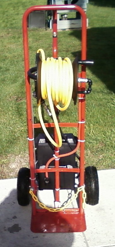

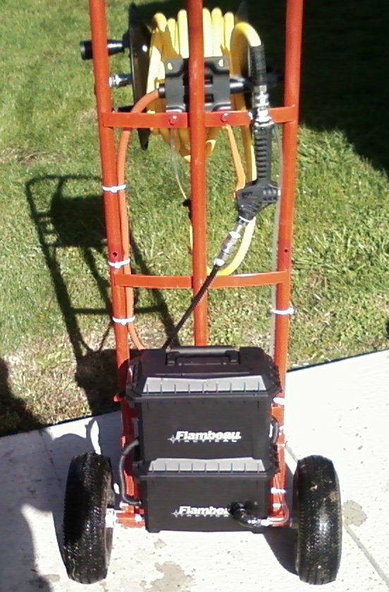

*I added a picture of the hand truck rig as well. The hose reel is actually just a small air hose reel,..but,..the design of these reels allows for a nice way to make the manifold out of the hose,..meaning no internal rusting.

This thread is simply about spot spraying.
-- Edited by Jeff Wible on Friday 26th of February 2016 05:41:43 PM
Feb 26, 2016
Sorry Jeff, saw the hand truck design which I had and converted it to small wagon, easier and wanted to give you a pic as an optional idea.
I'll delete it and find a pic if you want.

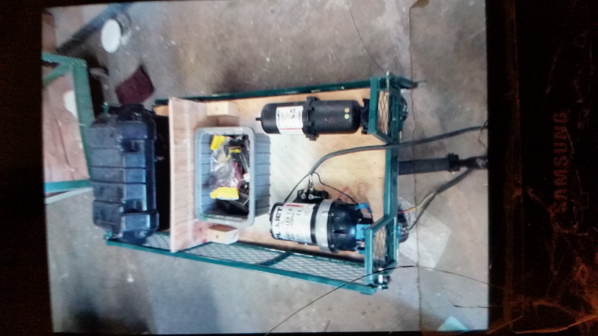

That has been in my mind for years after seeing something similar that Hoover had. I have been using a 5 gal. bucket with the pump attached to the lid and the pick up going through the hole in the lid. I like the compact design and the jug method!

The only thing I didn't like with my hand truck was it kept tipping over on rough ground. Top heavy. The wagon is much better for me. Still use truck for 35 gal poly tank of SH transport

Maverick,..If you loom at my hand truck,.you'll see the real weight is at the bottom,..it's where the 5 gallon bucket sets,..and also the battery and pump are located at or near the bottom. This isn't top heavy at all.

Relook ed and see the yellow chain is where a sample bucket is. Cool. I see how the 5'ver balances out the battery and pump on other side.
I throw a section of hose in a rubbermaid trash can and carry that in other hand. These are old pics, slightly modded now, drop the sides and pu line goes to pump, pump to accumulator out to spray hose.

Maverick,..is this your roof rig? That looks like a pump capable of roof jobs. I ask because,.. although I run hose from the trailer,..I can sometimes see how a portable unit would be convenient. Maybe I just get tired of dragging out 200' of hose to spray for 15 minutes I used my hand truck model on a couple of small roofs last Fall,..in a way,..I kind of liked it. And I didn't use as much mix as I typically would have running 3/8" hose and 2 GPM pump.
Hey Art,..didn't know that about Delavan,..does that cover bleach use? Anyone care to chime in on this warranty and success or lack of success with Delavan,..go ahead. This pump does have viton and santoprene,..same as the bigger Delavans.
Regarding the $495.00 unit,..I also don't like it not being enclosed,..Maybe just me,..but I prefer the 'workings: to be enclosed.
*On another note,..the sprayer,.being made of wood doesn't like to have typical screws screwed in and out,..so I use threaded inserts,..that way the hole has a sleeve made of metal, and regular bolts can be used.
**Also gonna change the handle to something more substantial,..don't really like the idea of SH mist getting onto the cloth handle and rotting it and having the whole thing fall on my foot,Ha,Ha,.. Jeff

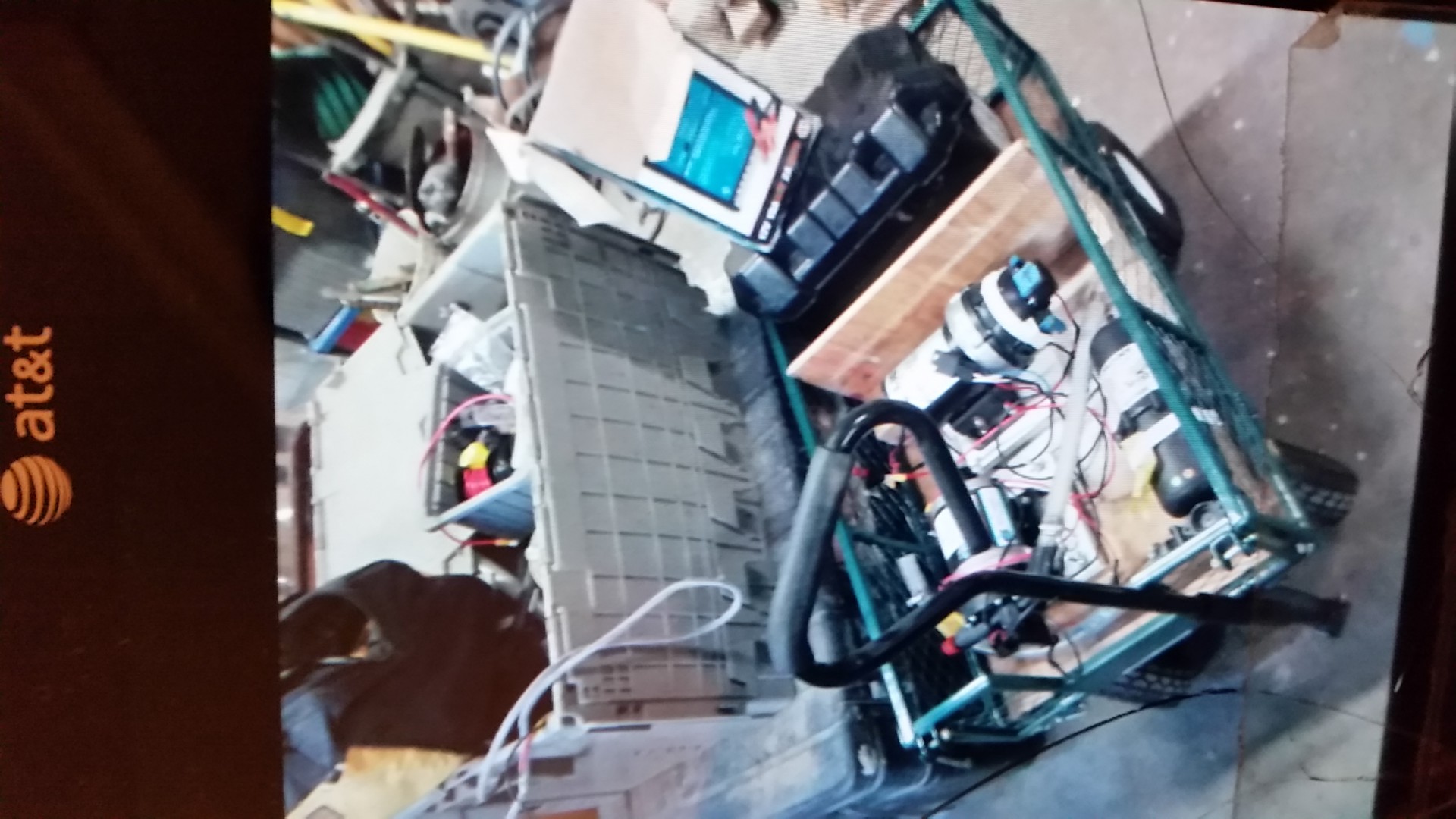

Jeff, yes, I built it this way because I mainly do painting and historical restoration so my box truck is a "truck of all trades", hence I designed it to be modular and multi functional. The small unit can be dropped off at any site for the guys to use while the truck goes to other jobs doing deliveries (incl up to 5 stories of scaffolding), stay on a site as a mobile carpentry shop then pu at end of day.
It takes 5 min to load up with a box containing 2 100 ft of hoses easily carried on shoulder and a parts box, 55 gal rubbermaid garbage can for mixture.
Simple, fast, mobile, versital, can do sample work up to running 2 pump crews for huge "mansion" jobs as for last post. But the biggest reason I went this way is because a lot of these large estates I work on I don't have access to drive a truck to a building I need to service so I needed a portable unit.

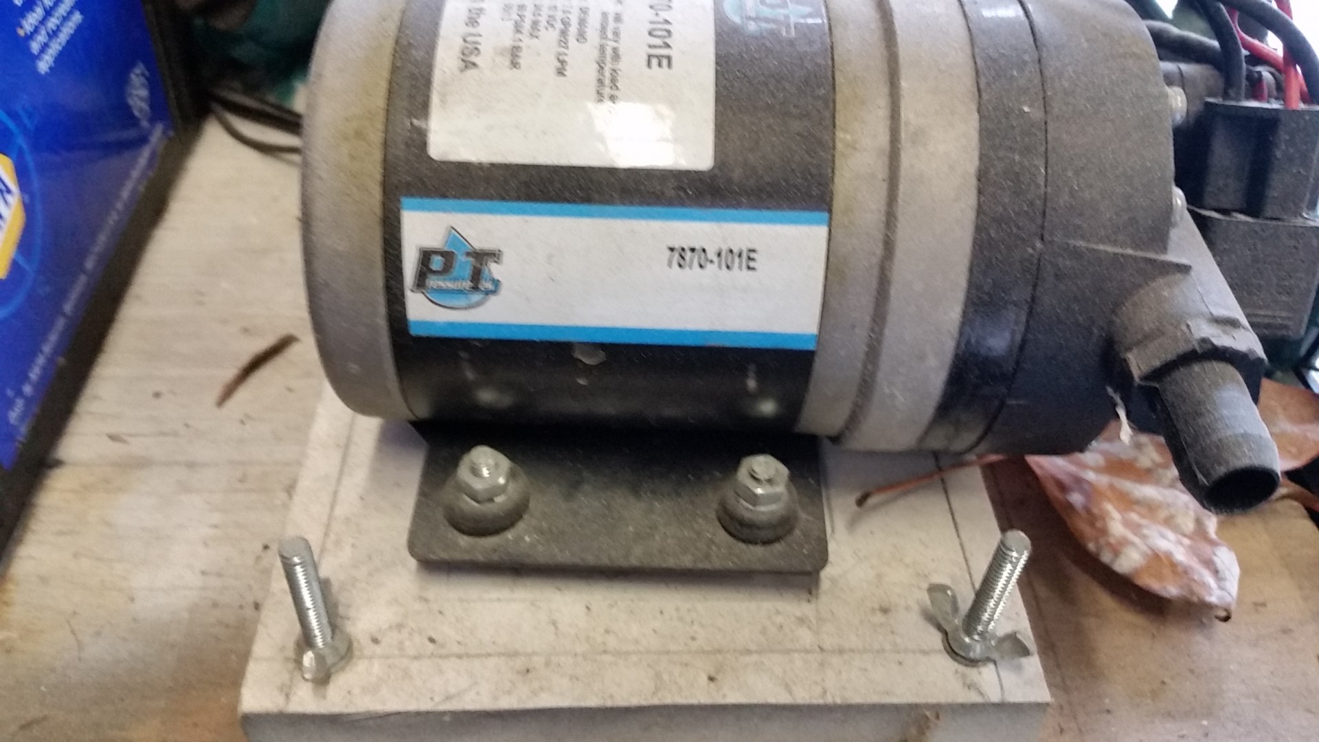

Right now it's set up so pumps can be interchanged by 4 simple wing nuts, 5 min swap out.

Maverick,..I'm gonna steal your wingnut idea. That makes sense with these little "abused" pumps. I made mine also with "swap outs" in mind. Don't want it to be a PITA.
I had it made out of aluminum,..but I screwed up,..I didn't need these same dimensions,..I could have made it smaller due to the thickness of the thin aluminum compared to the thickness of the wood. But,..I'm likely gonna have another one made. I have a guy who might want this one. He cleans pontoons and wants to go 12V,..so he could use this in a couple ways,..he could set it beside a 5 gallon bucket and add 50' of hose,..or he could use it as a portable.

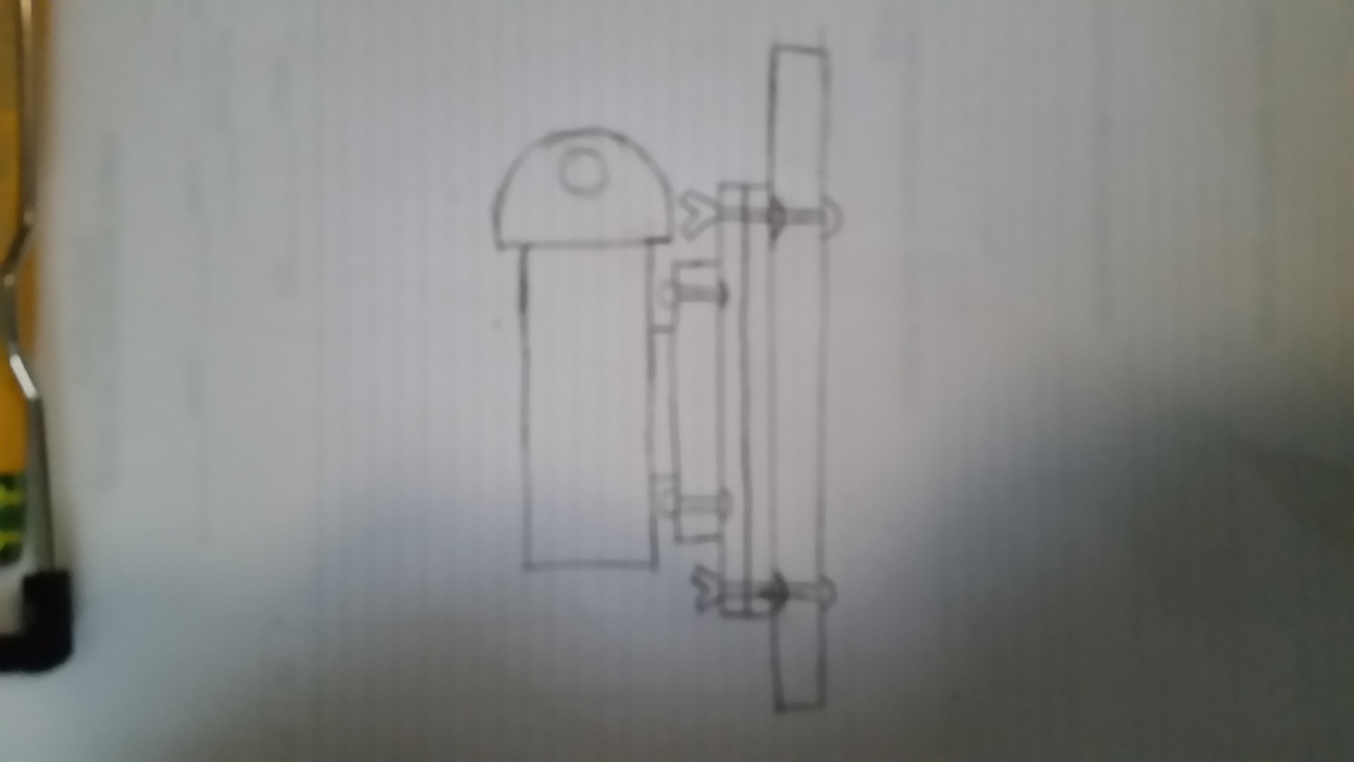

Jeff, I used a block of Azek PVC " wood " mounted to my rig with the bolts and a 2nd block moun\ed to the pump bases since I use different pumps with different mounting points and drilled holes in that piece. That then slides onto the bolts with wing nuts. May want to add lock washers but I just check em before use.
I'll try to get a pick when I get to shop if it helps
Some idea
-- Edited by Maverick Contracting on Tuesday 15th of March 2016 08:22:08 AM
-- Edited by Maverick Contracting on Tuesday 15th of March 2016 08:23:14 AM

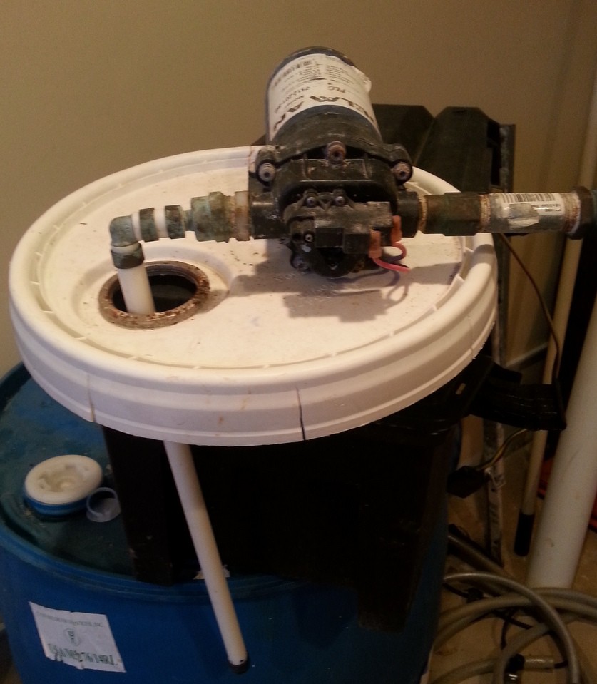

Hey Maverick,..I know exactly what you're talking about. I mount my All-Flo to a plate like that,..just so it's easier to get the bots in,..even once,...
Because the mounting holes on the All-Flo is the worst design for such a good pump.
Didn't think of doing it with the 12V,..I will see how I go through them,.and may just end up doing what you did. Just trying to keep weight off the hand held.

Just an update,..aside from the remote,..this is the best tool I've had for a while. Very flexible. Used it the last couple days,..so much nicer than any pump sprayer. One canister in,..one canister out.

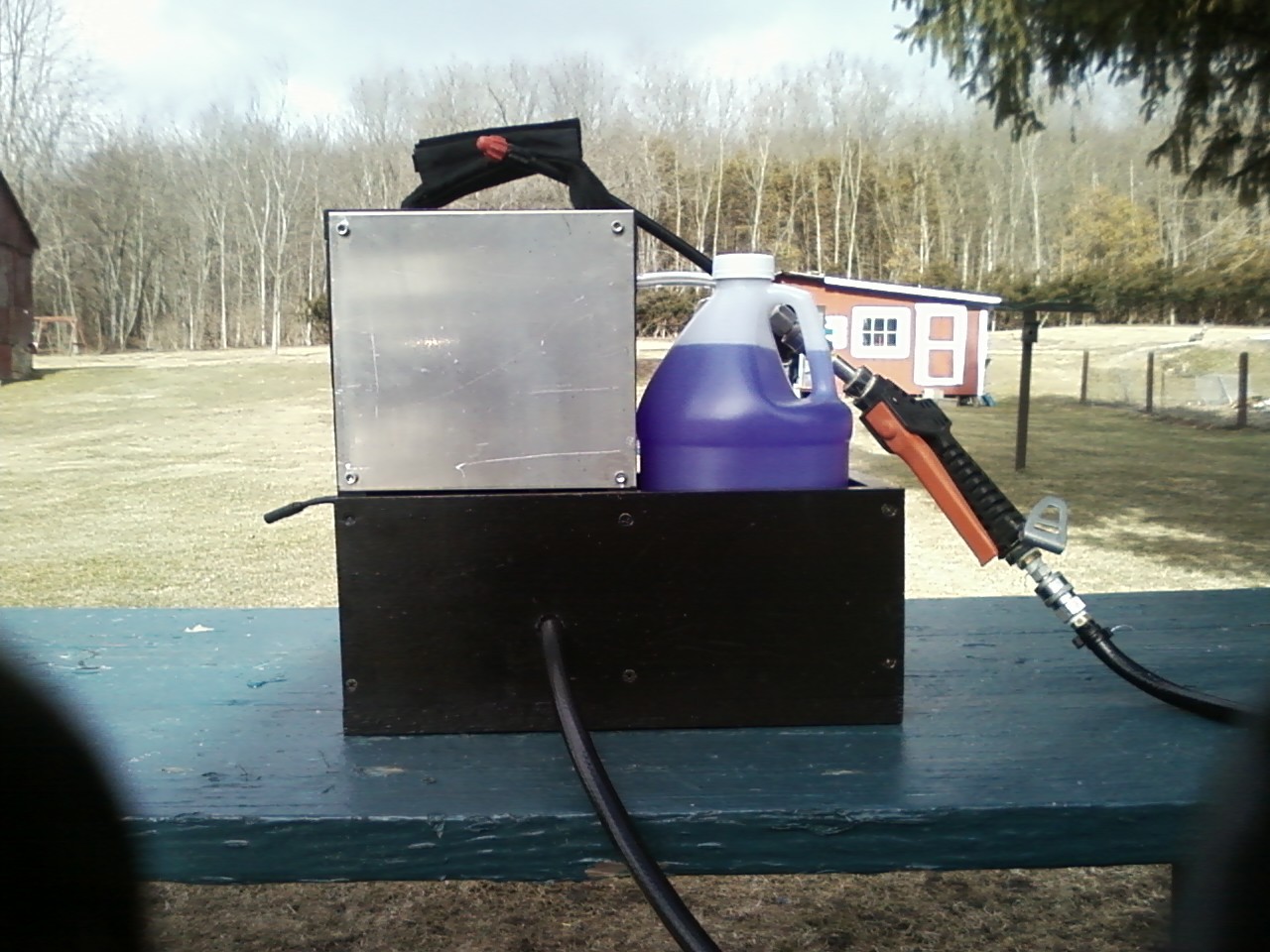

I was inspired by a portable that Pinky made so I threw this one together on a whim for deck stripping. It is portable but not all in one unit like Jeff's. The 2 gpm pump mounted on the lid was quick and easy with pex going through the pour hole. The battery is in a small rubbermaid container. Now I just need to make it all on a hand truck and find a place for it on the truck. Thanks for posting all this Jeff!
-- Edited by BlueRidge on Friday 25th of March 2016 12:23:30 PM
Yea Brett,..my idea is a sprayer for every need,.the hand truck sprayer I made is nice,..but can be too much sometimes. But sometimes it's just right. All job dependent.
Here Ya go jeff, I hear you bout keeping it lightweight
Mine is way better than those store bought models, Ha,Ha,...My unbiased opinion of course.

I was thinking of using a steel hand truck I already have but thought it will be a rust bucket soon so I looked for aluminum. This site has fair pricing as well as design your own. I think I will go this route when I make mine compact and portable.
