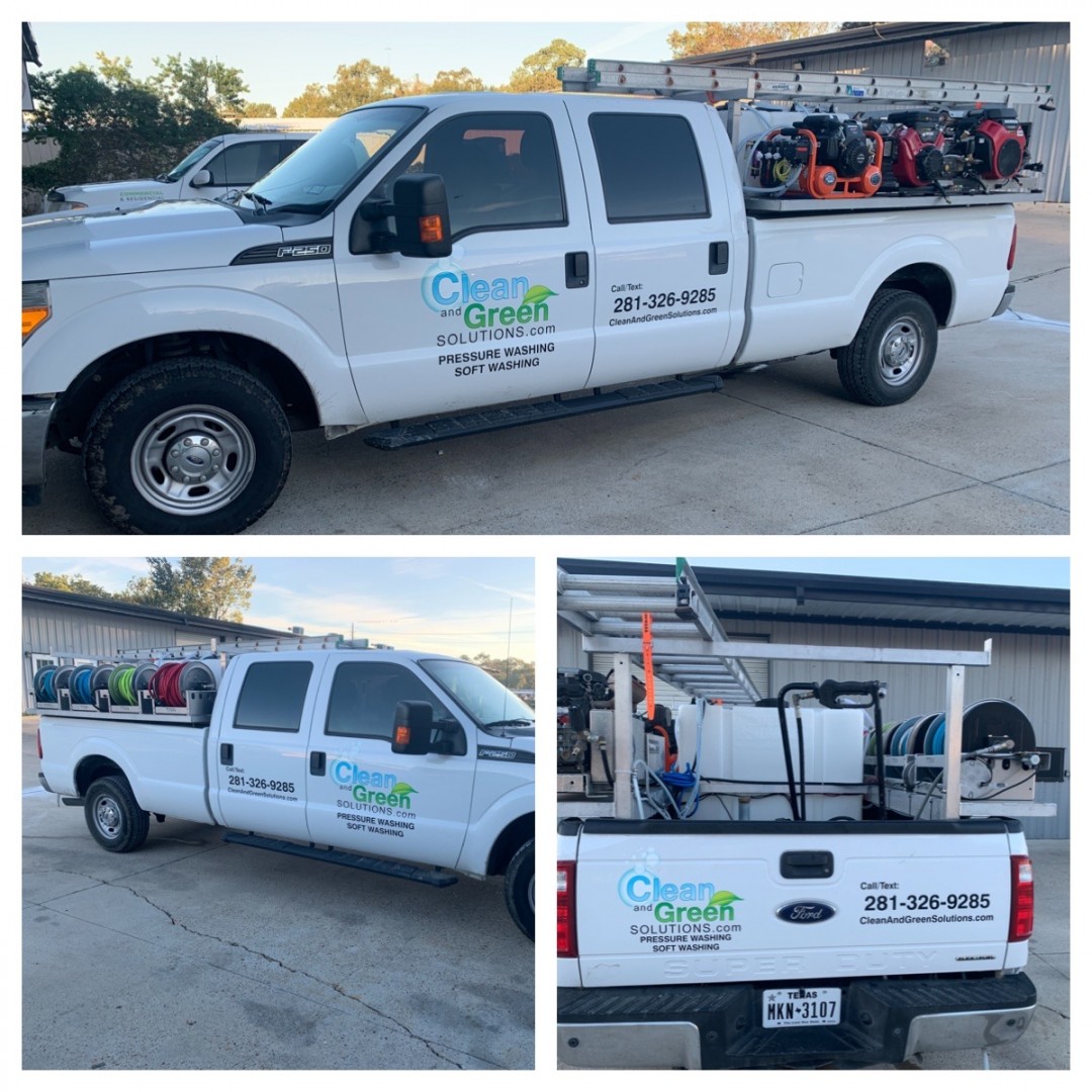

started with 12V, went to air, went to gas operated UDOR, back to air, then to booster, back to air, back to 12V, back to air, and staying with air. Just the most dependable and reliable dedicated pump I've found. Just completed a truck skid build a couple months ago an LOVE IT....no more trailers.

Wow Doug, That is a great build! it looks so easy to work on without everything packed into a skid in the bed.
Now that I see the small compressor I might look into air for the flatbed coming in January. I might be paying a lot of attention to this thread since I have the booster down but not air. In the end I most likely will stay with the booster because I have so much stuff already and will not have to buy much for this flatbed set up. I'll see as this thread moves along. Hell, all the other stuff I have will always be good for back up WHEN something breaks!

Doug what size compressor is that and what pump is it running? That thing sure looks smaller than what everyone else is using.
Pat needs another rig, sure he would love what you got in that truck

4 GPM portable pontoon air compressor
5 HP Honda Industrial OHC/OHV premium residential gas engine
155 PSI Max Pressure
Maximum Pressure: CFM at 90 PSI: 5.0; CFM at 40 PSI:6.9;
7gpm flo jet.

Doug, I really like your build. Looks like a Lee skid. I just bought a new F250 8' bed with the intentions of going to a skid from my enclosed trailer and getting out of DOT and paying for trailer storage.

Chris Gunther from South Carolina built it, I was just a little more impressed with his welds, plus he's been around the biz many years, even back to the old PWI days.
Yes. I am thinking the same. I spoke to Chris about his skids and he is a good guy.
