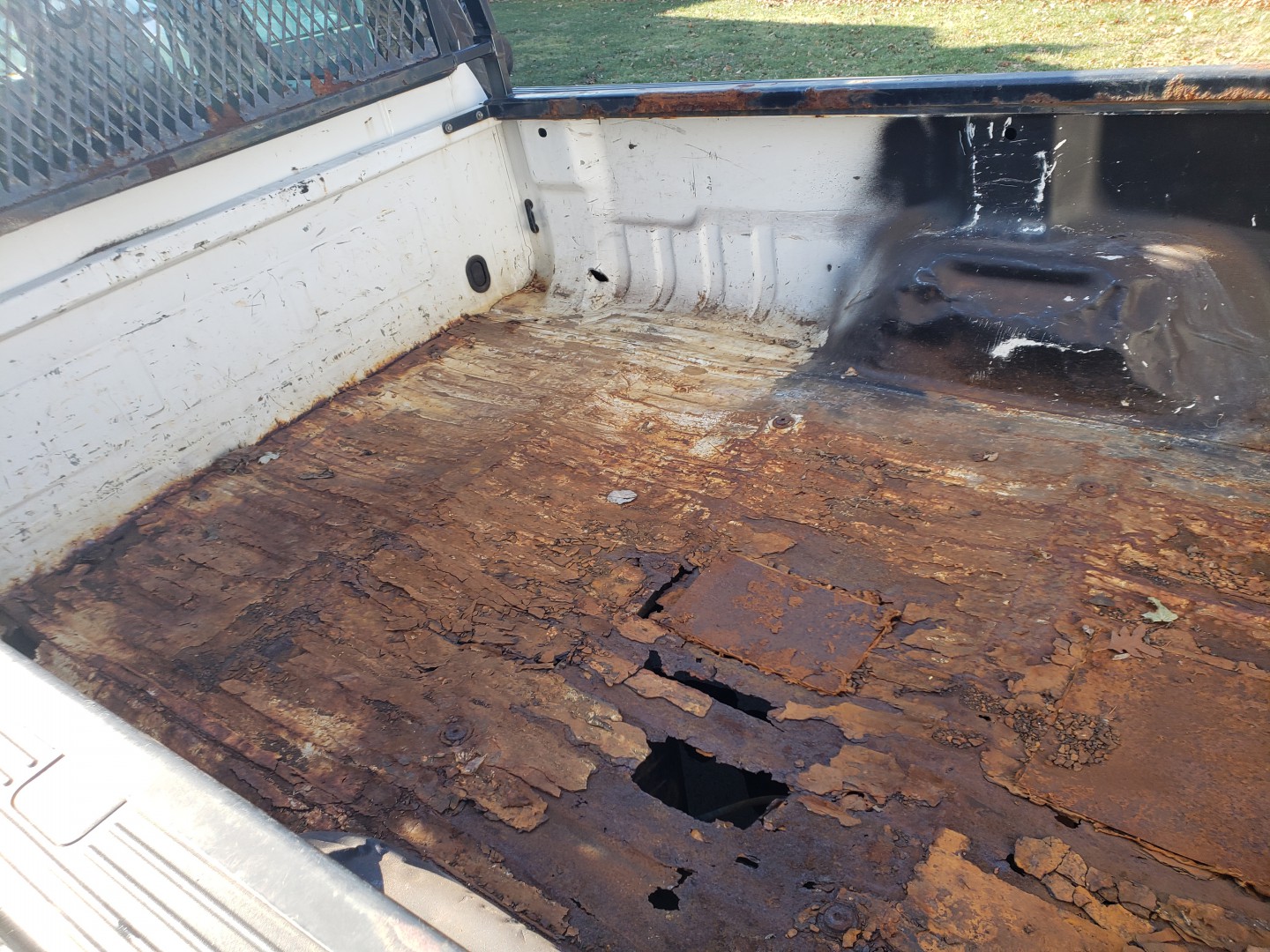

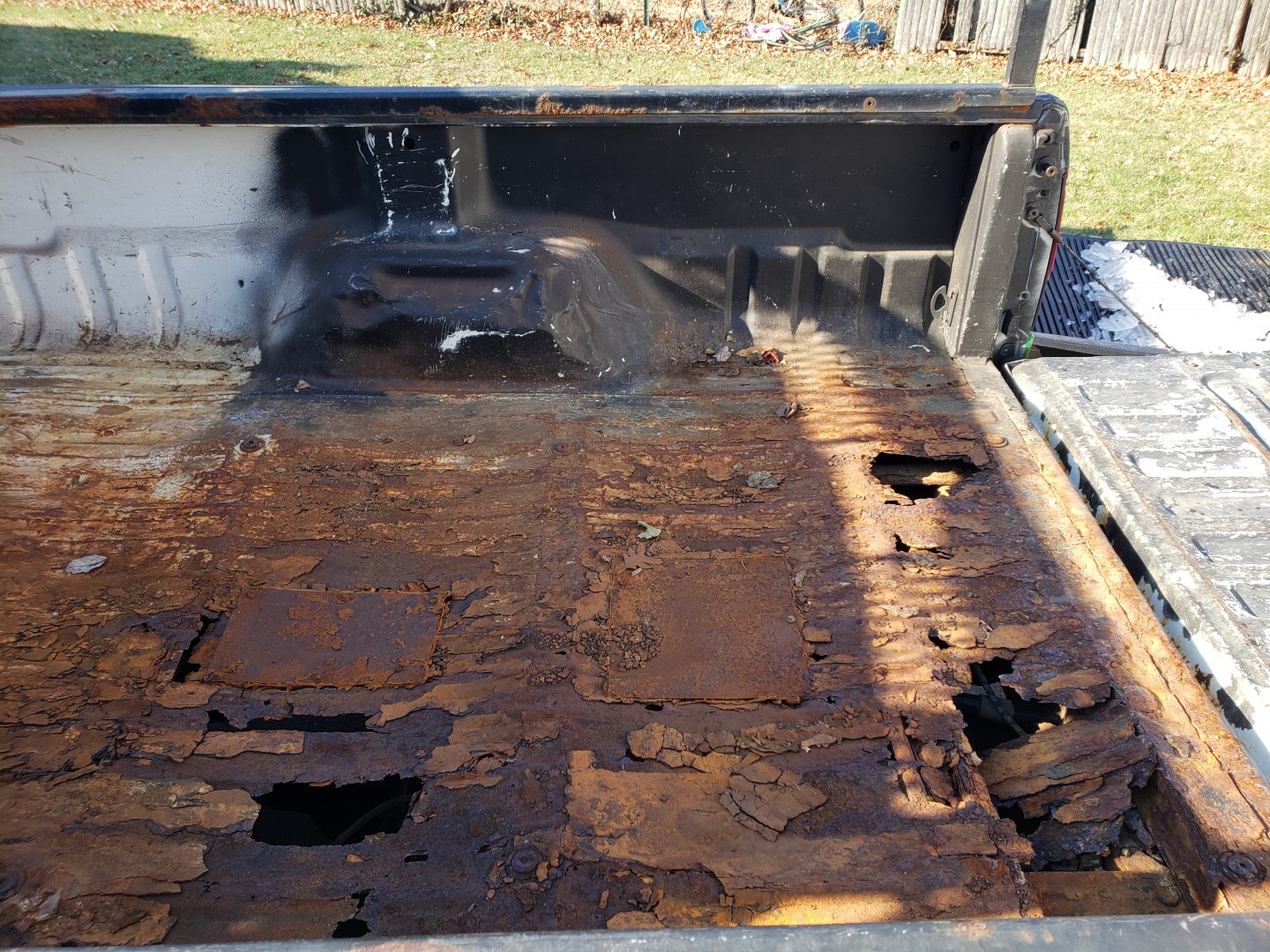

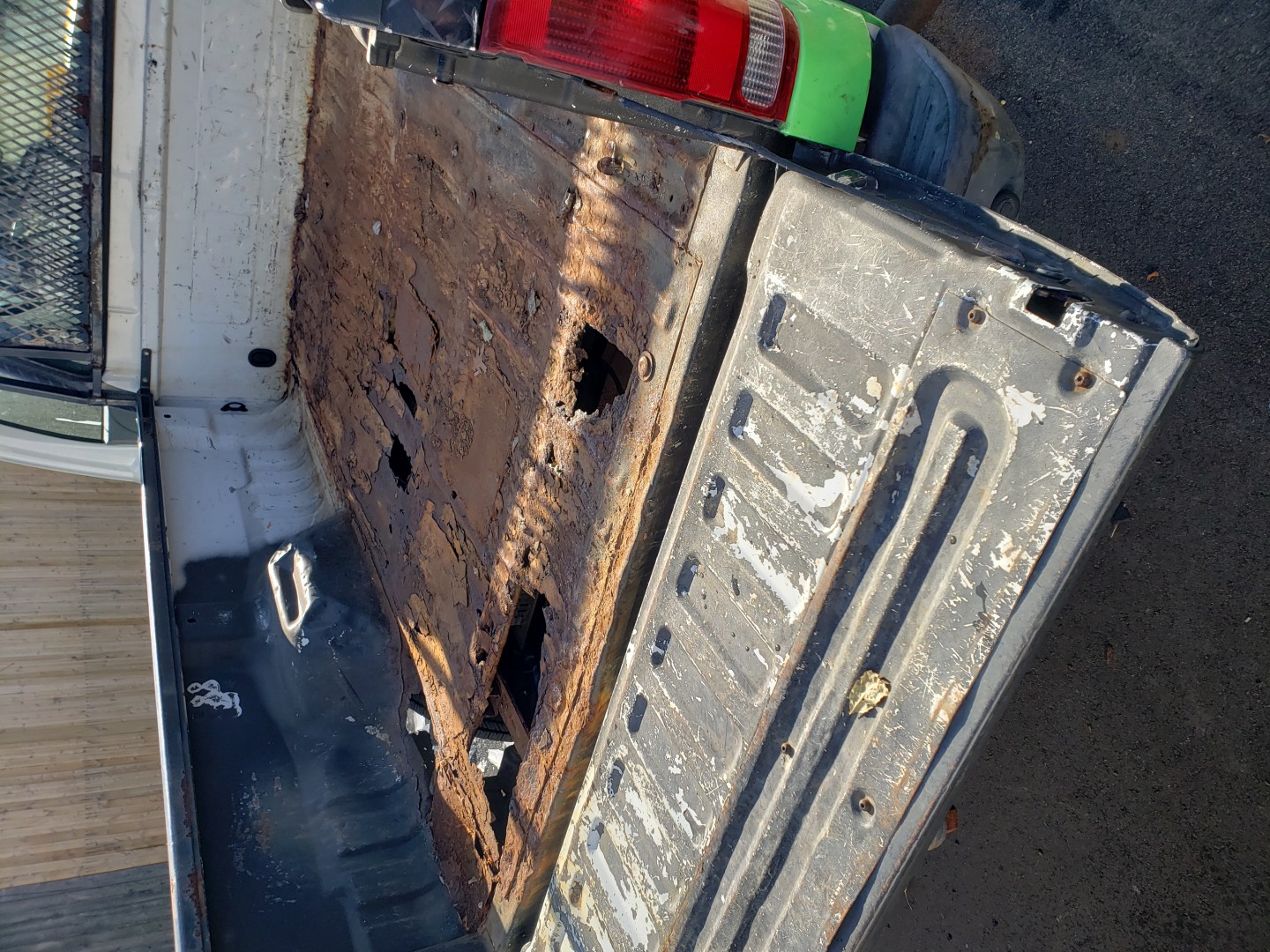

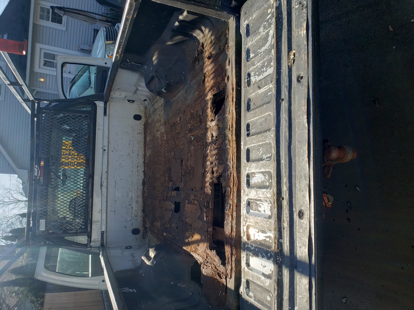

I would go over your frame carefully and even check out the entire rear end. Some repairs and reinforcement might be in order.
Dec 22, 2019
Yeah Brett im expecting some extra work will be needed. From what I can see it appears to be mostly surface rust on the frame but i will be looking at brake lines/fittings and everything else. Thanks
Dec 23, 2019
Break lines... damn good idea! I hope it's not too bad once you get the bed off.
Dec 23, 2019
Dang, looking at yours makes me feel like I could of gotten another couple years out one I just sold....
Dec 27, 2019

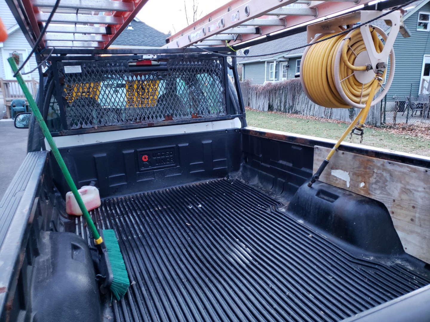

Yeah the old bed went to crap fast under the bed liner. It was bad before but not like that.

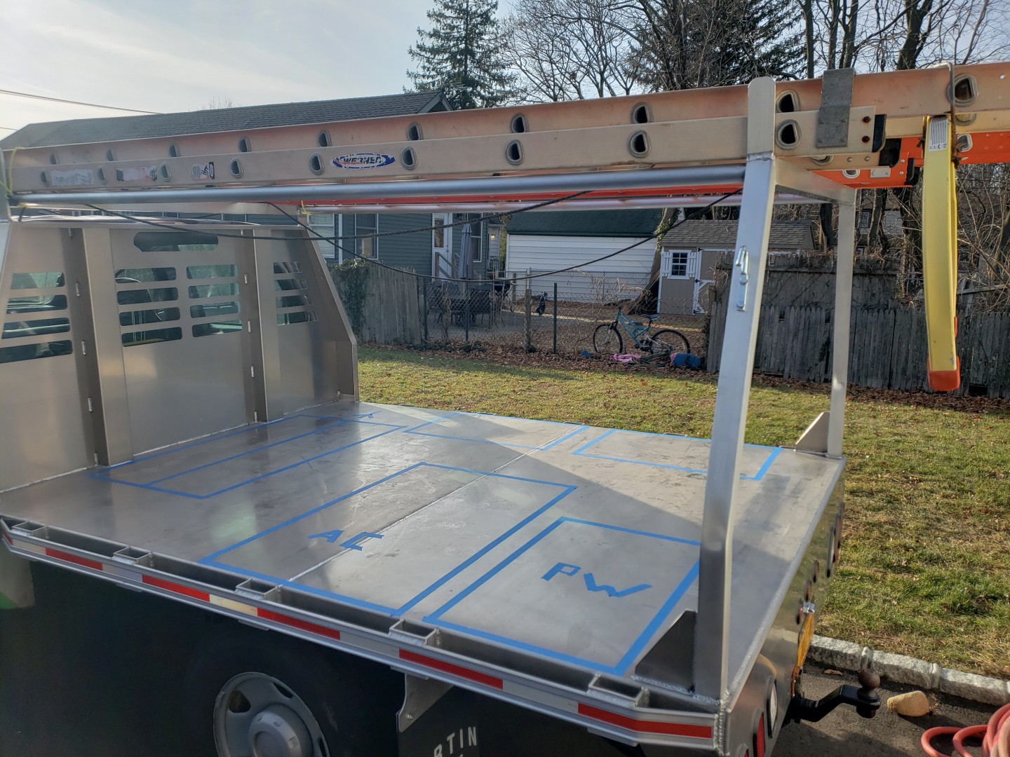

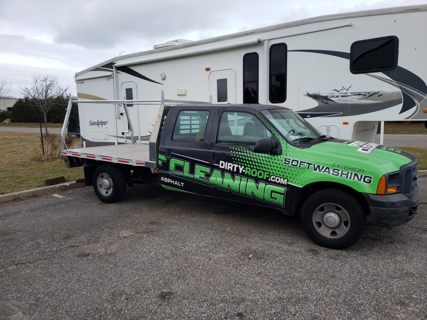

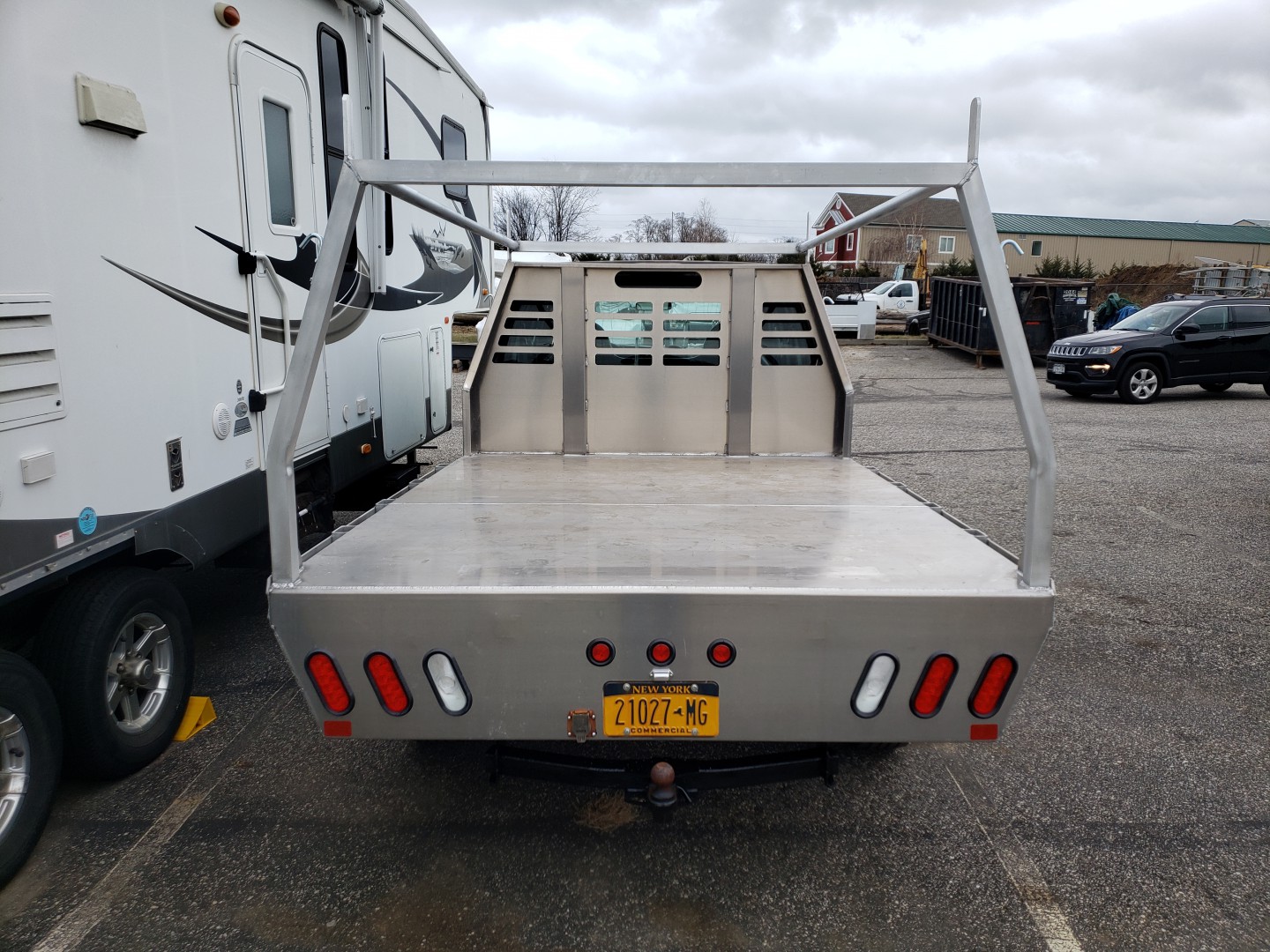

Just picked up the truck today. Pretty happy with how it looks and the service was great.
Now I have to start laying it out so can get this thing built.

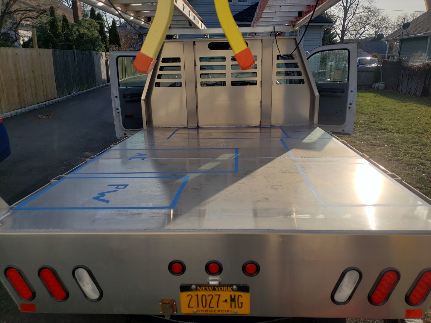

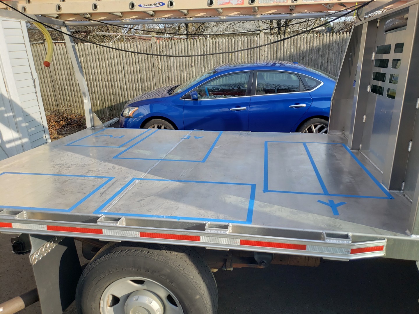

Did a quick layout for the equipment. Would love some feedback, advice or suggestions.
2 100 gal tanks pushed up against headache rack
(4) stackable hannay E1526-17-18 passenger side
Mixing valve- pass. side next to tank
PW - Driver side back corner
Compressor (if I go air) driv side.
I'm thinking batteries in box under bed.
Air or 12 volt pump should fit anywhere.
Trying to leave middle somewhat open for access from back of bed.

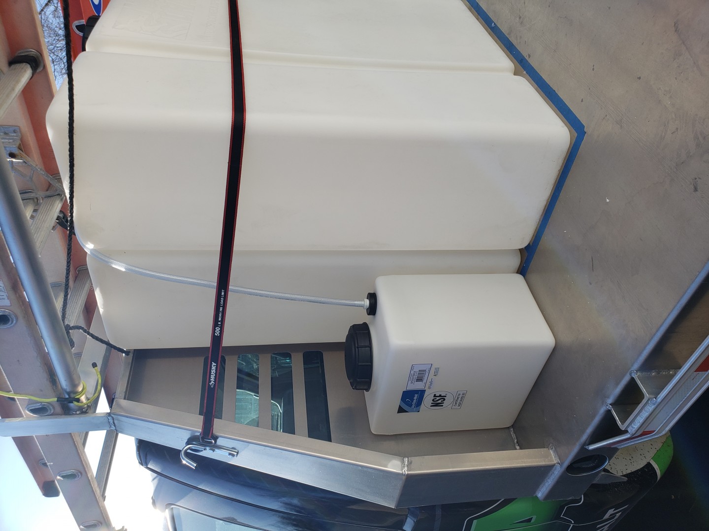

Most stuff is ordered just waiting on delivery. Soap tank came in
Erik on the bottom of that tank you will see 4 indented holes. Melt some clear Zip ties into the holes or if you have tank plastic use that. After a year mine started leaking. Do the preventive maintenance so it doesn't happen to you
Hmmm..every one of mine have leaked after a few months....figured it was just the bleach
Jan 6, 2020
This soap tank has threaded inserts in the bottom. Probably the cause for the leaking. Lil annoyed to hear this def won't bolt it down.
As far as the truck suspension goes I've actually been dropping weight. the old steel bed and steel ladder rack was much heavier than the aluminum replacement. I dont know the numbers but the truck is so light in the back that it drives like crap on our terrible roads.
I've also gone from 2 135 gallon tanks to 2 100 gallon tanks.
Im guessing it will be more weight but dont think it will be too significant. If it does I can address it with air bags or add a leaf spring to it.

Brett that's a 7 gallon tank I will be using for soap. I will NOT be using the threads on the bottom in case I need to shuffle some stuff around.

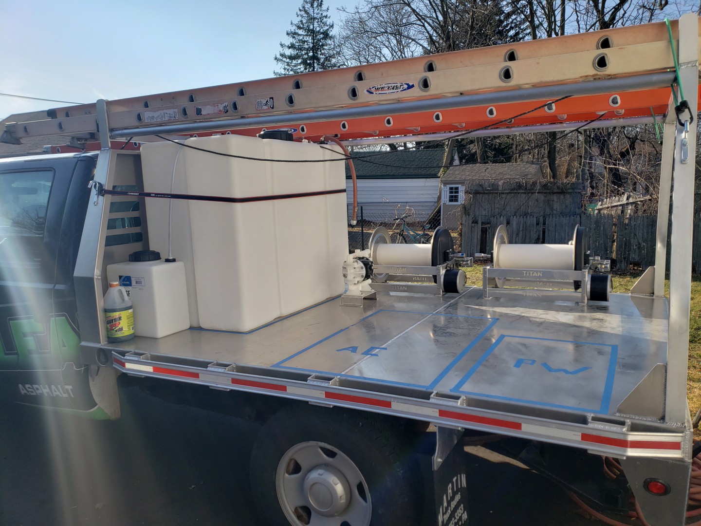

Got the truck back, had a sensor replaced in the transmission. Had them do a once over so hopefully no issues through the working season.🤞

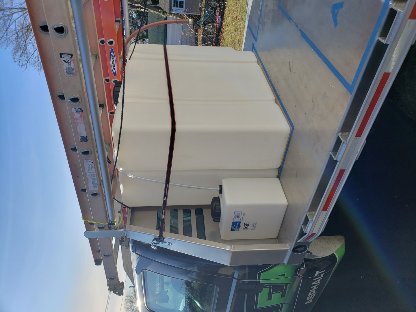

Tanks came in from PWS. Fit better then expected. Lil tip- Go by the manufacturer or suppliers measurements not measurements from others in the field. apparently some people have tape measures that are diff then the rest of us.

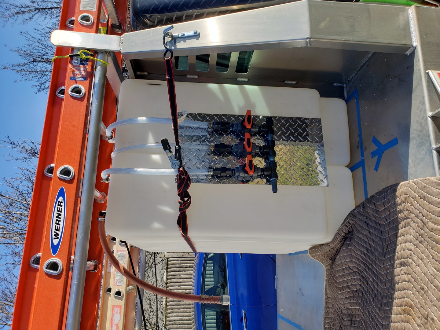

I was able to plumb the chem tank, water tank and soap tank to the mixing valve. I also got the float valve installed. I only have to cut in bulkhead for the pressure washer supply line and then I'm done with tanks.
I have room to add a 2nd soap tank to the other if I decide to carry 2 diff soaps. Should be able to use 1 feed line if I add ball valves 2 each tank. Similar to what brett has in that video.

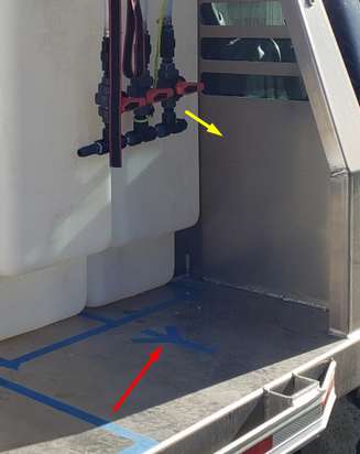

I'm playing with ways to support the mixing valve. And I'll be honest....I might very well silicone that piece of diamond plate to the side of the tank. Trying to minimize amount of holes and welding that will need to be done.
Things like the tie down strap holding the tanks and the small length of hose coming off the float valve are not staying. They are just there as I'm building. I will have some welding fabrication to do at the end, just want to get everything situated first.

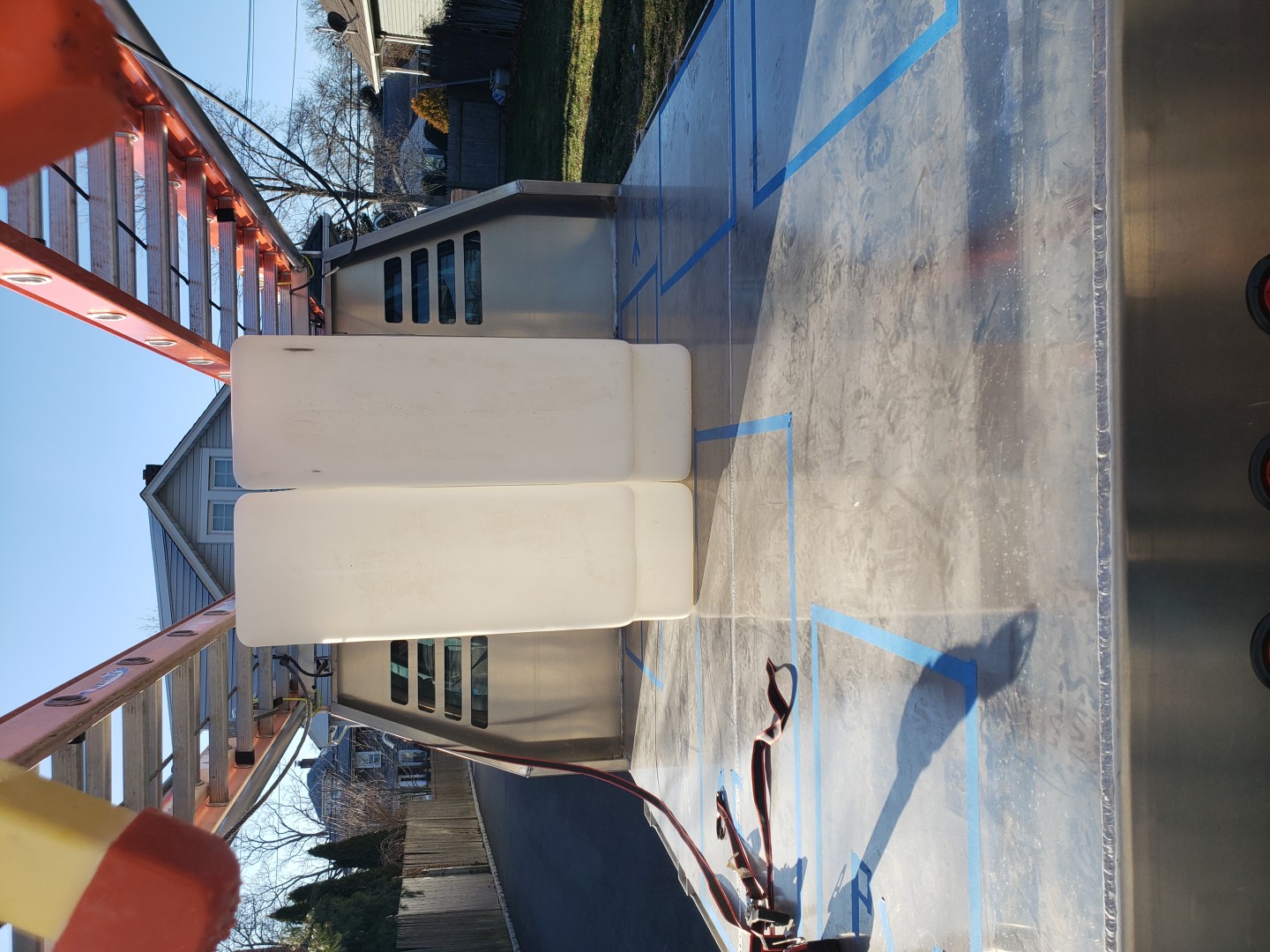

As you see in the pic I thought about having the tanks run down the middle of the truck. I actually really liked this idea and was having a hard time deciding which way to go. I had to make a decision and thought up against the headache rack would be best.
Still trying to order the hose reels. Now I'm finding out that one of the hose reels I need is out of stock at most places and it would have to shop freight when it comes in which would make that a $1050 hose reel when you include the shipping.
"I might very well silicone that piece of diamond plate to the side of the tank."
First of all, silicone is junk! I just hate the stuff for most applications! You will never get silicone to stick on plastic. See the picture attached. I have no clue what you will put where the red arrow is but if you have room, have the aluminum diamond plate bent 90 degrees and mount it on the wall with SS bolts where the yellow arrow is. Secure is the best way to go.
I have found mobile home strapping to work well and can be pulled down pretty tight, bolted with SS screws. Paint it with galvanized paint first. PWS has SS straps if you want to go that way. I'm not real crazy about ratchet straps. If that's the way you have to go then keep the ratchet lubed all season and check them often.
Heres the deal with silicone (I know its hack but) it generally holds very well and if I change my mind or it comes off there is no permanent damage or holes drilled. 20 years of construction learned w a little surface prep it will stick to almost anything.
I did not think about putting it were the yellow arrow is. I really like that idea and am going to put some thought into it. Ot would be secure, protected and easy to access.

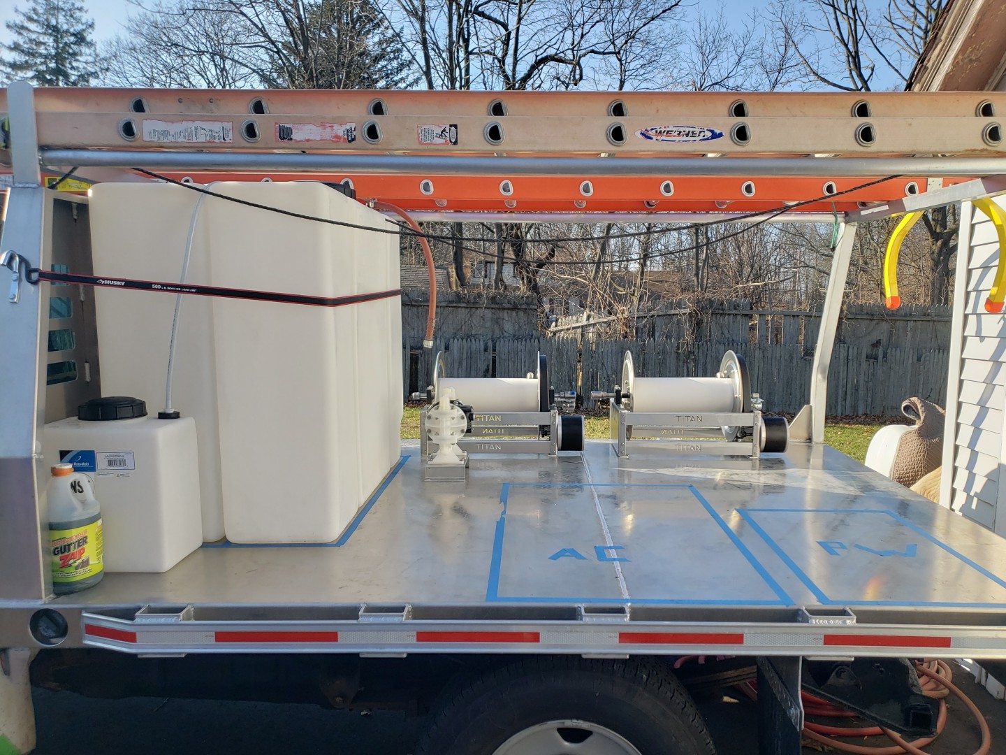

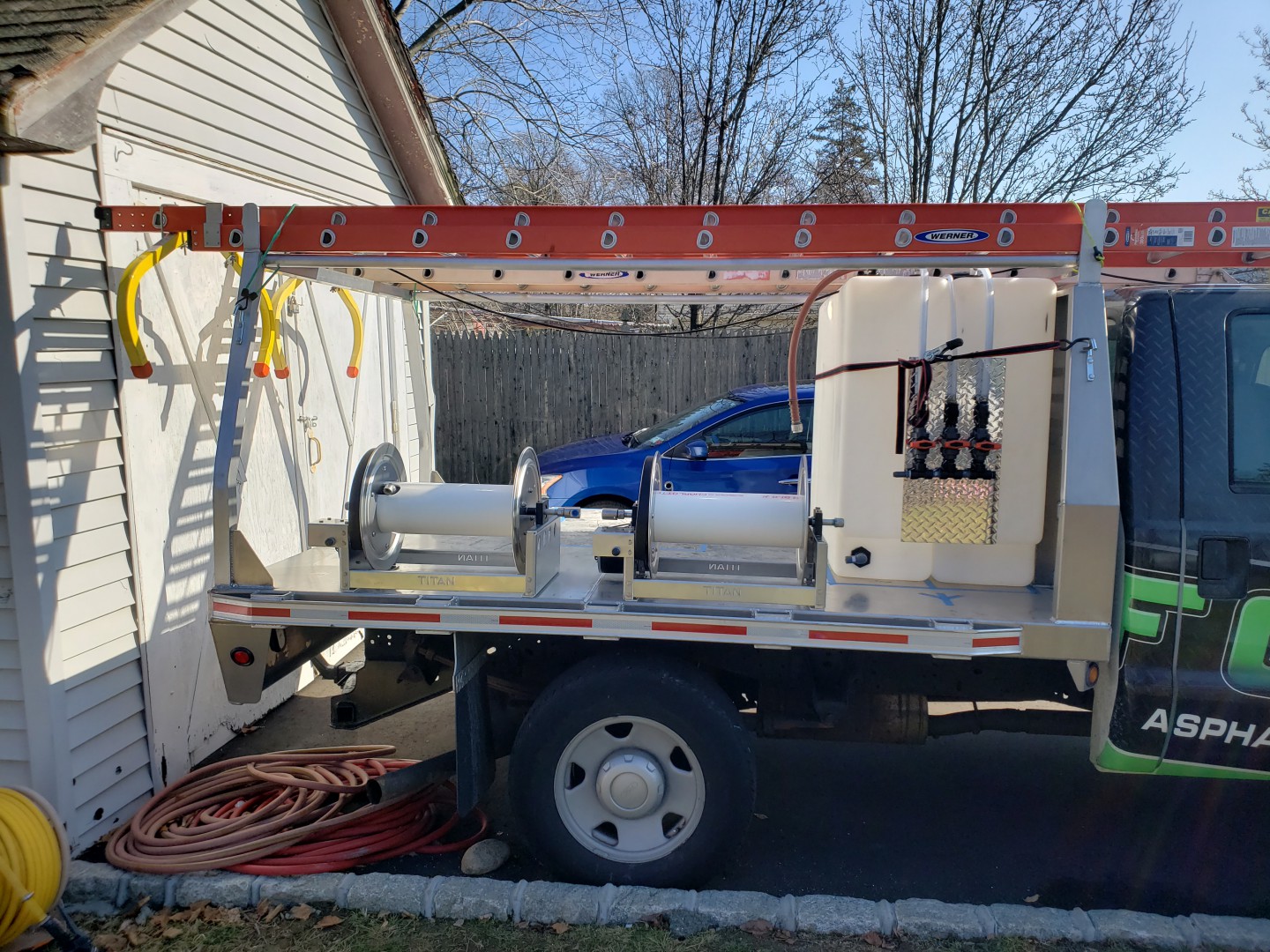

Lil update parts and equipment starting to arrive.
Still need 1 hose reel that's back ordered. It will.get stacked on the other reel closest to the tank.
Was going to mount the all flo and pressure washer but it's to heavy to get the pw out of the basement solo.
Looking nice and clean! Couple things,..regarding the PW setup. It may be too late to influence your reel choice for the high pressure hose. Unless it's the reel you're waiting on? But, an electric hose reel makes a tremendous difference,...HP hose is heavy and a bear to manually wind. Especially at 200',... And depending on your GPM and intended use,..a buffer tank can be vital. Again,..maybe you've thought of that already,..just pointing it out.
Consider anything I,. or anyone says as constructive criticism,..
Jan 16, 2020
Jeff, all 3 are electric rewind. I'm waiting on the hose reel for garden hose/water supply it has a 1" pipe
Should be able to see it in the pics but there is 2 100gal tanks. 1 is for SH - 1 is for buffer.
This morning I'm playing w placement of PW and compressor. I have more room then I thought but want to get this situated best i can.
Ratchet strap is TEMPORARY.
Here is where we are at so far
