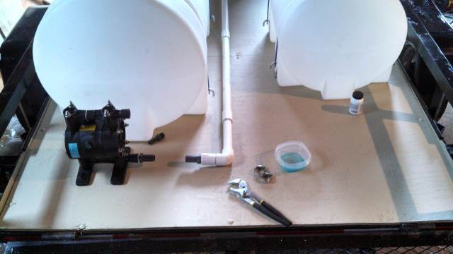

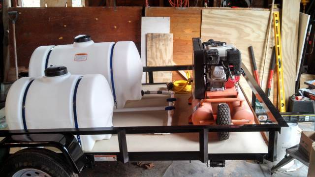

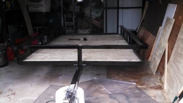

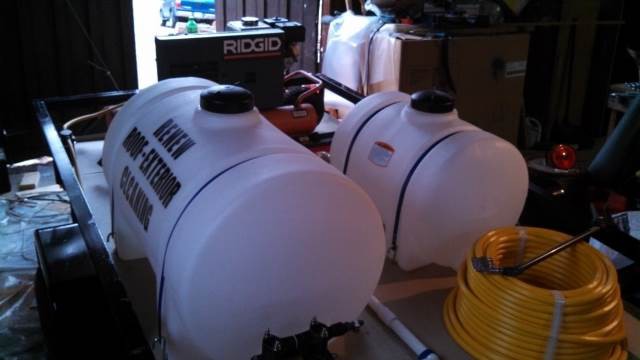

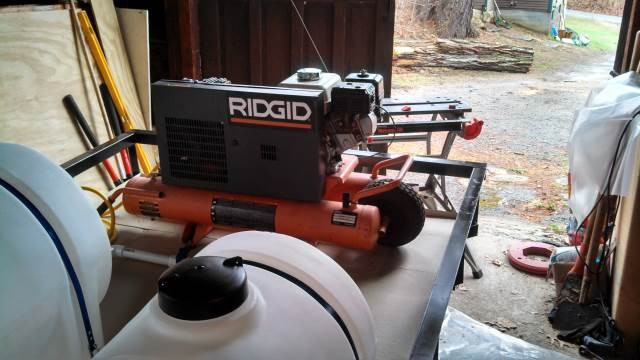

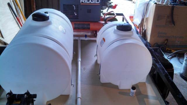

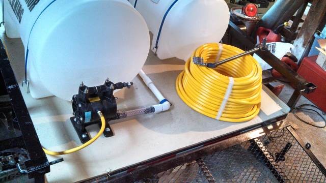

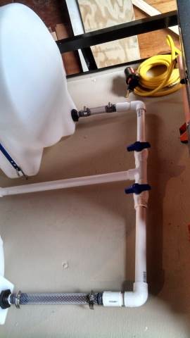

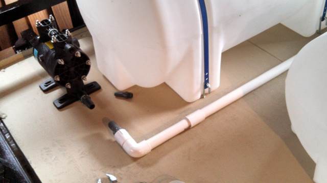

Hi all, here is some pics of my 1st build. It isn't quite done yet but Im having a ton of fun building and creating. The inlet hose & PVC are 1" so I can upgrade from 1/2" spray hose to 5/8 or 3/4.
Looks good. You will need a back up pump. Where did you get the Yamada?
Apr 30, 2014
Ebay, 300 bucks NDP 15 FVT. Yeah I will probably pick up a Versa Matic

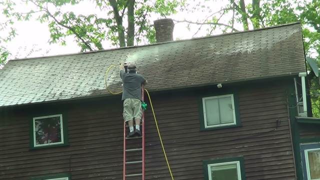

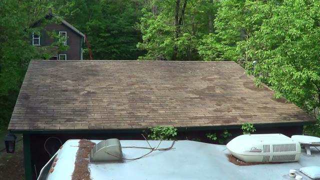

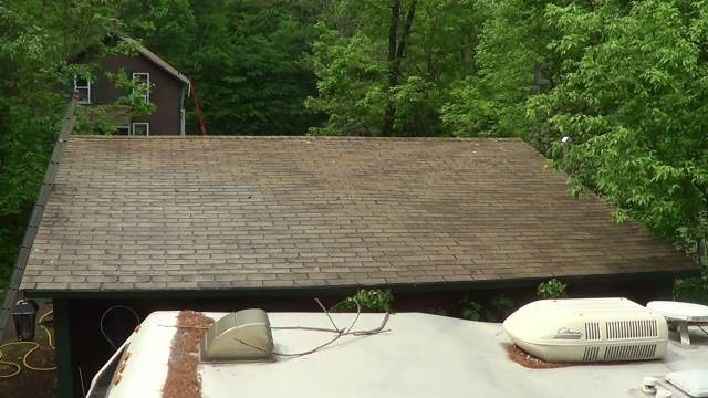

After some trial and error with the compressor I was finally able to do some cleaning. Here are my first two roofs. These are our house and garage before during and afters
Congratulations. It looks as if you're on your way. If you haven't done so already when the opportunity presents itself get yourself some standoffs for those ladders. You can pick up some Werner quick units at Home depot or Lowers for $42.00 each. They make life easier, safer and reduces(eliminates) the strain on gutters.
May 27, 2014
Thanks Waxman. I do have some stand offs just didnt have them at the house. I also need to get levelers.

I rinsed the pump out really well, I used it to rinse both roofs. I only have a 35 gallon rinse tank and I am thinking of installing a cistern filling valve to keep it full during rinsing. I ran out of water twice rinsing the roofs. I only used about 20 gallons of mix on both roofs to clean.
May 28, 2014
Gene,
Perhaps it's just me...but why are you rinsing the roofs?
May 28, 2014
Because 90% of the roofs here in NH dont have gutters and Ive seen RCIA what not rinsing a roof without gutters will do. The roofs with gutters I wont be rinsing. I can rinse the bottom 3rd or half and be fairly safe but I want to sleep at night. I rinsed my roofs and didnt kill a thing and I feel more comfortable with that. As I progress with experiance I might do otherwise.
May 28, 2014
