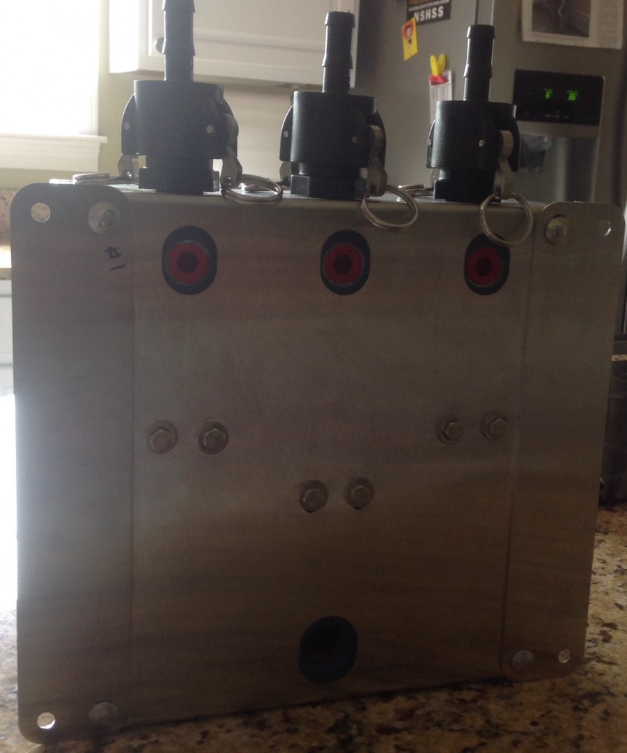

Looks cool so you can hook straight to a drum of sh and your soap and say roof snot and blend all together for the freshest mix? The knobs on the inside are they dials to regulate the amount of Chems?

3 inlets go to water, sh and soap. Outlet goes to pump, off you go!

Tim, is there a mixing chamber or anything that causes mixing?

The lower manifold is very specifically milled, that's really all I should say. This unit is not just a box and a few valves. Years of testing has led to this point, I washed all day today with this system. I have 2 tomorrow... Paul can help anyone with questions At www.powerwashstore.com . There are a few more unique systems to be developed in the near future. This is a very exciting time for the industry.

Does this system work with a 12v pump.
As i see your using an air diagram pump.

So this?
The ProPortioner is a metering system which utilizes three highly engineered chemical resistant metering valves fed into a milled mixing chamber to ensure proper mixing prior to entering the spray hose. Each metering valve has a dial indicator which allows the user to set the valve in the correct position for the desired mix ratio of each ingredient.
The ProPortioner eliminates the need for batch mixing and allows the user to switch between a roof mix and house mix by simply adjusting the metering valves.
The Banjo fittings at the top are for water, SH and soap.......why not just have a water hose connector for the water valve?

The water and SH need to enter the system equally. The air pump was used to demo the unit just to show it can be used with multiple pumps. I use a 12v and a 110v booster pump on my truck. We are working on a way to use the proportioner with the Udor and Comet pump. The issue with those diaphragm pumps with unloaders is that they have to bypass back to a tank. There is no tank (mix tank) in this sytstem to bypass to.

So no water hose connection because there needs to be a water tank the system draws from?

Yes. Garden hose feed would push water in creating and unbalanced mix ratio. At least that's what I'm gathering. I would imagine you would just need 2 tanks ( 1 sh and 1 water) and a 5 gallon bucket for soap.

How do we know what our mix ratios are are? We all use different pumps, hose size and nozzles. Do we need to tweak it ourselves?

Brett, yes there's a little individual tweaking going on. When the labels are installed you'll see 10% 20% 30% etc. depending on the length of run of hose , diameter of hose, level of chemical, all of these factors will slightly change the mix ratio. After using it one or two times you'll find your perfect butter zone for your system.
You'll be able to run a rig with two tanks either 50s , hundreds or larger, if desired. I look at it as a massive timesaver. When doing three houses per crew a day, with two crews, I figure I'm losing about 2 to 3 hours per day just waiting for a mixed to be made. From where I stand this is a no brain For my business model.

Hey guys, paul and I are finalizing everything to go on his website. For the system to operate you will need a water tank, bleach tank and a soap source... Pulling out of 1gal jugs or 5's will work.I use 2 16gal mounted tanks for soap. Water and bleach tanks will be plumbed from the top with equal length 1/2" lines. The soap supply can use 1/2", 3/8" or even 1/4" as it is just a drip in the system. All pickups must be filtered to control debris intake. The system will vary slightly from user to user, but it is not a issue. The dial that is on valves goes by degrees 0-180.
The following degrees indicate percentages for SH valve are as follows:
50 = 10% 80 = 20% 110 = 30% 140 = 40% 180 = 50%
The soap valve will start to flow soap at the following degrees.
35-40
The soaps viscosity effects the draw so open to 35-40 and adjust as desired.
The water valve will stay wide open at 180 degrees. The only time you want to adjust the water is when you want to go above 50%. We seldom go over 50%, but if you need to, use SH settings in reverse.
140 = 60% 110 = 70%.....
I hope this helps everyone understand the system a little better. These percentages are based on 10.5% SH. Across the country SH percentages and quality vary so it is very tough to make exact mixes from area to area, but this system is incredibly repeatable. Find your perfect spots and mark it for your system.
This complete system is not cheap to manufacture as it contains only the highest quality components. This will however reduce your set up times tremendously from surface to surface.

And, no sorry I haven't calibrated it for 12.5 as we don't get much around her. It can easily be adjusted I'm sure using 10.5 marks.

Tim, you could make the dial indicators for the mixing valves a separate, removable circular sticker. That way, you could rotate them according to a 12.5% or a 10.5 etc. type mix.

Tim I see the system uses 1/2 hose. Can it be calibrated to use 3/4 hose. Our skid is all 3/4.

Guys, the system is designed for 1/2" intakes. There may be a volume/priming issue drawing 2 3/4" lines into the system that can put a unnecessary strain on some pumps. . I recommend 1/2" lines in, the output threads are 3/4" to the pump. 1/2" can be used to the pump if your pump intake is 1/2", just use a 3/4" to 1/2" reducer bushing or applicable fittings. Remember we are working off suction so all fittings, hoses, etc.. need to be air tight.
