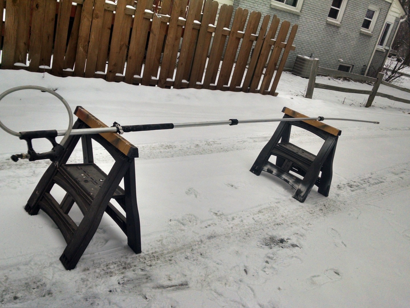

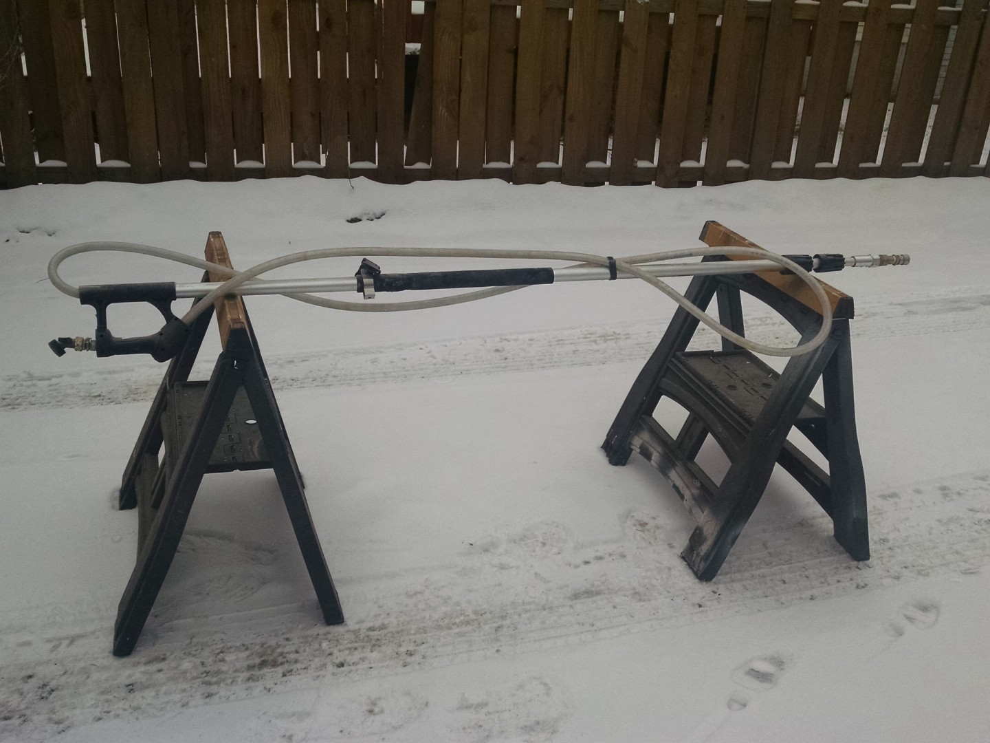

Here is one of the wands I have. It is extendable. I had the end of it custom machined to accept the hose running inside and be able to thread a quick connect on the end to be able to change nozzles.

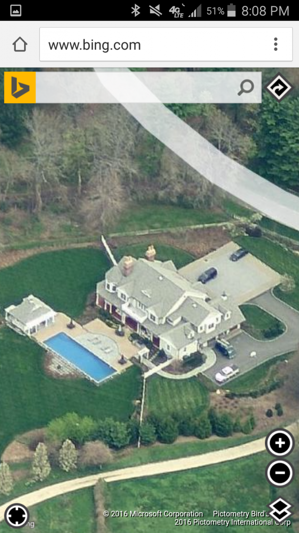

It is, but I did an annual customers huge house with lots of hard to get to areas1 helper in 3 hrs from the ground. (House washing only)
In previous years it took 4 guys a day and a half to do off ladders because no one likes to use it. But do the math
6 man hrs vs 48
Labor cost 8x more efficient
