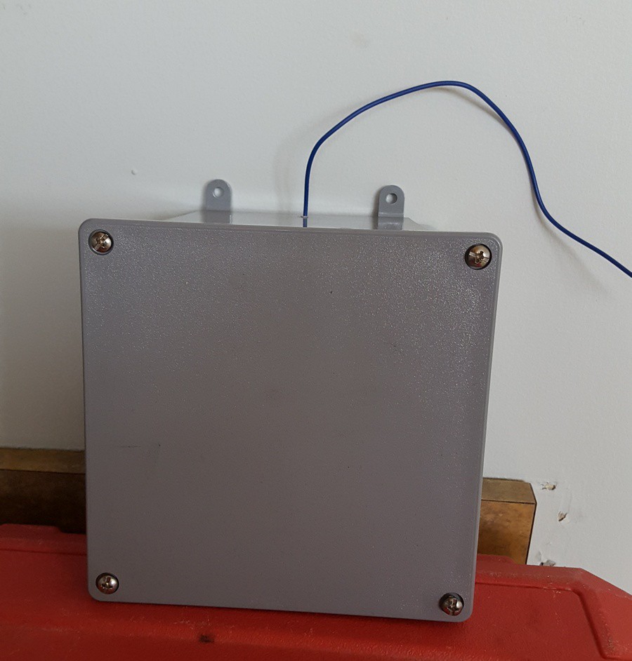

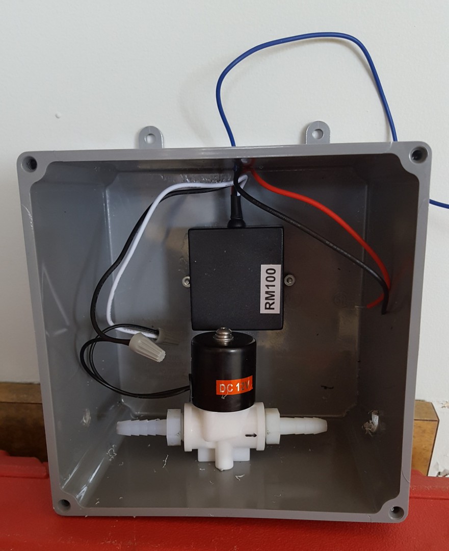

I built the remote today in a 6 x 6 waterproof plastic electric box. I used wire nuts to make it easier to change the switch. I'll hook it up this weekend and see how it goes.

Hey Brett,..that looks good.... These things are so simple to build and provide a HUGE benefit to anyone who DS. There are also so many remotes and solenoids to choose from that are cheap. No reason anyone who wants one can't have one. And,..considering the cost, the solenoids are easy to keep on hand and ready to replace. Glad to see others putting effort towards this idea and trying other products,..like Art using the stainless and someone else using brass,..along with different plunger materials.
