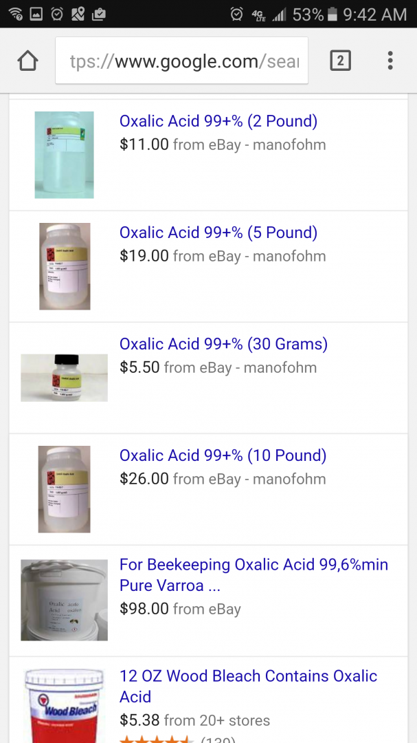

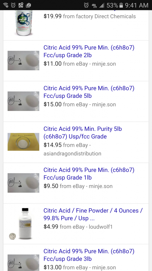

On raw wood I prefer DS'ed hydroxide or Sodium Percarbonate through dedicated pump. And neutralize with oxalic. Usually through dedicated pump,..but sometimes can get away with DS'ing it.
Maverick,.did you ever use just citric for brightening?
Dec 20, 2016
Hydroxide is more of a HD degreaser and removes old stain and paint.
Yes Jeff. Works as good as oxalic acid. OX basically derived from vegetables and citric from citrus fruits. Both cheap if purchased in pure form. buy dry
I have been Ds'ing NAOH onto gray decks for the last several years. Learned it from Ken Fenner. Ds'ing is a very fast method of applying detergent to a graying deck. The percentage is very low, and not a degreaser level. Like .5% or something,..depends what you start with,..but I usually do 8 o. per gallon,..then DS. It works just the same as Sodium Percarbonate applied straight. Most guys who DS a gray deck with NAOH rarely go back to percarb,.Just so much faster and easier to mix up.
Dec 20, 2016

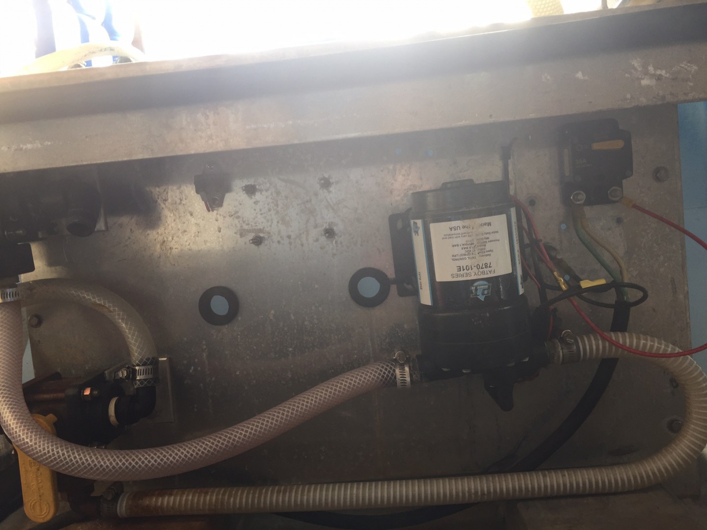

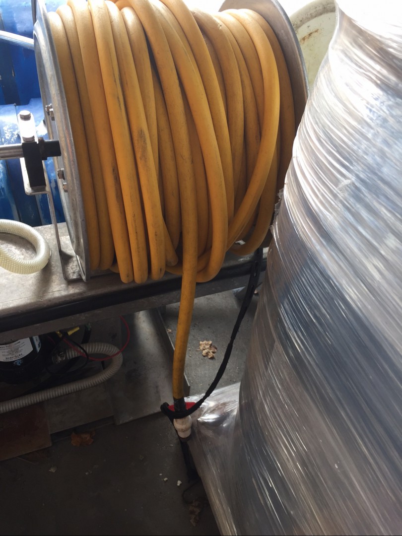

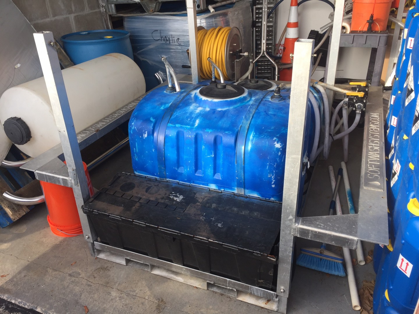

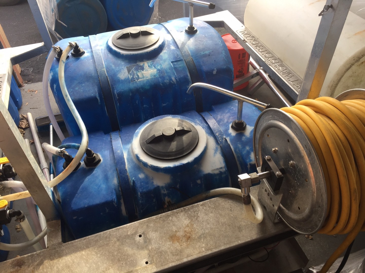

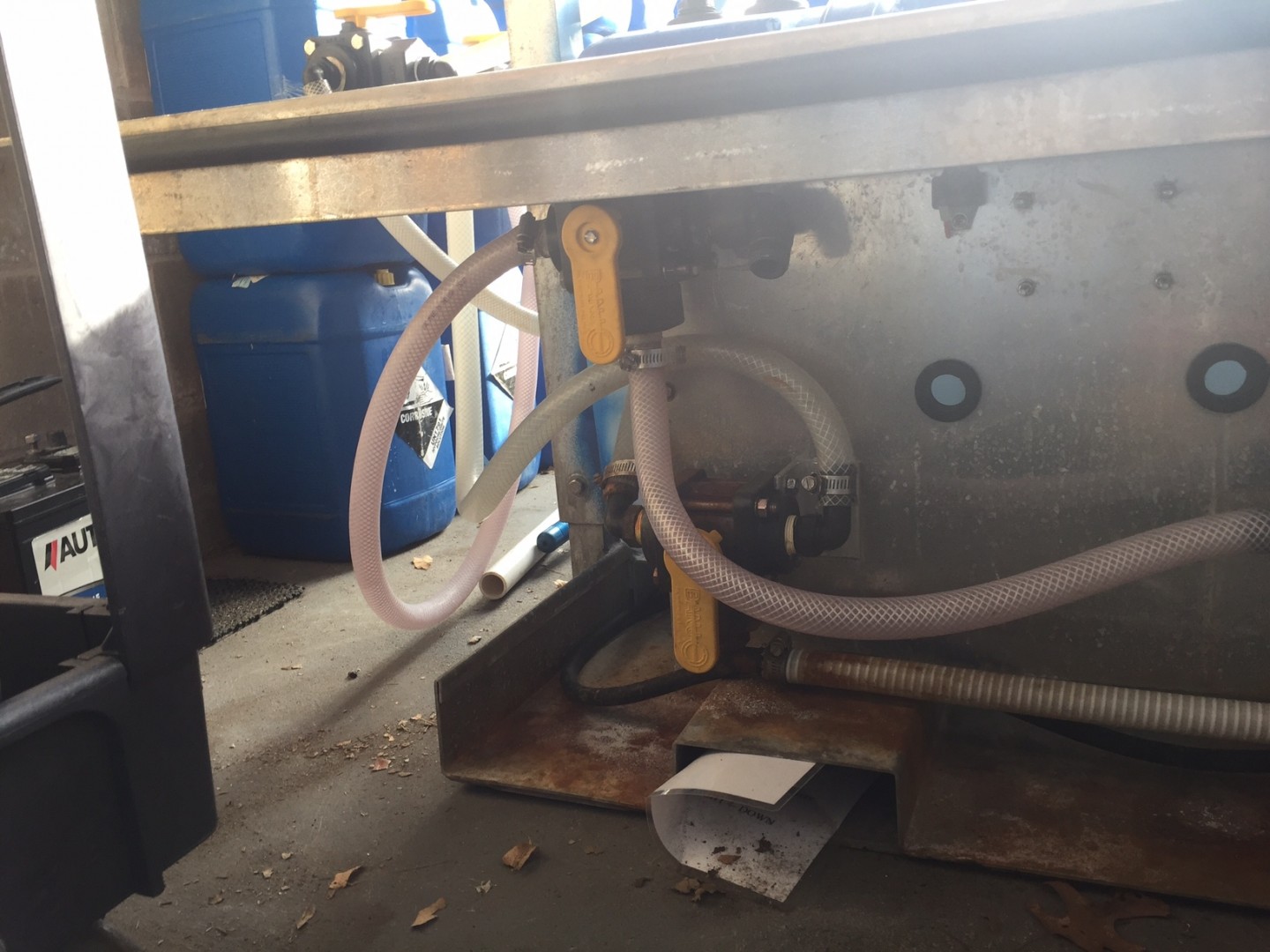

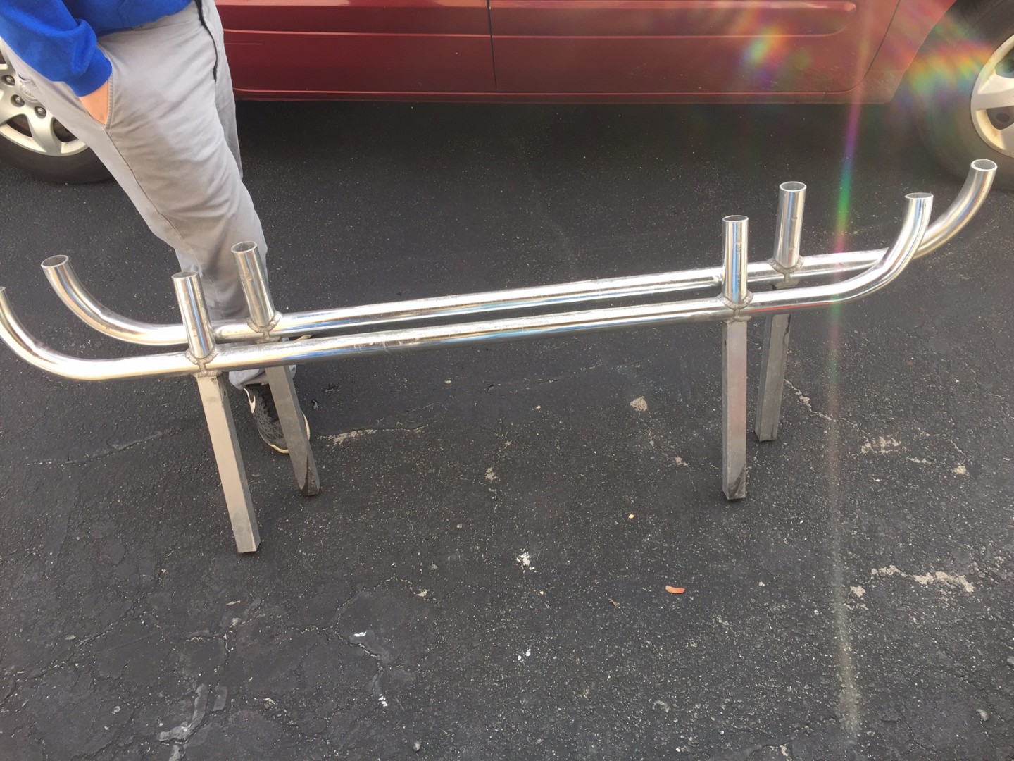

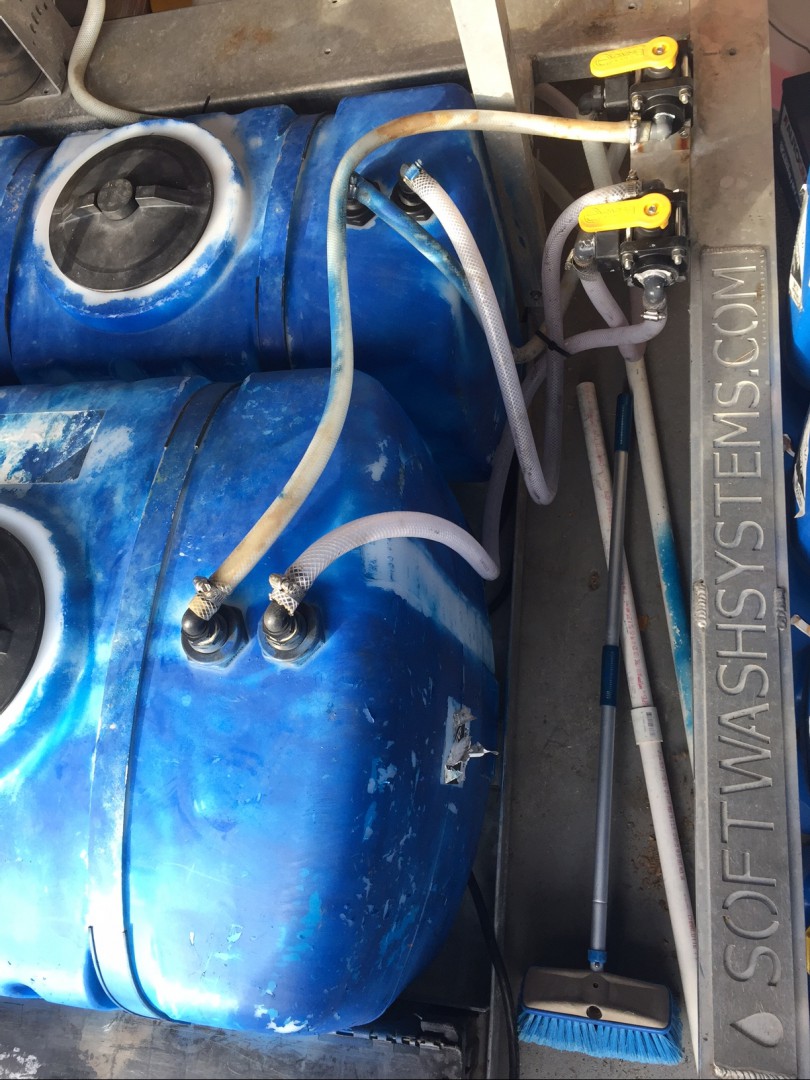

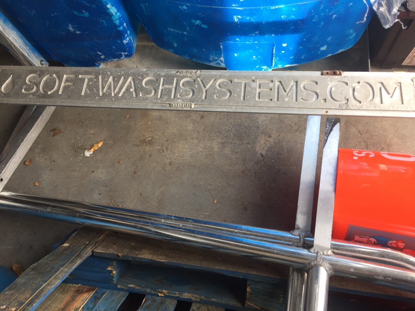

Patrick G wrote:
I have a used soft wash skid for a six foot bed. Come on down to NY you can have it for $2300
Pat, send me some photos, I'll come get it if it's what I'm looking for 252.314.8284
Dec 31, 2016
Ill send post photos today, but I have been looking around and it seems the skid is worth a good amount more then I thought. I have painted the tanks blue to protect the solution from the sun, this is that new paint that peels right off without a problem. I am still looking to get rid of it, I will probably be posting it some where for three grand. The photos may help you to get an idea what you are looking for...power wash store and Bob at pressure Tek have nice stuff you should look at.
