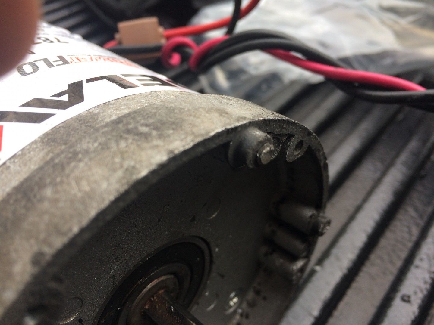

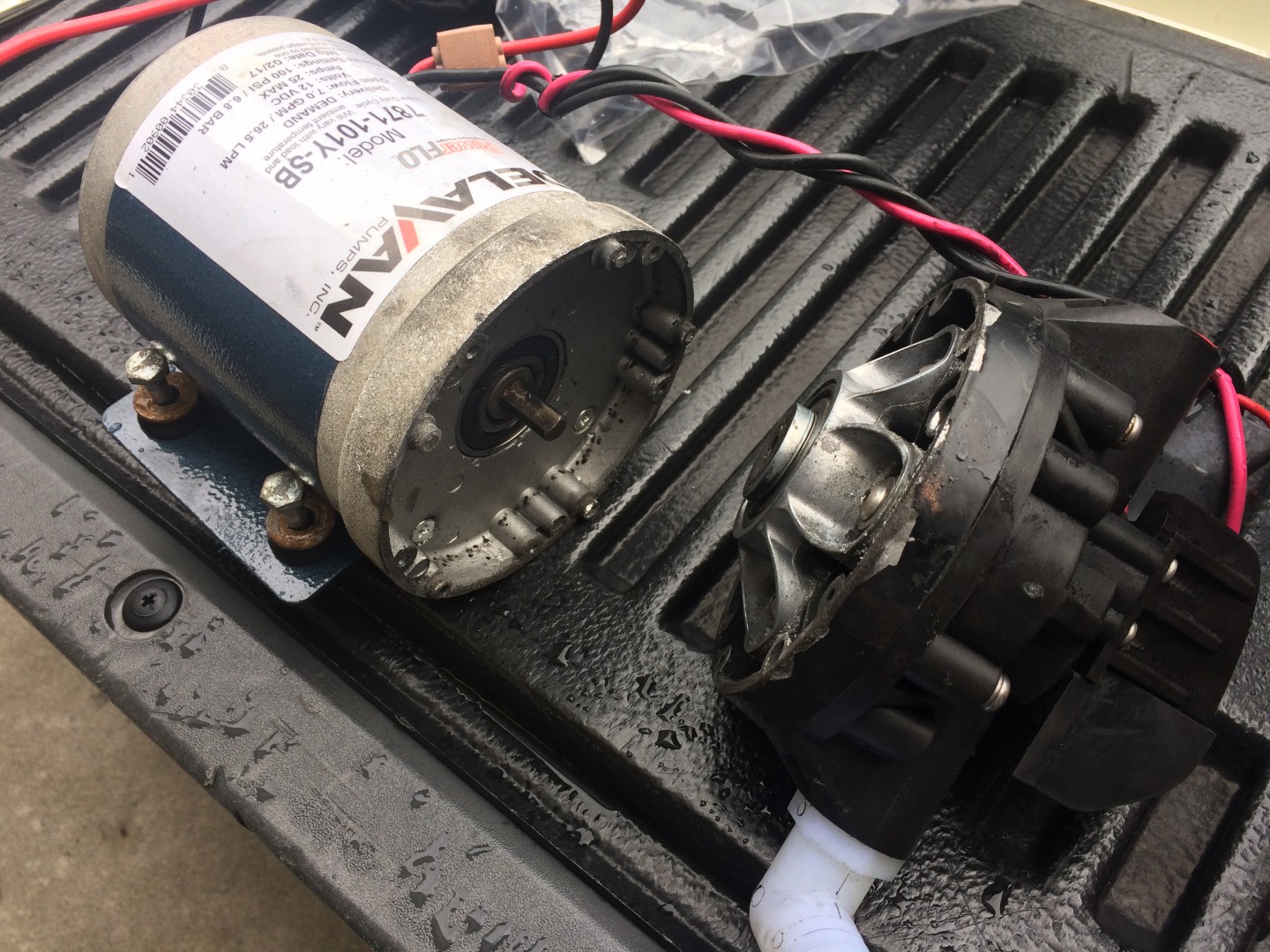

Here was the problem with the FB3. Bolts sheared through and the head fell off. I'm gonna try to exercise the 2 year warranty.
I've heard of the bolts backing out, but never shearing off like that. I would call Delavan and talk to them. They should replace it for you

Jun 15, 2017
I thought it was head screws when we spoke but as Art said, I've had them backing out but never break. PWMall put in a warranty request for me last year and told me to return the pump but if it had bleach in it they wouldn't replace it. As I was "repairing" the pump for return a new one showed up. I never returned it and was never asked to again.
Jun 15, 2017
I spoke to Delavan last year and he said Bleach was OK for the pumps. The bolts shearing off like that has nothing to do with Bleach. More like they are using cheap or defective bolts
Jun 15, 2017
Does Loctite and lock washers help this at all? I would think if the bolts would remain tight the effects of the vibration wouldn't be so bad? Is it possible to run a longer bolt all the way through and put a nut on it,..with Loctite and lock washers?
So how did you make out with the pump Bryan. Did they replace it?
