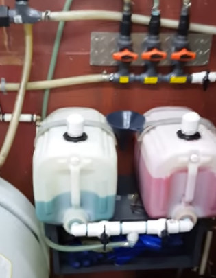

No problems at all with the mixing valves. If you look at it, I set it up so water can come in from one end to make rinsing easy and priming really easy. I've built two for about 600.00.

Been working on my Proportioner for my 10 GPM Booster pump that I will be ordering soon. Went with Schedule 80 and liking it. Makes for nice tight seams and its thicker, stronger and cheaper then the Bango fittings. Its going to work out good when its finished
I like that box a lot Art, did you build it?
Is that only just bolted together?
Is that box tight and strong or does it wobble any?
How are those valves holding up for you after this much time?

Everything works good, The box is very strong and the valves work fine

For those of you running a mixing valve.... How are you typically adjusting your valves? Do you leave water and soap valves in one position and primarily just adjust your SH valve as needed?
Is your soap valve generally set on low or almost closed side? Is your water generally set wide open?
I'm just trying to really understand this fully before I build one.
Mar 22, 2019
Water full on, S/h in the middle go from there. Soap I just changed over to one of those small Black and white valves. Not doing well with it, but haven't given up on it. The Gray check valves I like, but you should glue the valve together at the seam so it doesn't leak down the road. Had a few leaks and I think this is the fix.

I bought everything from US Plastics. Metering valves and have to stick with them since this is what the crews are use to. I wish I could go with cheaper ball valves. The check valves we have have never had a problem except for a small piece of trash and have never leaked in over two years. I set it up a bit differently with water coming in to the bottom of the Proportioner to help prim the pump and as well, cleaning. The trick to this set up is like everything else... rinse it all the time.
Water on full. Soap has two settings for the two different soaps for roofs and house wash. Same with the SH. I hope this helps.

You also need 1/2" hose of equal length, no more them 10'
Mar 24, 2019
Thanks Brett and Art that does help.
So it sounds like there is no need for 3 metering valves. Possibly only get one metering valve for SH and and 2 reg quality valves for soap and water.
Are you using 1/2 for soap as well? Drop sticks for everything or permanently piped to tanks?
Mar 24, 2019
I run 5/8" for water and SH, 3/8" for soap. Water and SH have drop tubes but the soap is a bit different so it's easy to switch.
