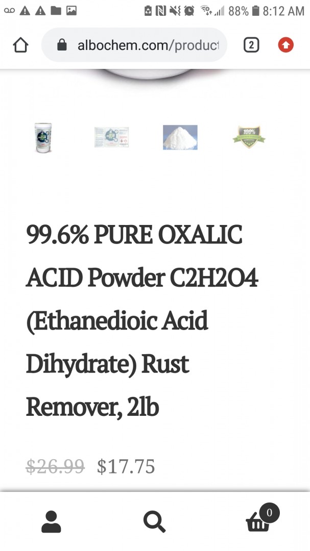

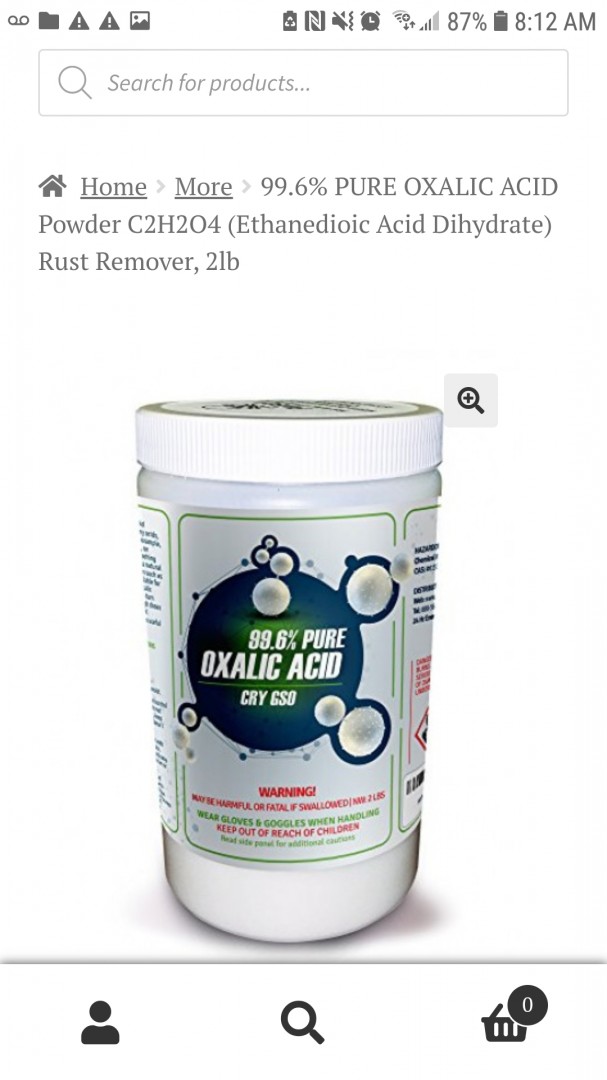

you can buy oxalic acid crystals at 99.6% and make your own wood brightener.
here's an example of a 2 pound container that you can make 40 gallons for $17.75 compared to store bought 1 gallon (5%) for $20!
40 gallons of store bought brightener would cost $800!
plus you can mix it stronger to remove rust.
