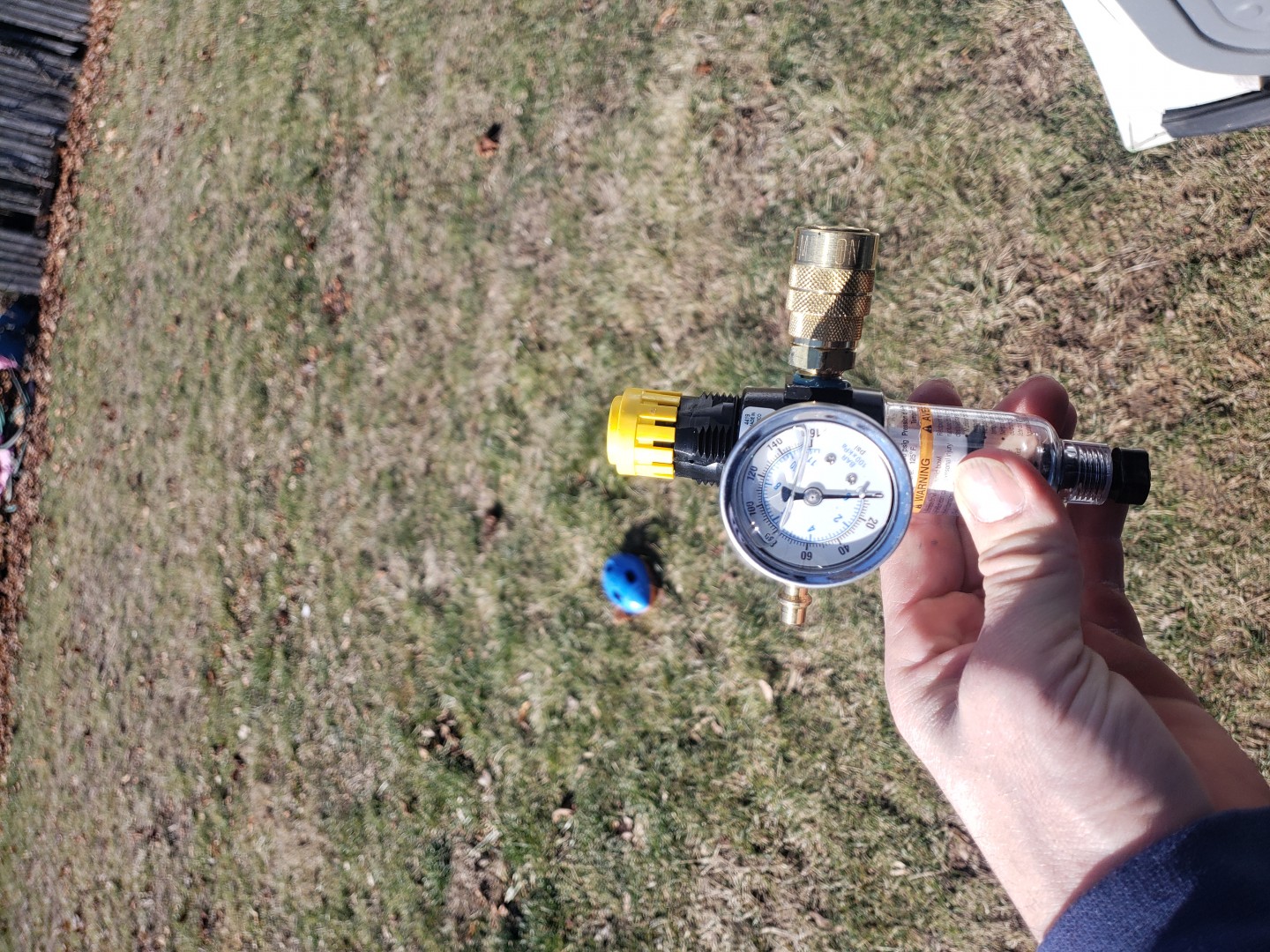

Ok so I need some feedback from you guys.
I bought a aftermarket regulator and filter (see pic) because it was recommended. But almost all compressors especially big money ones come w a regulator built in. Wouldnt the regulator on the compressor do the same job?
I know i need a water separator before the pump, Does a water seperator act as a regular filter as well?
I'm not fond of the way this is set up in the pic. I'd prefer to have
hose connected directly to compressor- then the other end at water seperator - then pump.
Also is it ok to use 90 degree fittings for air hose in a application like this?
I have 25 ft coiled up under compressor. Should of went w 50ft....plenty of room.

An air regulator and water separator are different things.,...one is not the same as the other. You can get them as a combination,...but they still perform different tasks.
I prefer the water seperator closest to the pump,..the regulator can be anywhere before the pump. If possible,..put your air compressor supply hose inside the buffer tank,..and then run it to the pump. This may not be necessary,..but it's so simple and cheap,..and it really helps if stalling ends up being an issue. The All-Flo's perform very well on their own,..but even one stall is irritating, Ha, Ha,..
Air hose out of the compressor,..then the coils into the tank,...then the air hose into the regulator,..then to the water seperator,...and then into the pump. The water makes for better cooling of the compressed air,..which allows the separator to work the way it should.
*Yes,..you can use 90 degree elbows , not gonna hurt.

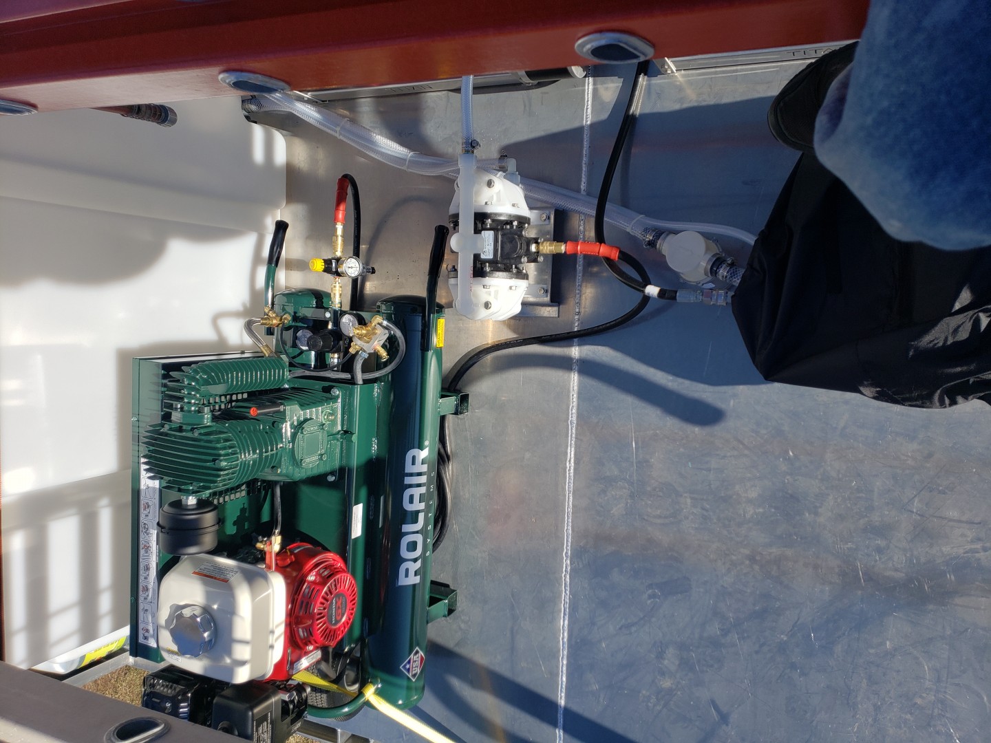

Another thing Erik,..I know that's a nice new compressor, and you may not want to start modifying it,...but one way or the other the instructions to "drain daily" is very important for keeping the compressor working properly and not putting undue strain on the compressor pump. As water builds in the tanks from compressing the humid air,..it will quickly begin to take up the tanks' air volume.
So, you can either open the PITA petkoks on a regular basis,..or you can "T" off the tanks and run a line to an easily accessible spot on the compressor or even the truck bed,.. and attach a ball valve,..and then when it's time to drain,..simply open the valve while the tanks are full of air,...and it will blow the water out very effectively,..and makes a typically PITA job very easy.
Ball valve can be mounted above or below the tanks.
This valve also pulls double duty,..because it also acts as an "easy start" valve.

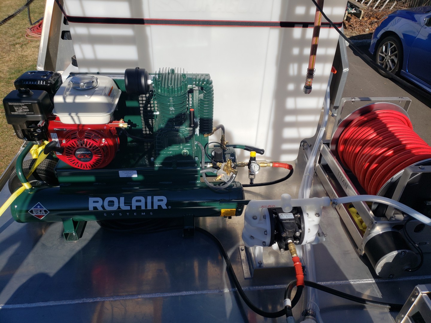

Jeff your right I have to do that modification. The drain valves are now located in the middle of the truck and draining them there will be messy and inconvenient. I like the idea if a "T" and one valve. Is there a kit for this?
Jeff look at the pic in the above post. I now have 2 regulators on the setup. Pretty sure this is unnecessary
-- Edited by DirtyRoofcom on Thursday 30th of January 2020 07:01:00 AM
Correct Erik,..one regulator is all you need. And with a good quality water trap, as Doug mentioned may allow you to forego the idea of the coiled hose through the buffer tank,....but the principle of cooling the air remains the same. A water trap works better when the moisture in the compressed air is turned from vapor to droplets. You'll know at some point what works for you.
To my knowledge there isn't a kit for this modification for your drain daily,..wish they would just do that with compressors at the factory. Simple enough though,...my compressor had screw in petkoks,...I was able to simply take them out and insert my own 1/4" fittings. It's fairly simple,..just sit down and draw it out on paper. And then go get the pieces you need.

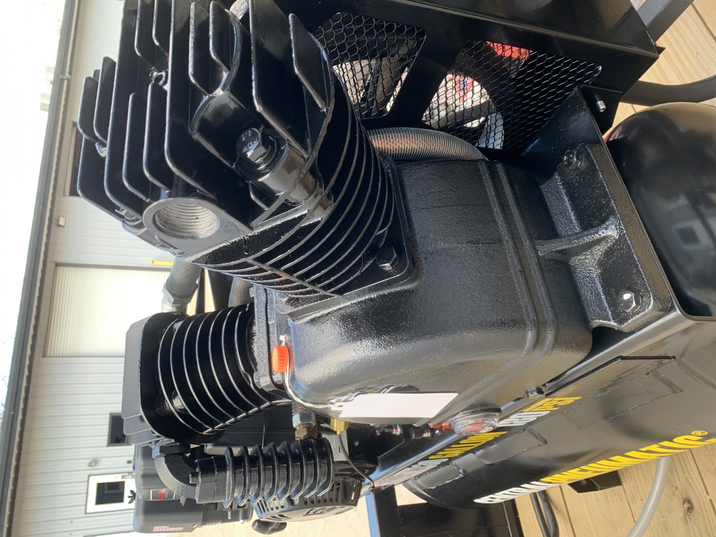

Just bought this compressor for my 1/2 inch all flo...wow what a difference more CFM makes......
Heres the answer to my "2" regulator question above
The 2nd regulator goes after the water seperator. These filters have a tendency to restrict the pressure. If you set the regulator on the compressor at your desired 90psi. The psi on the other side of the filters can be lower.
Its recommended to set the compressor regulator higher (100-110) and adjust the regulator after the filter to your desired PSI (90).
I bought a very good seperator from a auto body supply place and they explained all of this to me.
Feb 8, 2020
Hey Erik,..I respectfully say,..that is way overthought. I personally have never heard of having to use two regulators,..seems pointless in the grand scheme of things,...doesn't mean some people don't do it,..I just never heard of it. I can't see the benefit,...the reasoning you were given by the body shop salesman is really getting into the minutia of a typical system.
The regulator on a compressor restricts air, that is what creates more PSI,...so even if the water seperator is restricting air,..it's not hurting anything,..you can put the regulator before or after the water trap,..and you will see no difference. If you're worried about it restricting,..just put the regulator last in line to the pump.
Wherever you put it,..simply adjust the PSI to suit your pumps needs. Right next to the pump,..as I mentioned,..will suffice for your concern.
With that said,..you can can use as two regulators if you prefer,..not gonna hurt anything,..just pointless is all.
If anything,..the second regulator will cause a "possible" decrease in the all important CFM.
*Reminds me of a well respected member of the forums years ago that tried to explain why some people get streaks on siding while others don't. He said,..when people spray soap on the house from the top down,..as opposed to the " from the bottom up theory",.....He said,..the water in the soap was evaporating thus making the soap too strong for the siding,..resulting in streaks. He had people agreeing with him,...those were sheep. I was the first one to say,..seems way overthought.

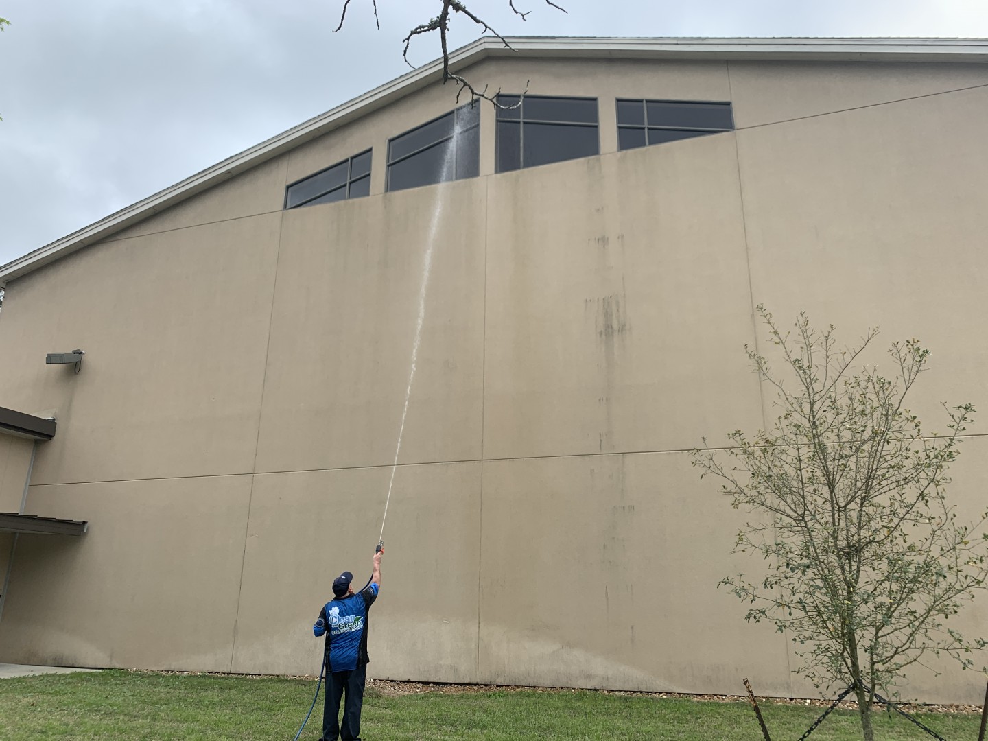

This is from toady with a little wind....using a 0060 nozzle

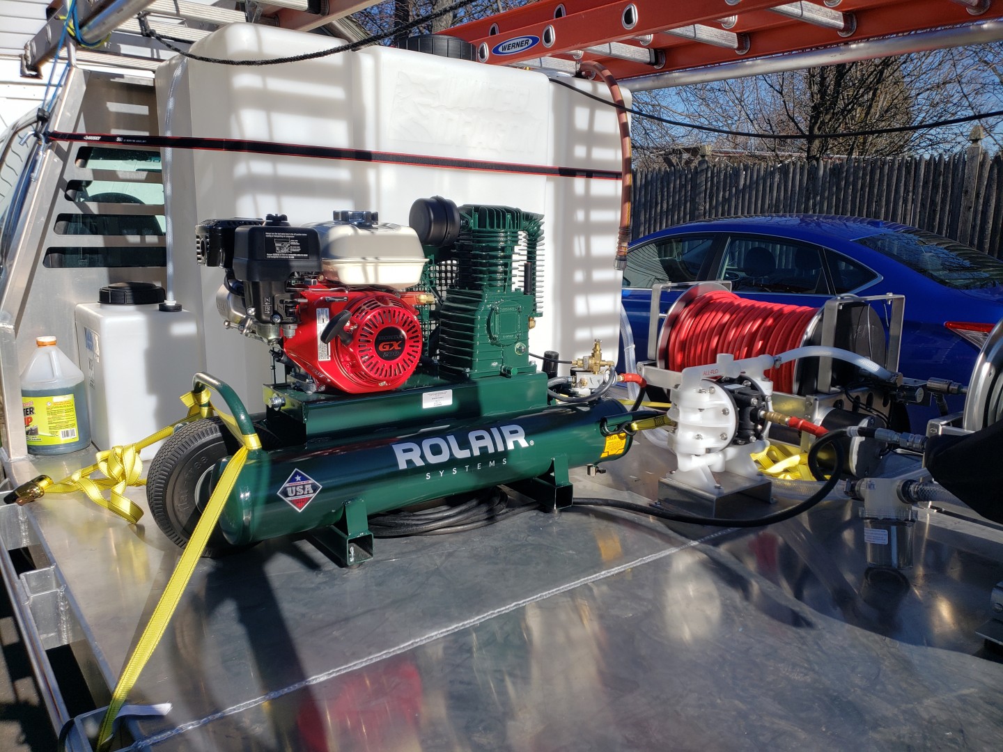

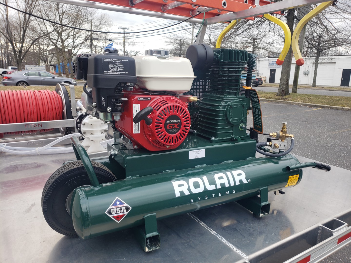

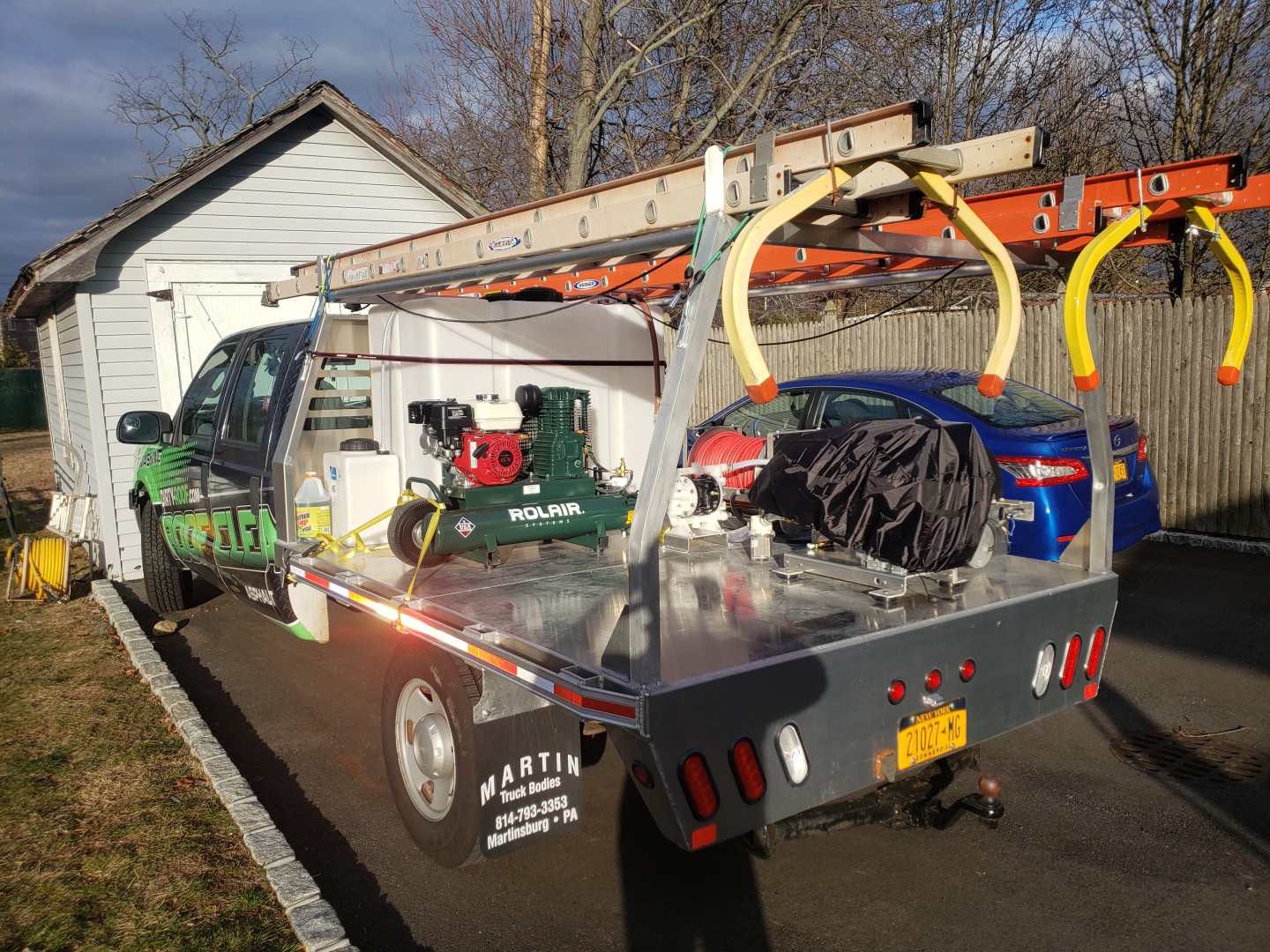

Debated for way too long on compressor.
Pretty sure this will be its permanent location.
Looking nice Erik,..good quality compressor!
-- Edited by Jeff Wible on Thursday 30th of January 2020 06:14:45 AM
Same exact compressor I have...has been a good one....like Jeff says, drain daily, on long days we drain before every job. Also be sure to run a vent tube from the SH tank out to back of truck....you'll thank me later....we use the Tsunami filter...we have used the one in your pic before but they dont last long....
Good points Jeff. I believe you're right. I'll probably just go w one.
I have a good handful of roofs done with the new air setup and I'm really not impressed. I was expecting much more flow and distance. Its basically the same as my 12v setup, I actually think my 12 volt shot a better stream.
Any of you air guys have a video of your system running?
I probably get around the same I guess,.never measured,....But, as long as its calm I never complain about the distance.
You may have went in with too high expectations,..keep in mind,..the value of the air system was only ever mentioned as better due to it's simple setup,..more reliable than 12V electrics and the wiring,..and also the longevity of an air pump is very important,..at least to me. They also give peace of mind that it will likely work everytime.
Bigger compressor will get you there.....thats why I went with a bigger one on my 1/2 all flo....made a big difference
Doug and Jeff.
I'll see if I can get a video when it stops raining.
I have 12 cfm
250 ft of 1/2 inch hose
Poly gun
Fatboy tips not sure what size those are
#3 shooter tip (blackmon)
Regulator is set at 90psi at the compressor. I'm considering putting pressure gauge after water seperator to make sure it's not being restricted by the filter.
The only issue I had with 12 volt was pumps not lasting and lack of gpm.
