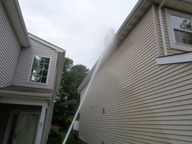

We use JVH shooter tip often. We have others as well. With the JVH tip we have reached four stories / 42' as seen in this photo. It's about having options.

Hank,
I assume that is with a pressure washer and down-streaming?
Mar 1, 2016
Hank,
Doug,
Yes it is. It's a 5.5gpm permanently mounted on my truck.

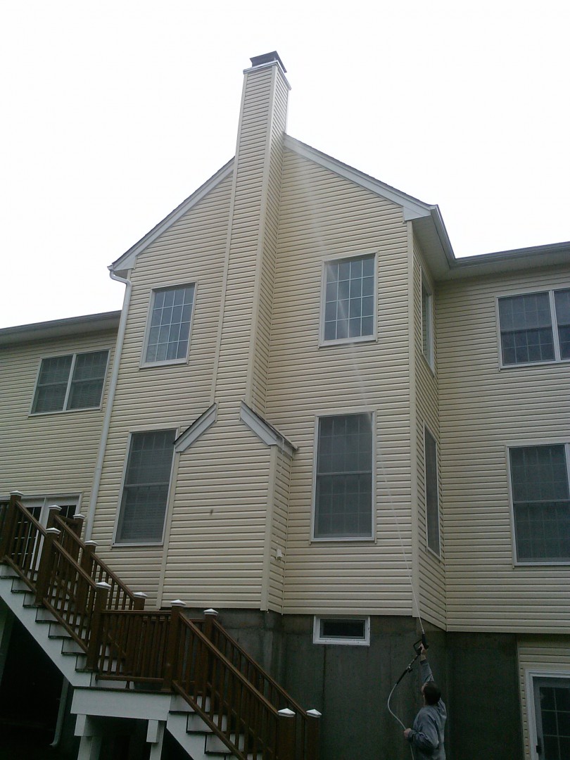

This is a Jimmy # 3 Shooter tip.
