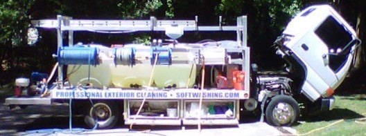

This was our rig in the early stages with 3 200 gal tanks mixing multiple times for each job!

This is our rig after reducing it to the 2 tank system with the proportioner prototype . We have made many changes to this truck since photo.
Brett, this is solid system that will help you save tons of time. We washed with it today on a stubborn older brick home under multiple live oak trees.

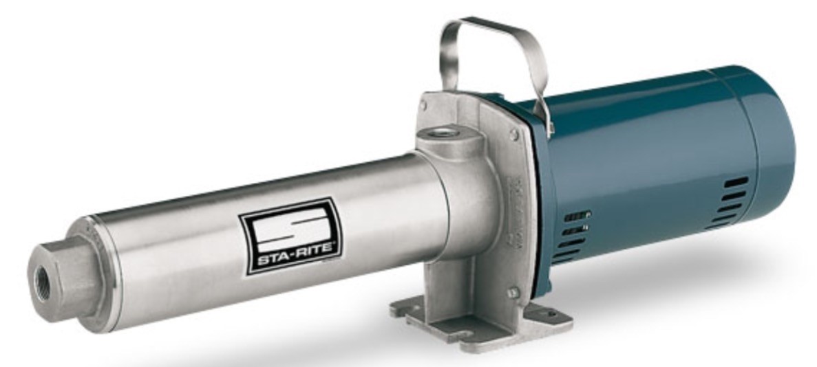

I've found since moving to Florida a lot of people prefer you do not step foot on their tile roofs. So I've been shooting from the roof line but sometimes have a little trouble reaching the peak, even with extensions. I thought the booster pump was for rinsing, but this post suggests you can apply the roof mix as well as rinse. How well do they hold up to the SH? At around 3X the cost of regular roof pumps I would be a little leary to do that.
Been thinking off adding a booster pump lately and if I can safely run SH through it that would make my mind up.
Aselton said
Sep 28, 2015
SH will definitely be the death of your booster pump. They have lasted a whole season for us before. You need to buy a quality pump and take care of it if you want it to last. We are currently using a Sta-Rite HPS7D-01, It's a S/S 3/4hp 115v . I put it on the truck in March and washed all day today with it off 100' of 10ga cord. I would only use 10ga cord because of the power loss at distance you don't want to run them hot. Running it off a generator is fine too, I just like the silence when it's just 1 man. The fact that you apply and immediately rinse with the pump is a huge plus for extending its life.
This is our current pump.
That's basically the same pump we use just ours costs a bit less.
