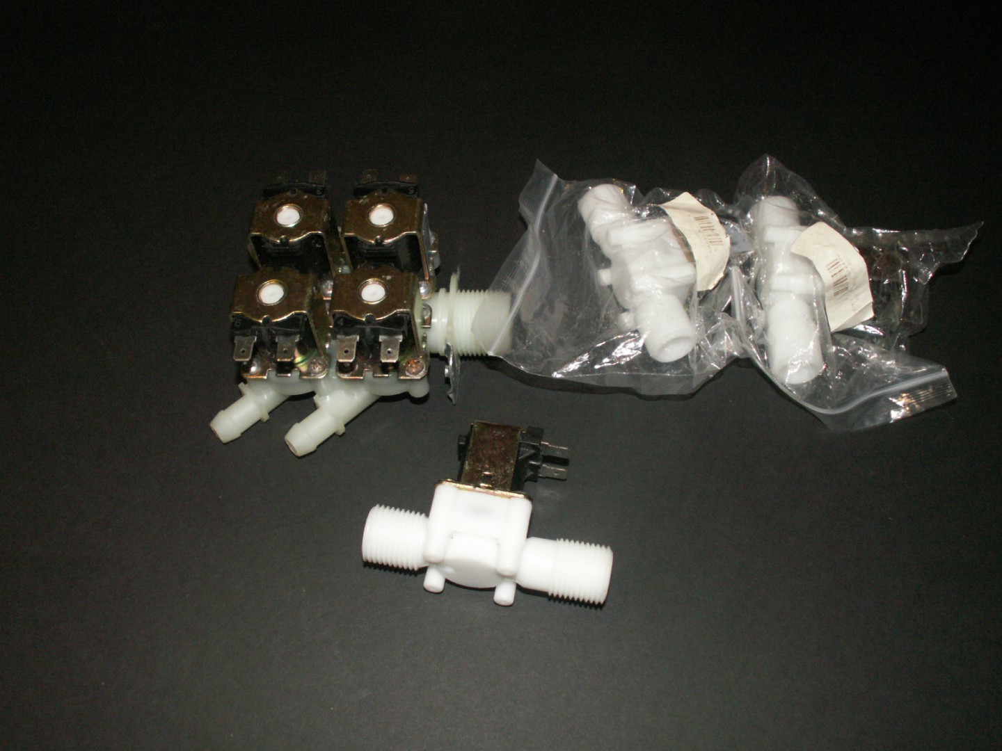

Remote units are a very easy build. And the solenoids you showed are the ones I'm using now and am happy with. With rinsing I get about a month out of one.

*The ones that went bad were just barely,.AND I MEAN barely pulling soap when shut off,..but I just change them and don't try to get every second out of one. A couple times I know it must have been debris at the plunger,..because a good thorough rinse out and the issue was solved. I haven't had one sticking or or a coil go bad yet with this solenoid. These units make such a difference to anyone who DS's.

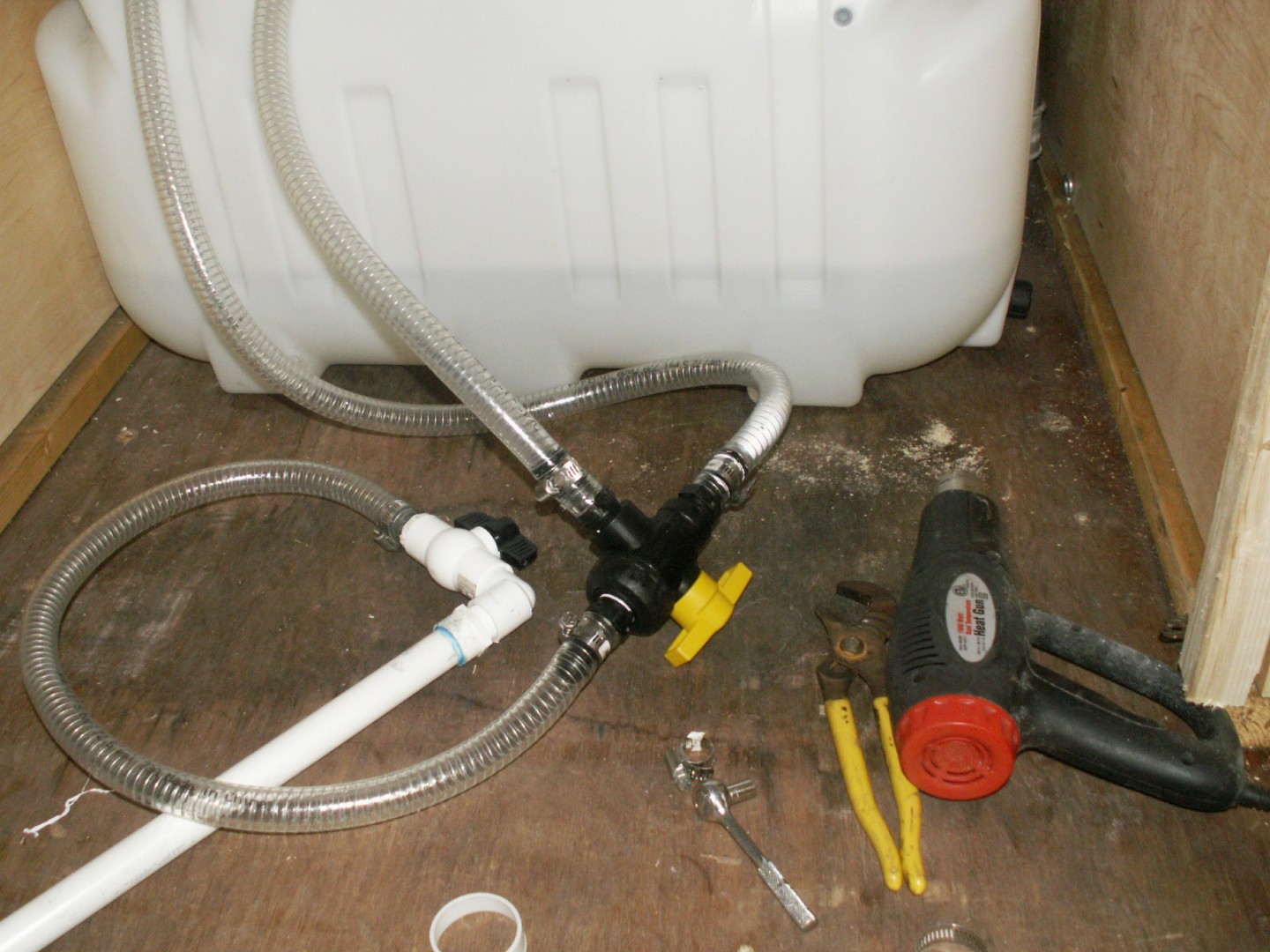

Hi Anita and Joe. I am new here, so perhaps I didn't understand where you are going to use the ball valve to bypass? On my simple soft wash rig, I use a L type 3 way ball valve I purchased from JN Equipment, part number ( AGBV8216230 ball valve 3 way). I am assuming that you are using a low pressure ( under 100 psi ?) system, so the valve will be on the suction side of the pump (up streaming). I use mine to switch from SH batch tank to a rinse tank. This particular valve does have motor or solenoid capability, but perhaps pricey. I have several of those small 12 volt valves left over from another project. Nice conversation...
