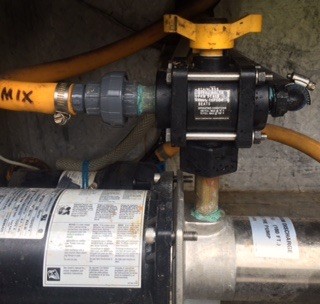

The hose to the left is plumbed to the Proportioner, the hose to the right is plumbed to the water intake reel off the house. You can plumb the right side to the water tank, but it has a lot more power when water is forced in it.

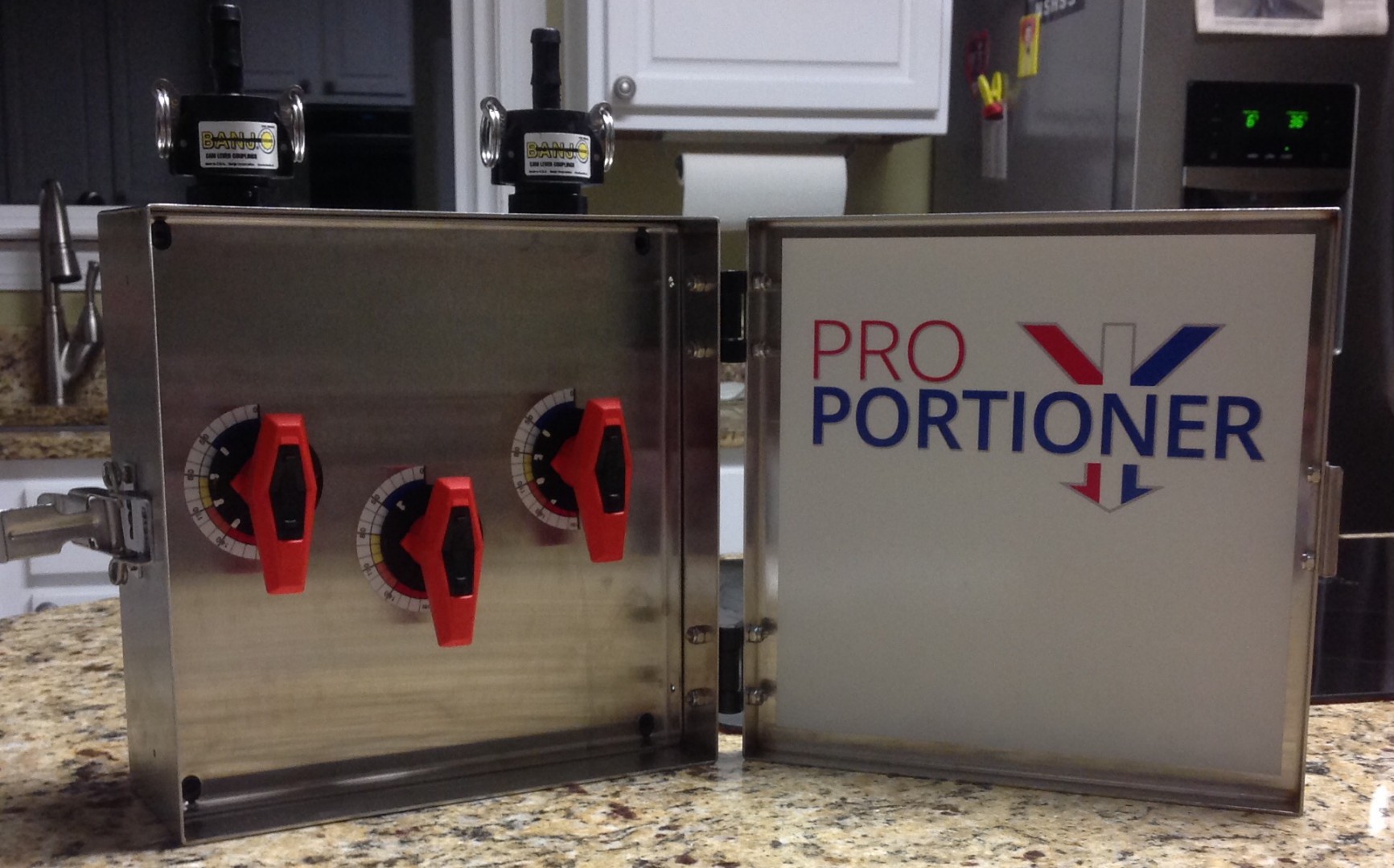

This is pic with dials... This is my demo that is unused.
I'm seeing a few guys talking about bad mixes lately. By now most everybody understands how the proportioner works. This system would eliminate ruining a whole roof mix if something wasn't right. The ability to raise or lower the strength of your mix is always a plus, but as temperatures start to drop it can be real important to tweak ratios throughout the day.

This is the simple plumbing, left side to Proportioner and the right side to water intake.
This is in a box under the deck, this was a temporary install in March because I was sure I would be in my new rig shortly....
