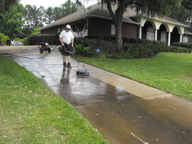

Is this normal striping? or do I need to adjust my machine? I did spray it with house wash afterwards, but I don't remember if that was before or after the photo. Still looked stripey when we left. I've got 5.5 gpm/4000 psi/WW Classic 2 nozzle/factory 2502 nozzles.

That's why you should try the circle method or crisscross method go up and down the driveway then side to side and will never have that overlap issue
Jun 25, 2016
Bryan,.I'm not sure but you should be using bigger nozzles on a 5.5 GPM machine. 2503 would be more like what you need I think. And that is "Normal" striping,.as far as striping is concerned,..but it isn't normal as in a desired finish. Pre-treating is a big help in avoiding this,..Pre-treatment can be anything from house wash strength to roof strength,..that's an evaluation you make per job. The circle method and crisscross does work but slows you down and doesn't clean as well as a pre-treated will get you,.unless you go really slow.

Thanks Jeff, I wondered about those nozzles. I had already ordered 25025 and 2503 to try. I'll try them on the job Monday
Jun 25, 2016
Thanks again. swapped out to those 2503 nozzles and it seemed a lot more even and little or no stripes. It also "floated" a little more...which I assume is a good thing. Feels lighter and lots easier to move around.

I'm almost embarrassed now that I see that photo knowing that my nozzles were undersized and causing the problem. I changed to the larger ones and now, while I have to clean just a little slower I'm cleaning evenly and leaving no stripes. I still cross back over my work the opposite direction and I'm getting great results. Jeff nailed the problem and I'm thankful for the help.

Bryan when we have that problem we just go in the opposite direction. By going in the opposite direction it breaks up the stripes. Then i lay down my house wash to get that brightness on it. Turns out pretty good like that.

Just wanted to add that regularly changing out your tips will help as well. it doesn't take too much wear for one to get out of wack with the other. Also if the stripes are there even after you post treat, you could rinse off the mix and apply a light oxalic coat.

Stripes = weak mix, too much pressure, going too fast, not enough dwell time, no post treat.
Sometimes the stripes go away when the concrete dries. If the stripes are light tan, that is usually the phantom stripes as I call them. My theory is the pressure of the surface cleaner actually forces the water out of the top layer of concrete, on the sides of the SC, giving you the stripes. Sort of like the stripes you see with lawn cutting. The stripes are actually the leaf blades are pulled in a different direction.
