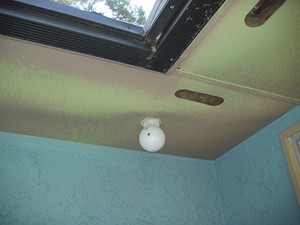

Any paint has tint and some tints are not color fast (see pix). Please do a paint test first to see if the paint will change color. Other than that as long as you keep the paint rinsed off keeping the roof cleaning strength from dwelling on the paint too long, you should be OK.
Another concern can be how long ago was it painted. If the paint hasn't cured yet the bleach can act as a solvent blistering or removing the paint.
Also industrial paints like elastomeric are robust and take bleach exposure well. I dont think there will be an issue. Just watch for paint color reversal.
