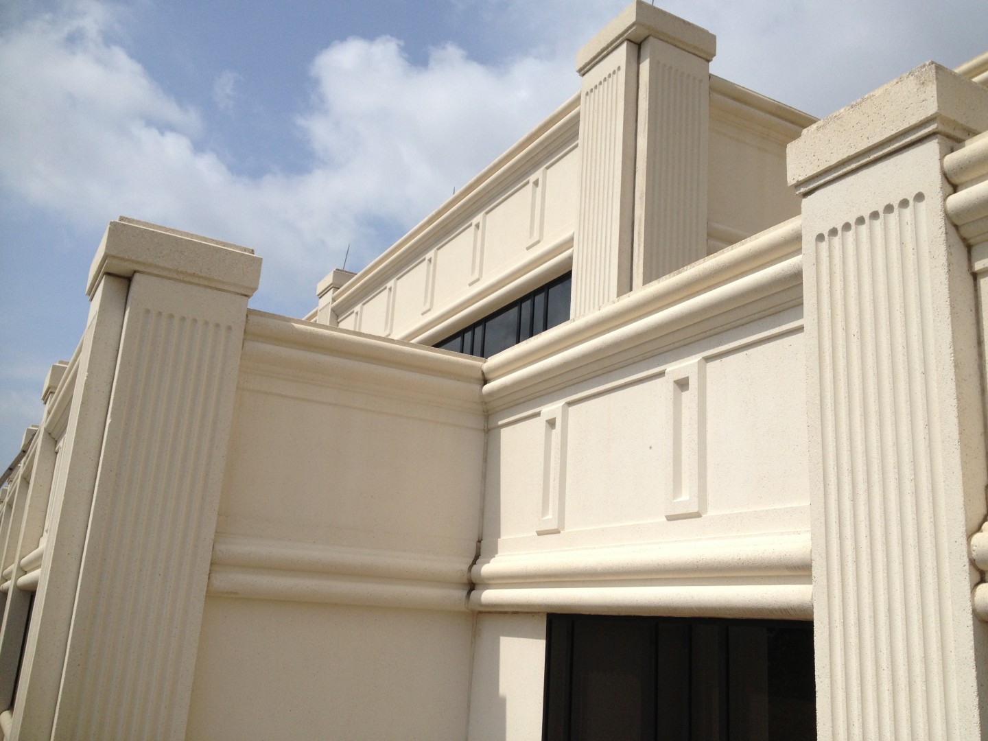

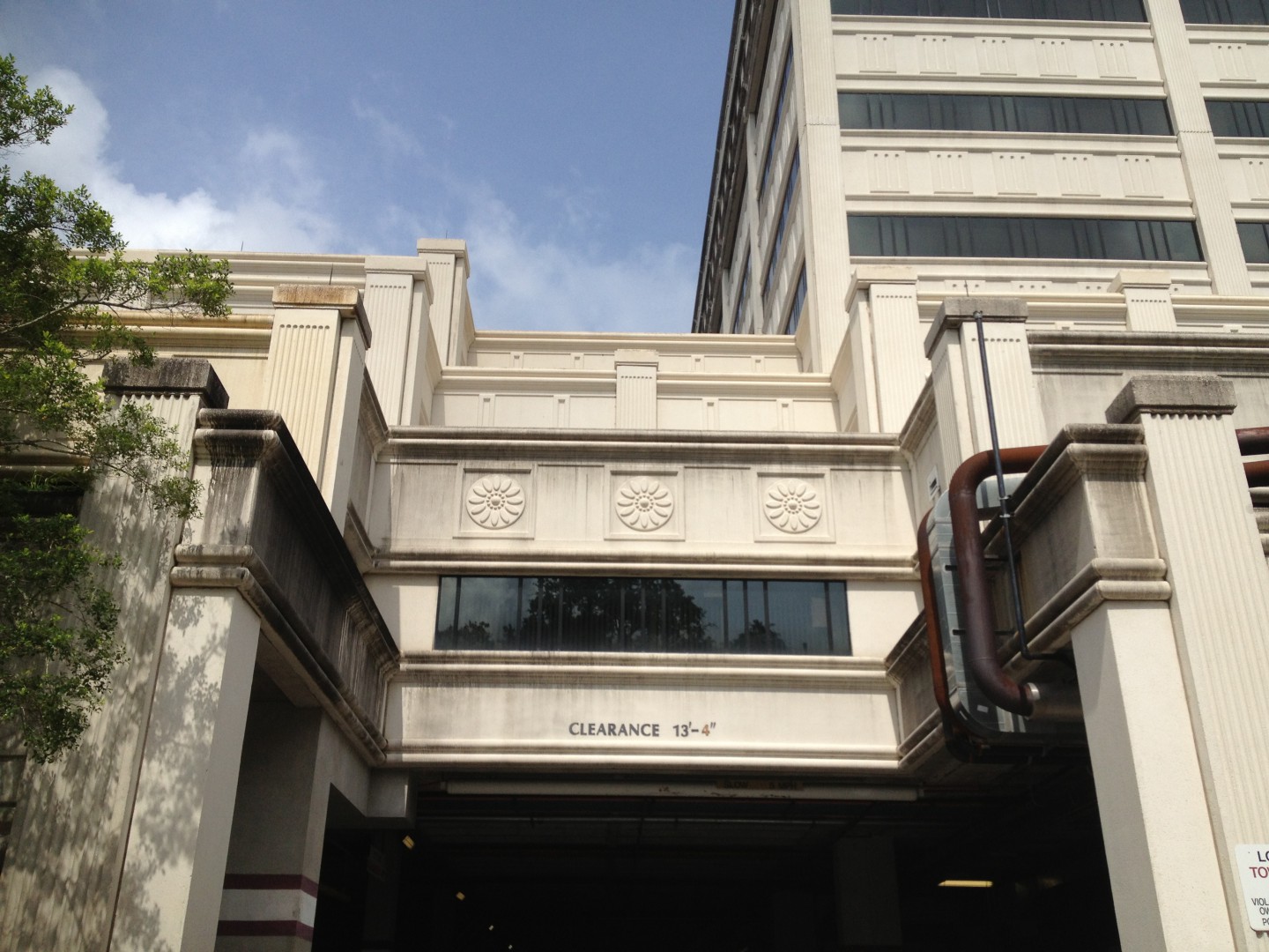

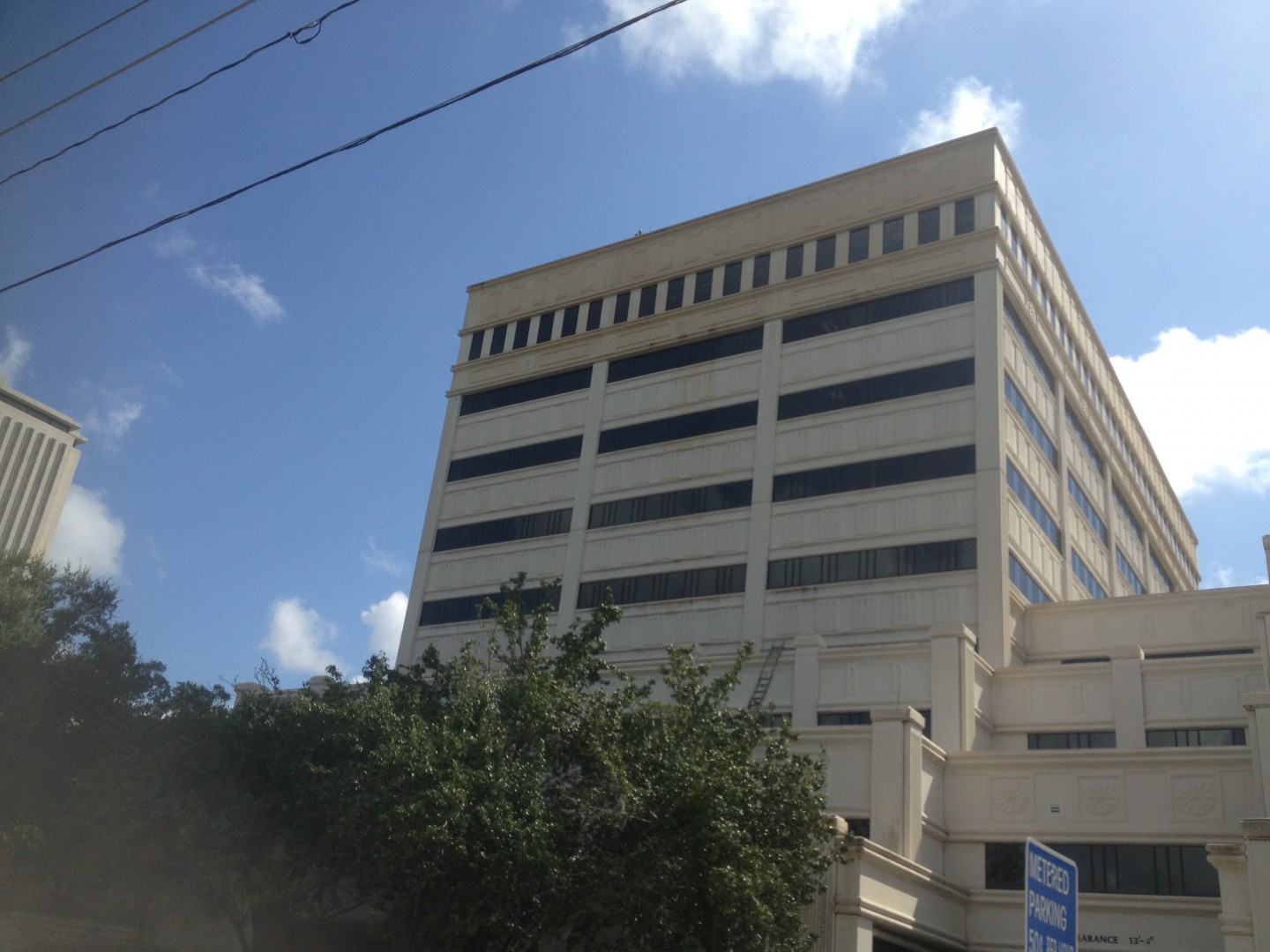

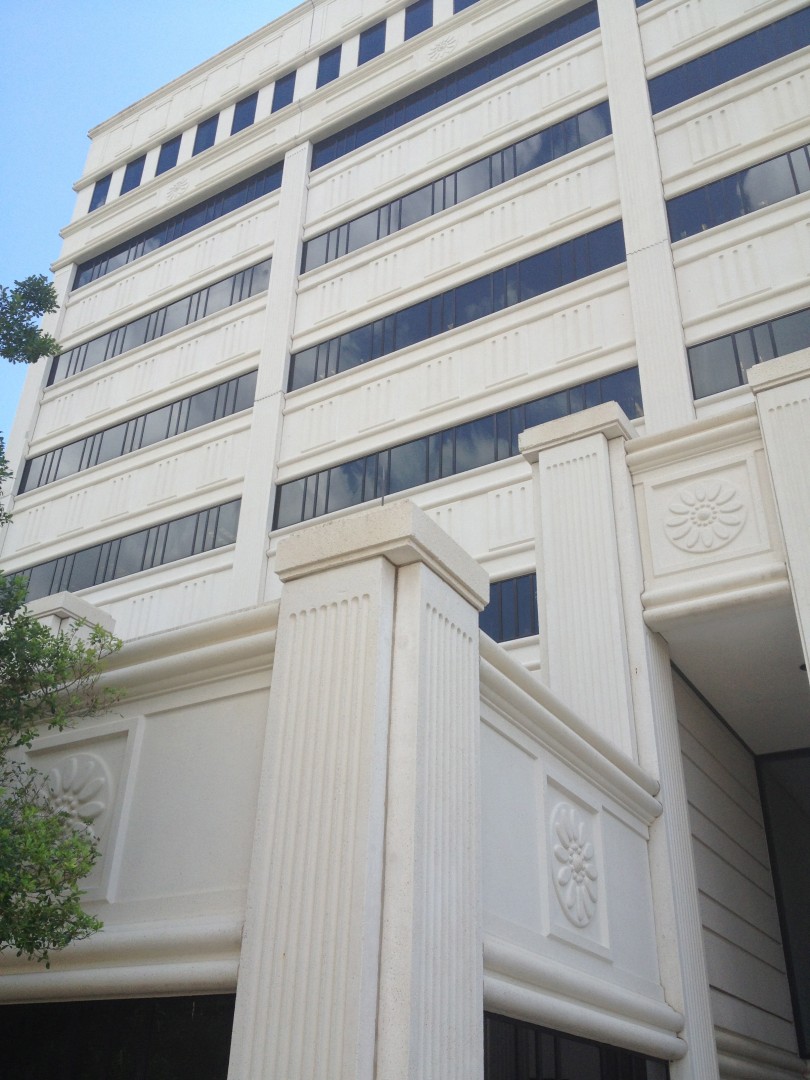

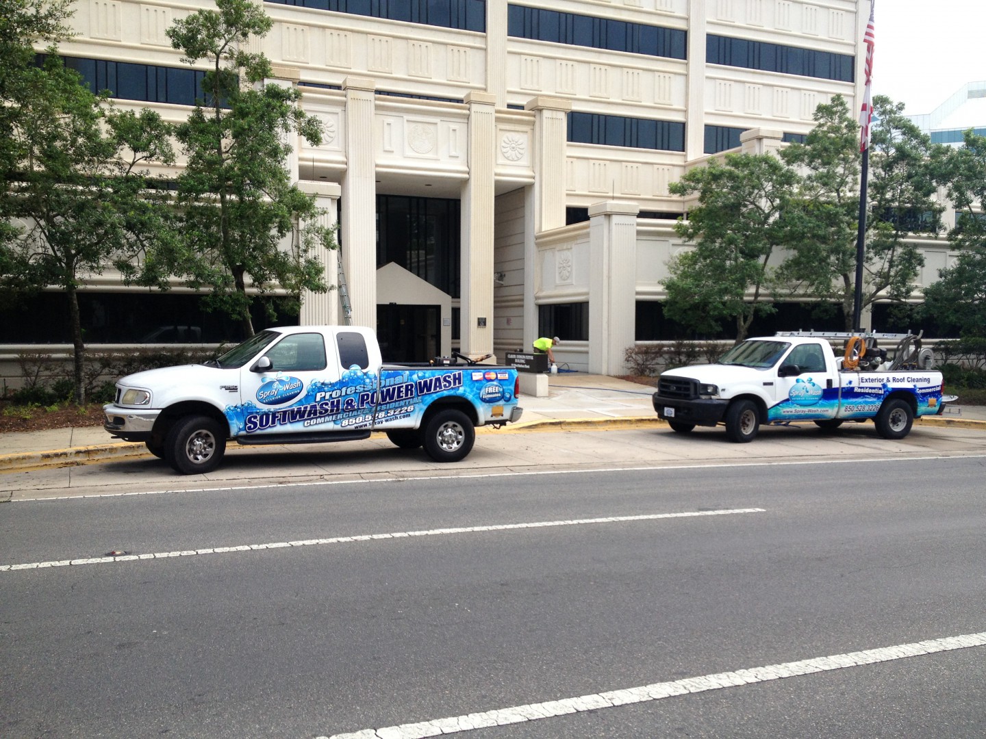

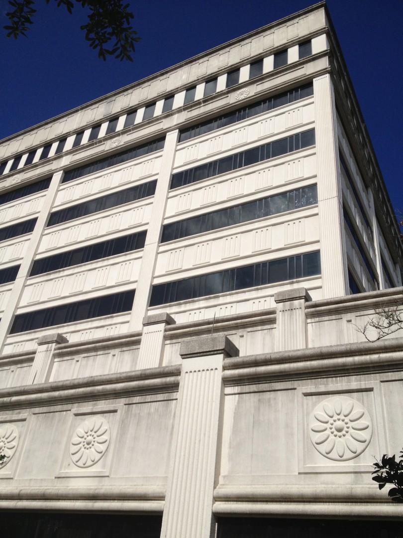

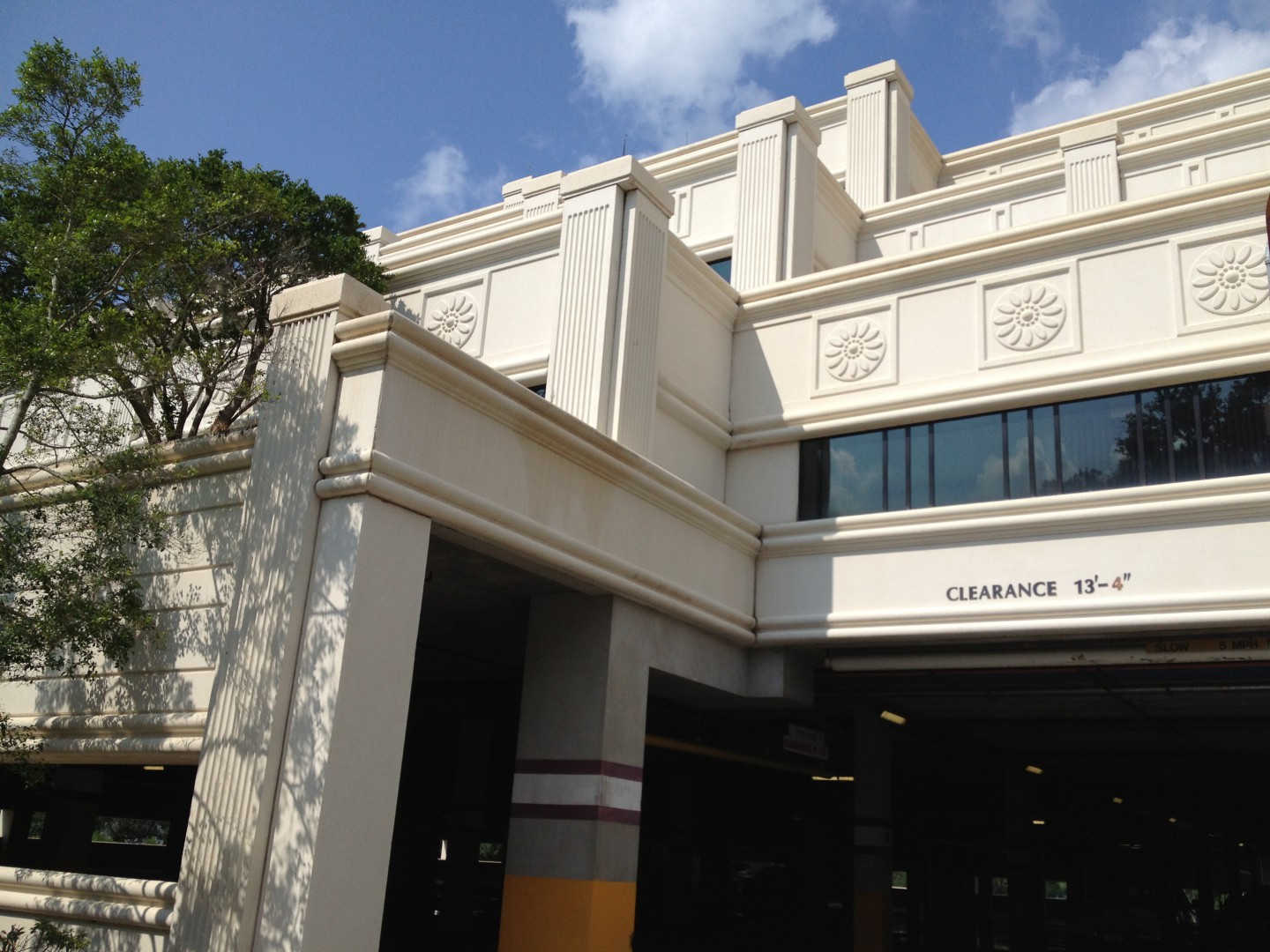

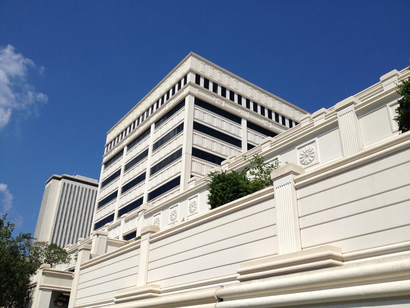

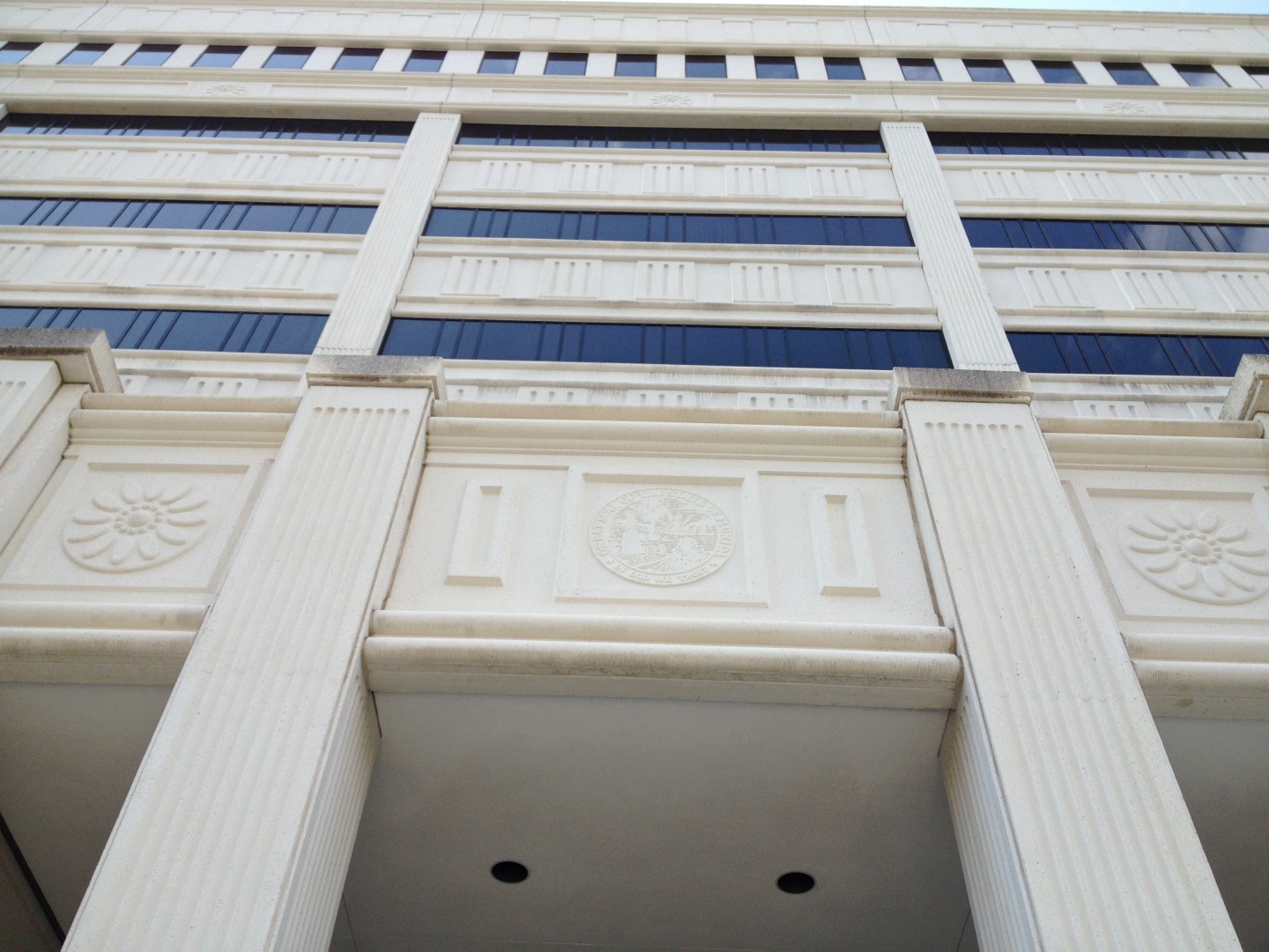

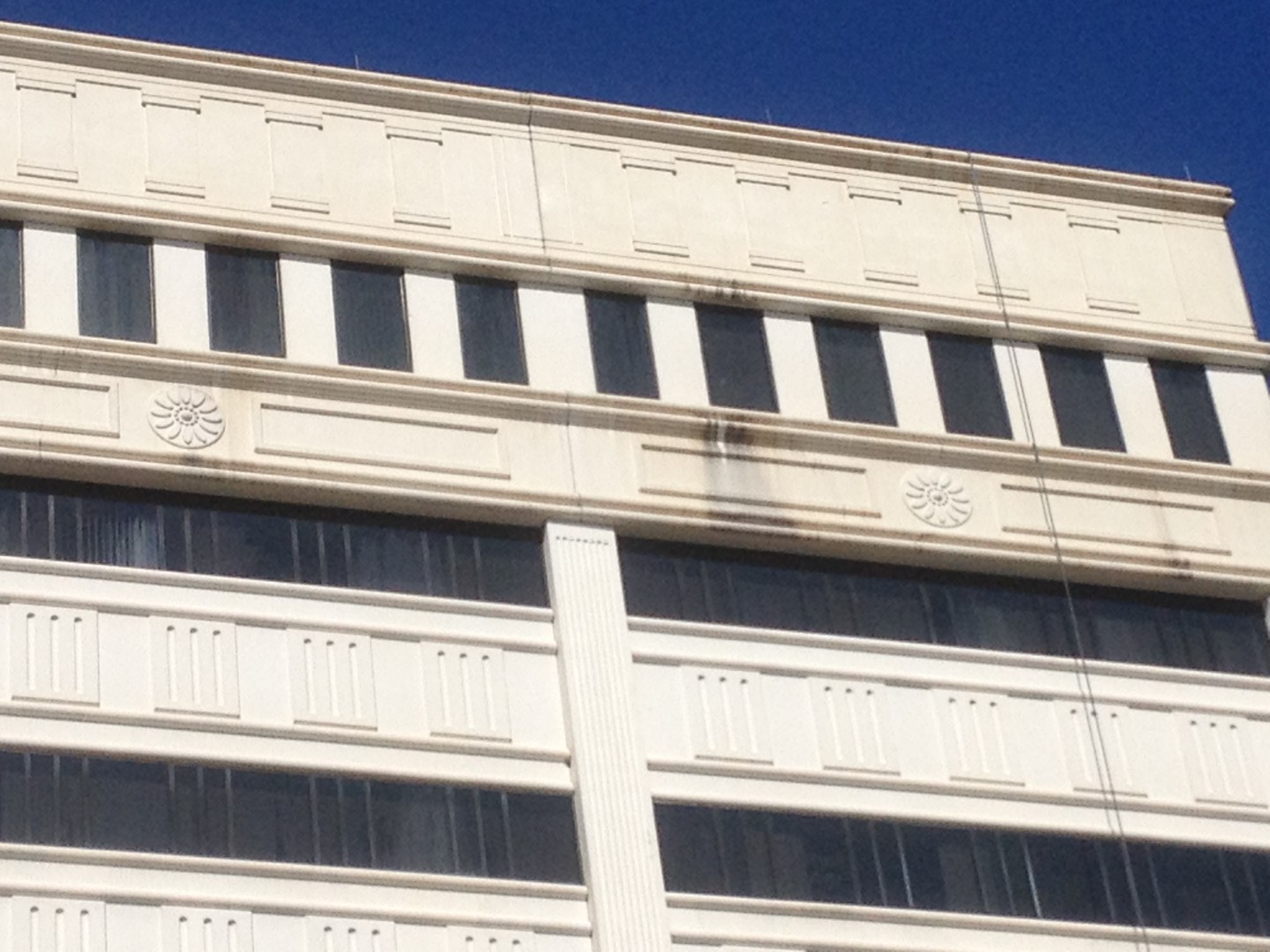

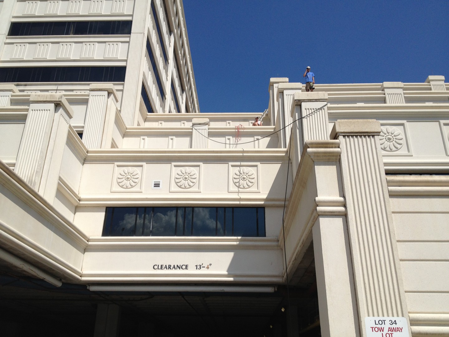

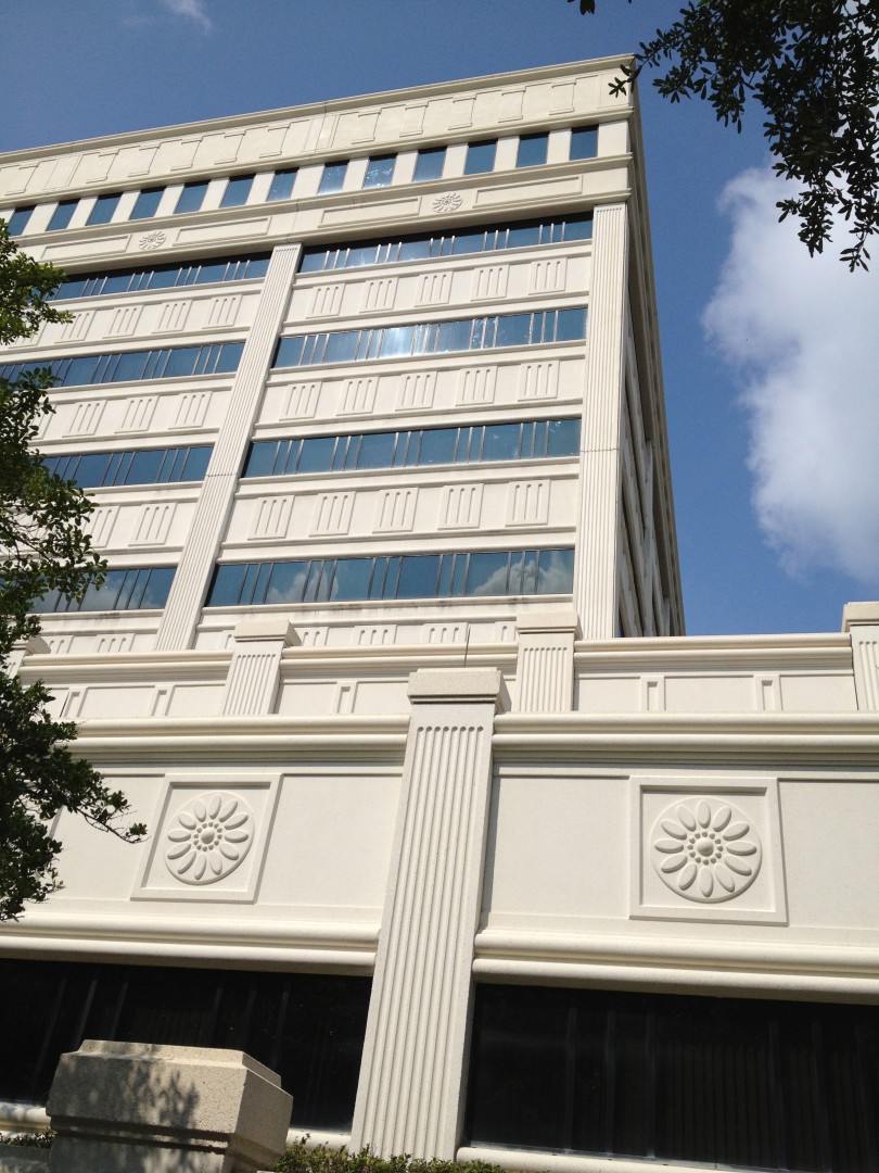

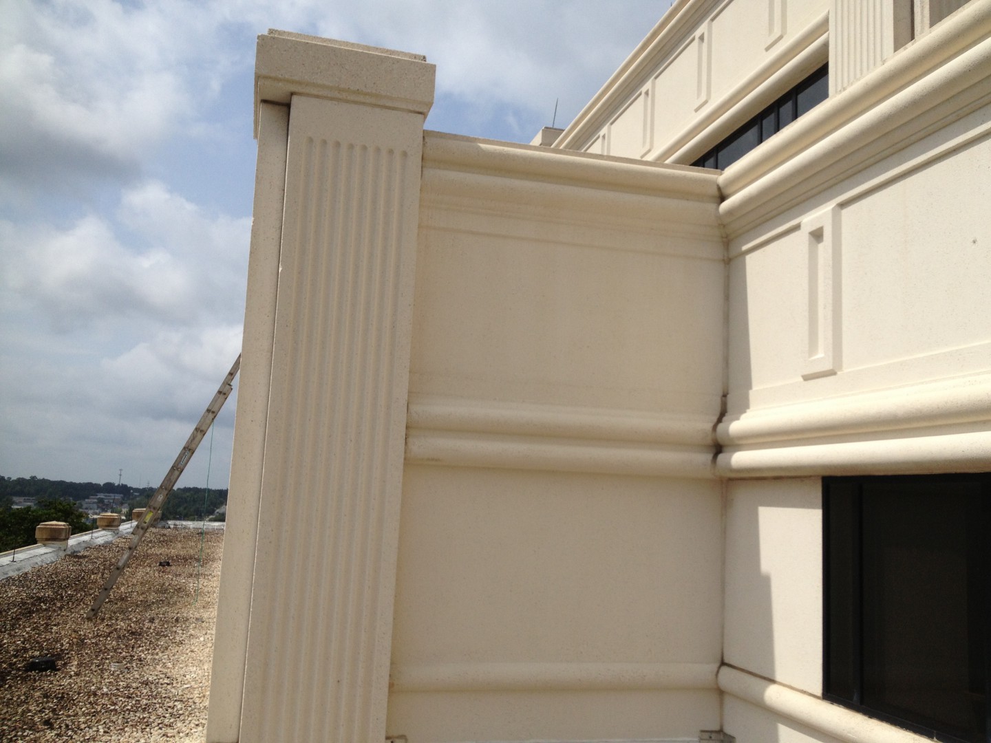

Spray Wash just finished this monstrosity, the Claude Pepper Building. Its located on a whole city block, so its a big one. Technically its 13 stories from lower parking deck to penthouse equipment area. Project too 20 days to clean, and during that time, we never cranked up a pressure washer! Everything was softwashed with our Dayton Booster Pumps. Used a 20% and Greenwash mixture, bustling is all precast and white concrete.

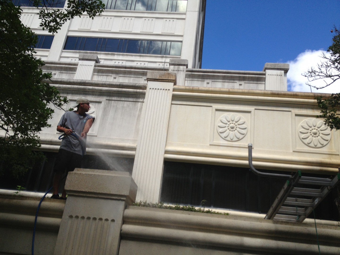

I all of my commercial bids, I either 1) offer a freshwater wash down of windows, and recommend a professional window cleaning service upon completion of job, or 2) sub-contract out the window cleaning to a couple of professionals I know.
On this job, we gave a freshwater washdown of the windows with the booster pump, and they were happy with the results. Taped the hose to a 20' extension pole then that pole to a 15' extension pole and washed from the top down for the top three stories, and from ground or lower roof areas for the other windows.
Questions? Feel free to ask!

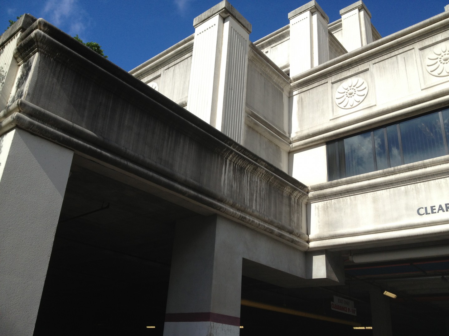

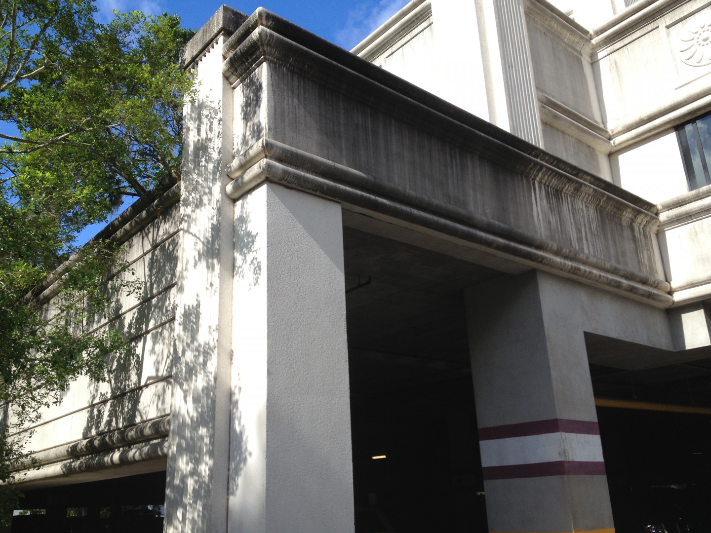

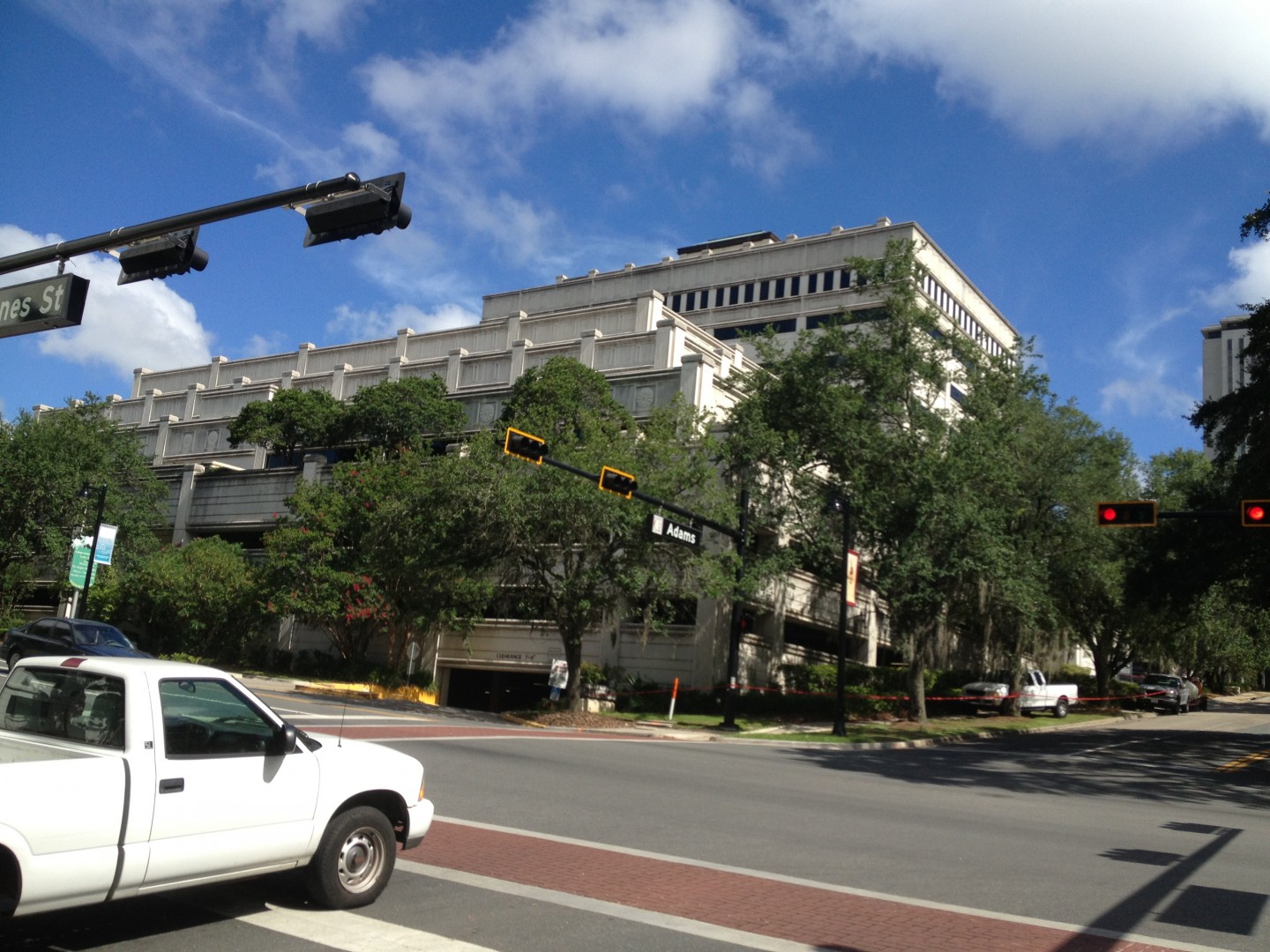

Here are a few more pics

What did you do about windows?
