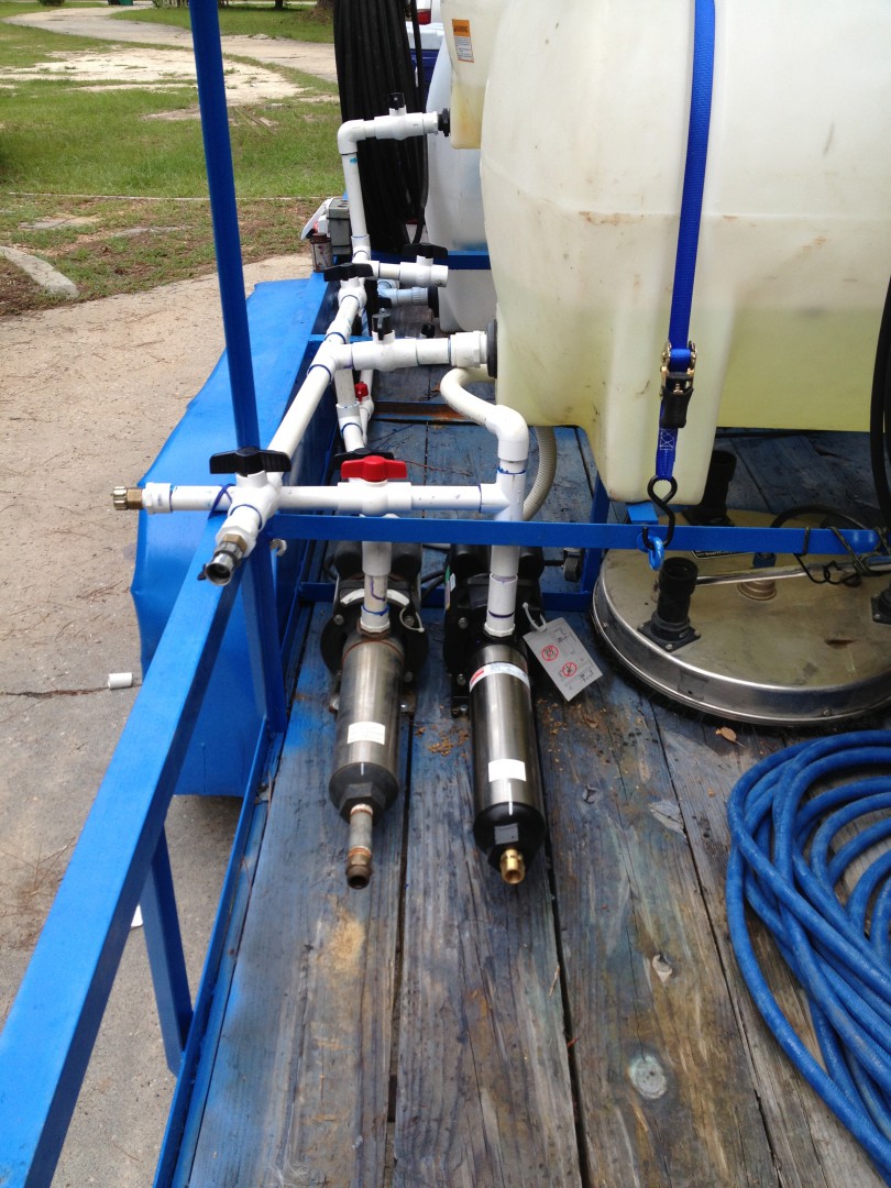

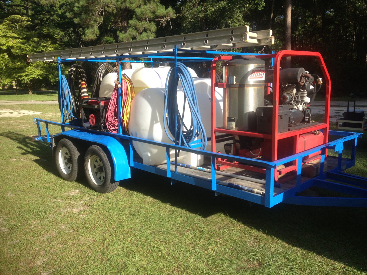

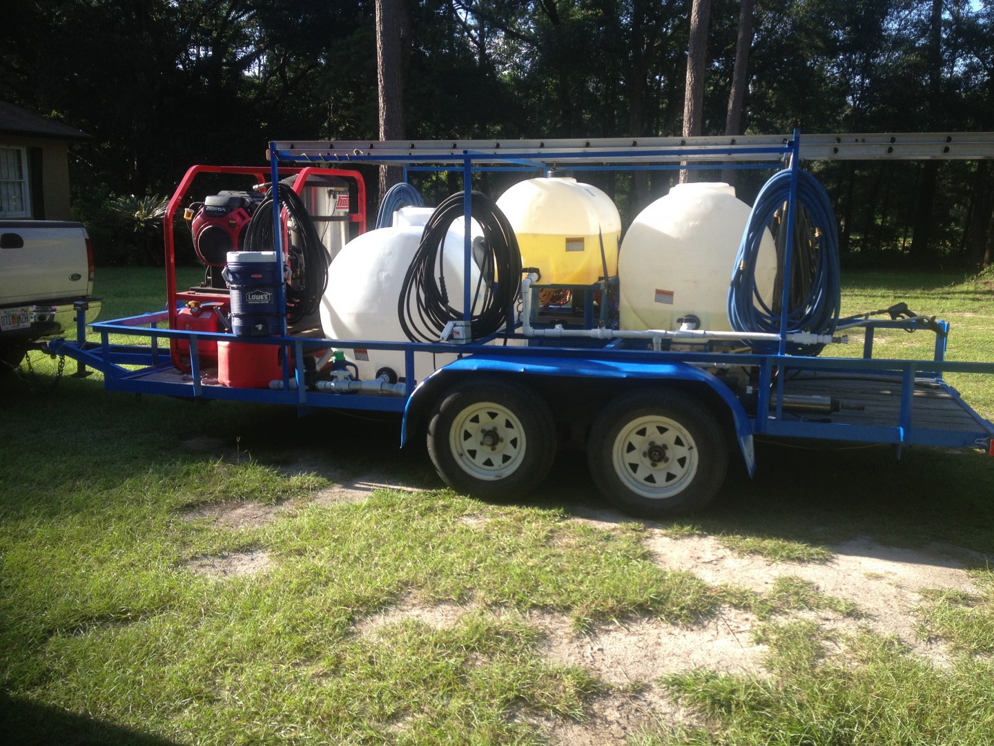

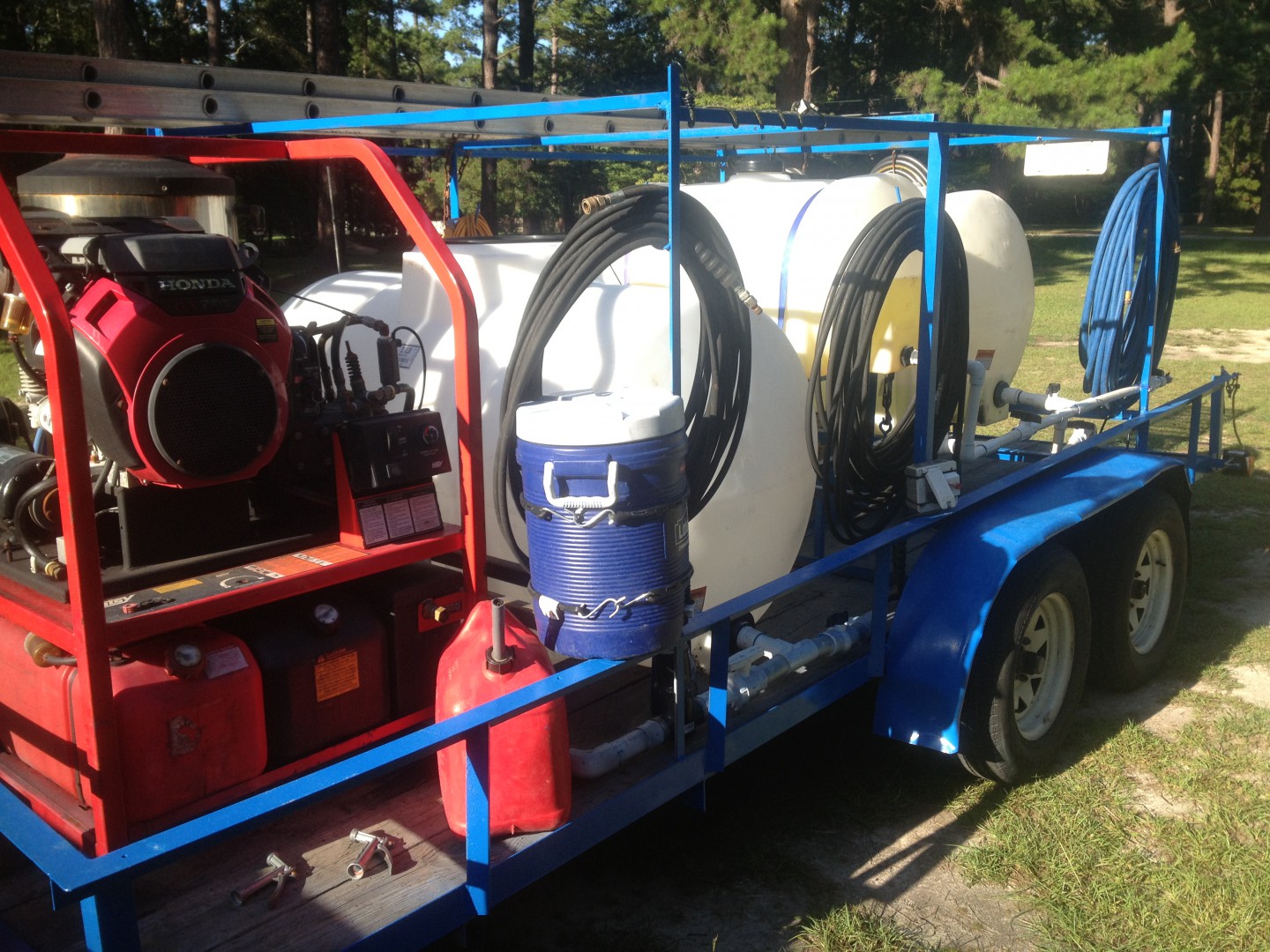

There are two systems I use for vertical surfaces. One is a modified SWS skid to which I've added a booster pump. The other is on our large commercial trailer with which I use the booster pump ( Dayton 3/4 hp) to both deliver the chemical mix and the rinse water. On the large trailer we've added a second booster pump ( Dayton 1 HP) for rinsing only.
I put in a couple of links to show the booster pumps in action.
We follow similar procedures to Ray Burke. We always apply with our Chem pump and rinse of with the cannon (booster pump).

There might be some missconception about the booster pump. I apply chemical and rinse with the same pump and same hose. I also use the customers water, so rarely on a residential job do I need to fill my water tank. One of my favorite things with the booster pump is how quiet they run!

Yes I am using the same pump and hose for application of chemical and for rinsing. Technically it's not a garden hose, it a 1/2 inch Goodyear hose with a psi rating of 250 psi. We dwell chems usually for 10-15 minutes.
On a roof, or delicate landscaping, I'll add a the second pump and another hose for additional rinsing.
