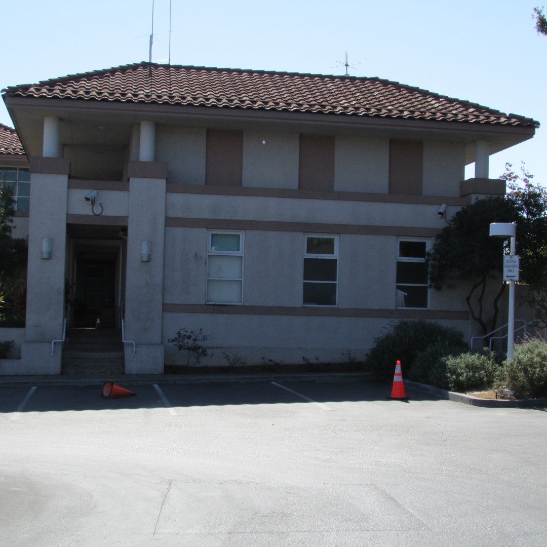

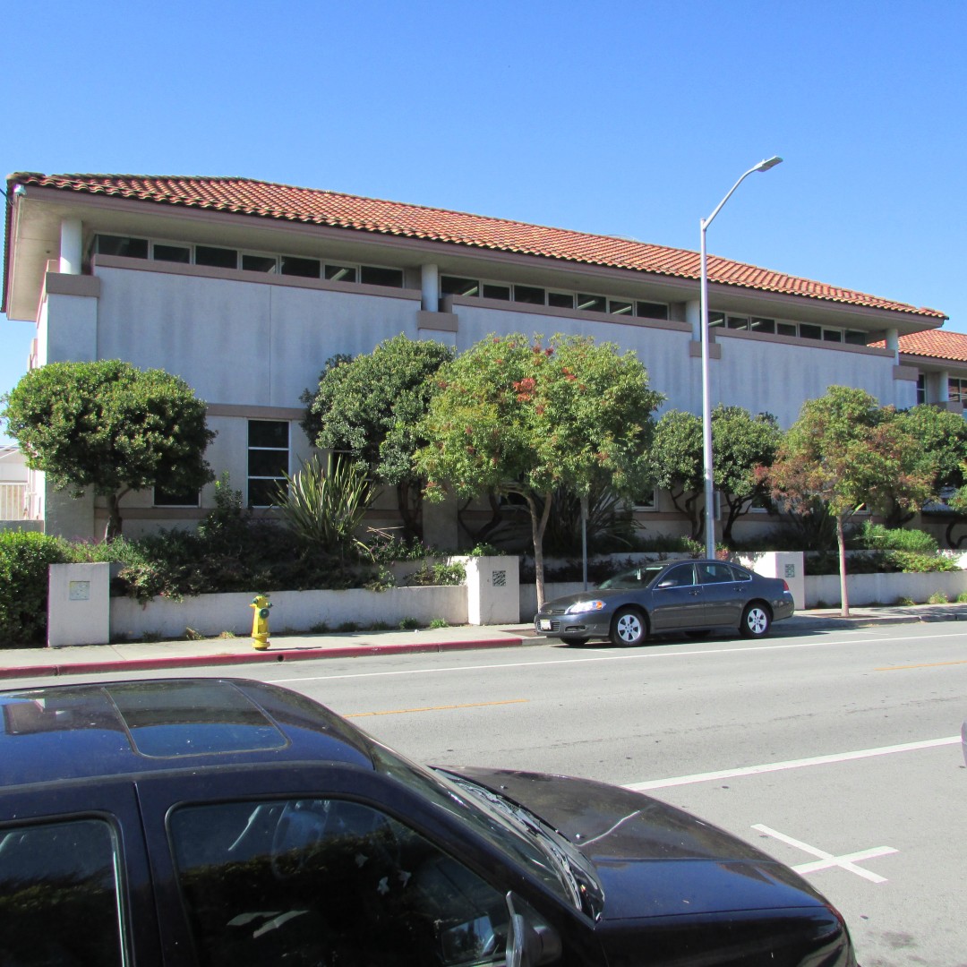

I have a contract for the police department. Its a big nice building that will come out incredible. They specifically asked if I would reclaim. Yeah Ray, for the most part it will all go into flower beds but I have to catch what does not. I mainly want it for the photos for marketing and also to go after the many other facilities the city has.
