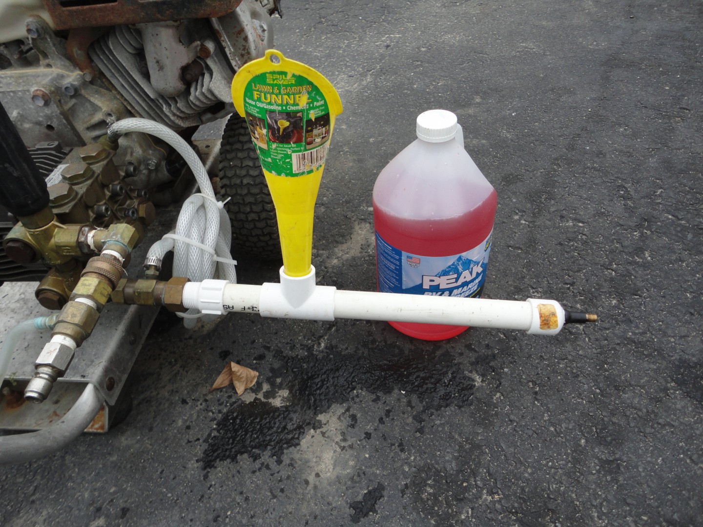

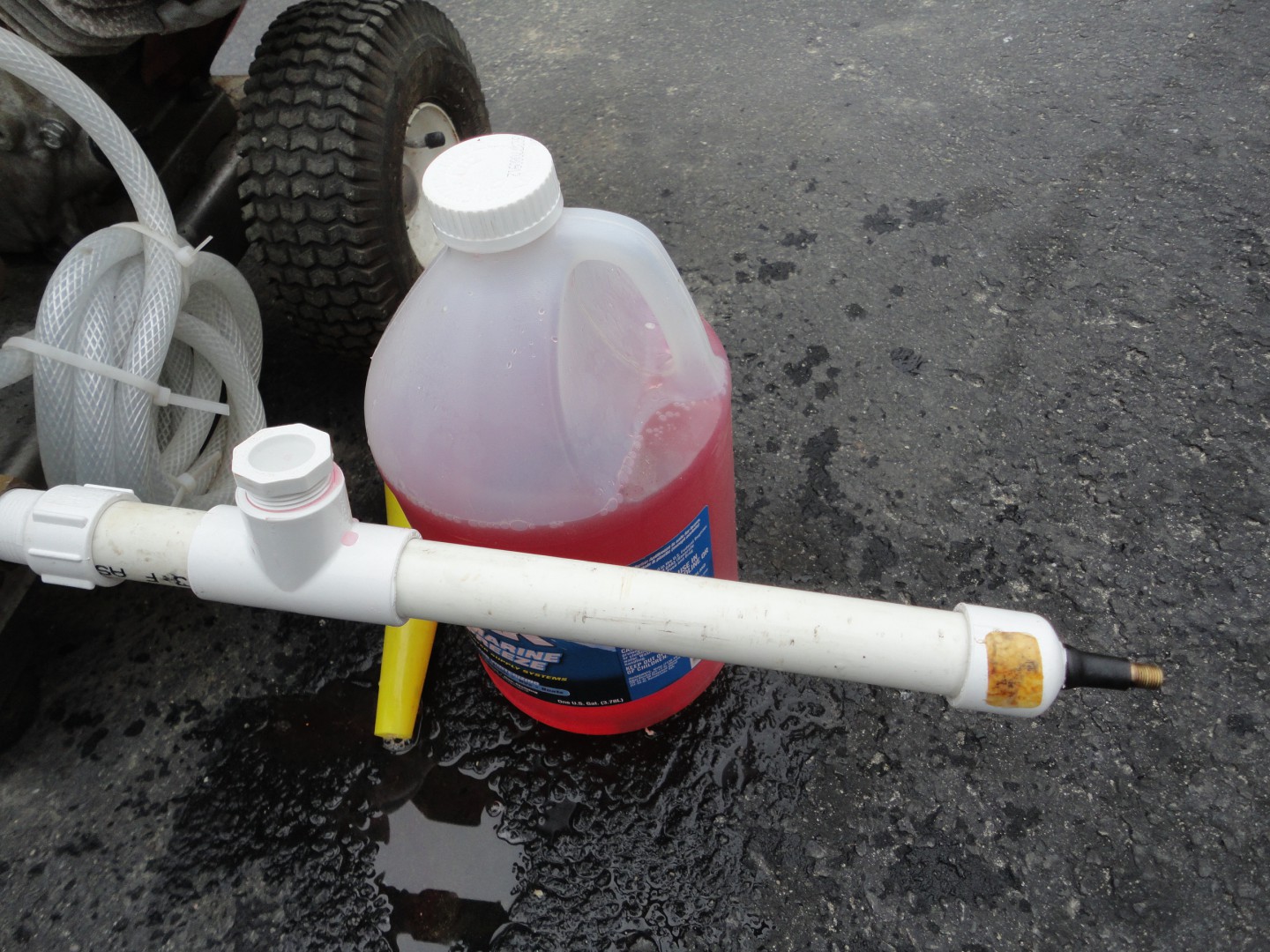

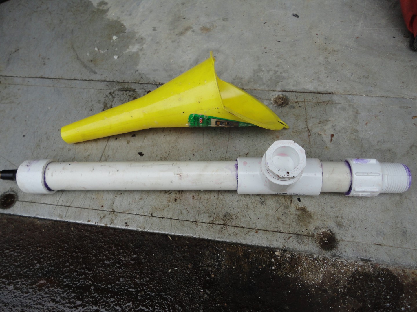

I just made this up today. Winter is getting close. Make sure to glue the parts like I didn't. First I blow the pump out, Then fill the tube with RV fluid and give it a quick blast.
Art that's awesome!! I'm serious when I say this because most people are too busy to buy the parts and make their own. (I'm sure you know where I'm going with this...) If I was in the freeze zone, I would buy one from you!!
