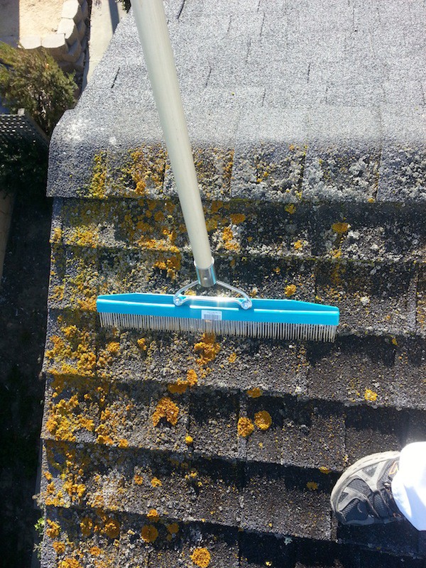

I had been wanting to try a Moss/Lichen brush that I saw used for carpet cleaning but it was a bit pricey. I found one cheaper at Ewing and gave it a try. Its epic, I'm totally stoked. I strongly suggest giving one a try. Here is a link to the cheapest price I found.
