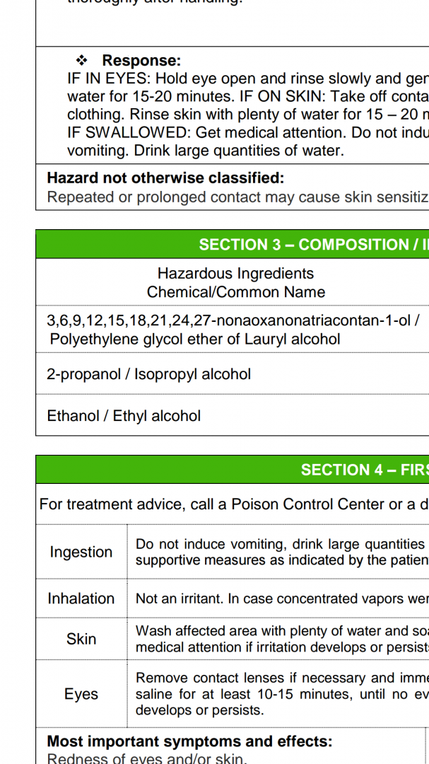

Art I know you are a fan on Pinellas Max whatever but I have a question.
It's main ingredients are alcohol based and hydroxide, alcohol killing mix and hydroxide a asphalt screwing up degreaser.
Are you using it with S/H?

Yes it has some Alcohol in it and I have Never had a problem with it on Asphalt. I have been using it for house washing for the past 4 years. It doesn't have time to kill the mix because I only use it for down streaming! Plus some guys here add Hydroxide to heat there mix in the winter to clean roofs.
