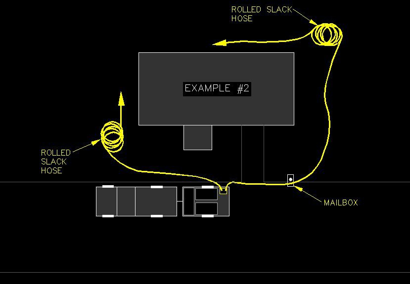

We carry rebar and when we are setting up I walk around and pin the corners . It only will a take 4 most times. I think it works well.
Eric, that is an awesome idea. The old "kiss" method (Keep It Simple Stupid). I will be adding a few 3' pieces to my arsenal. Thanks for that tip.

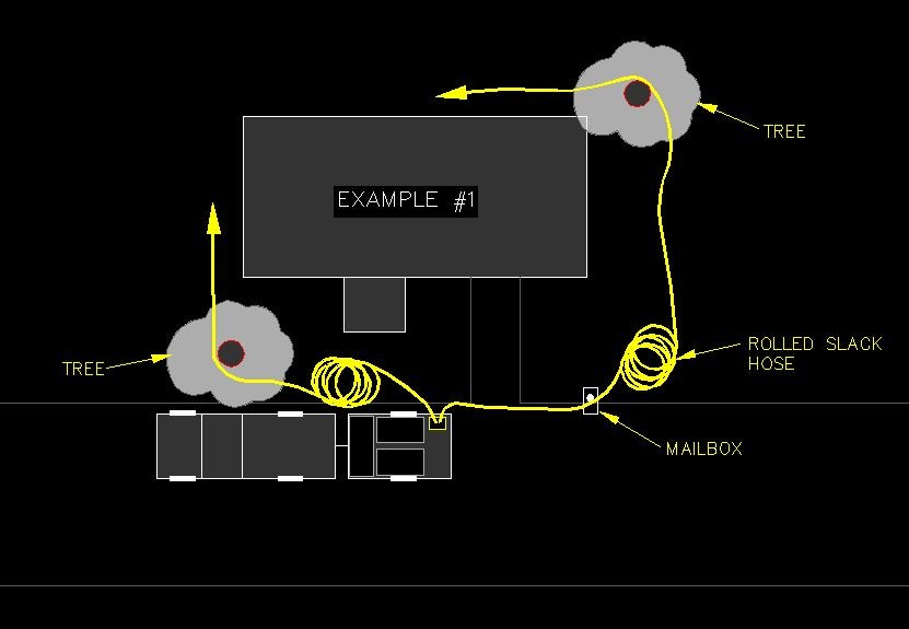

Here they are. With Erics suggestion of rebar, it would eliminate the need to hand pull slack to a corner in Example #2.(thanks Eric).
Example #1 shows how I like to use any object, weather it ba a tree, mailbox, fire hydrant ect., as long as the hose doesn't drag accross flower beds, mulched areas and any sort of ground cover at the corners of customers homes.
Feel free to copy and use these to hand out to present and future ground guys.

Low Tech but says we care. Probably need to be sure no underground wires, sprinklers etc but how simple. I am going to implement this for another reason.
It drives me crazy how easy for our roof and watering hoses to get tangled up. "You go inside, I go outside" sound good, but it still happens, so this may be the solution.

Our choice is to pull the slack hose to each corner and then proceed,..but we have also used 5 gallon buckets filled with water and set in place,..the hose will drag right around the big radius of the bucket, and also the plastic makes it drag easy as well.
