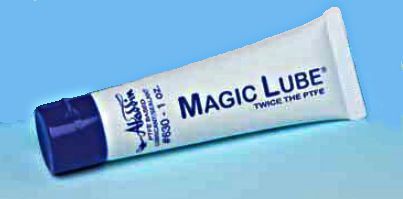

When I first started I used other products to lubricate my QC and some still failed. Then I tried Magic Lube. Great product and no failures over two years. A dab will do ya.

I found it at a local pool supply company but I'm sure you can buy it on line.

Hey Hank, I bet it probably does work well,..BUT,..I prefer something I can spray,Ha,Ha,..seems lazy I know.
