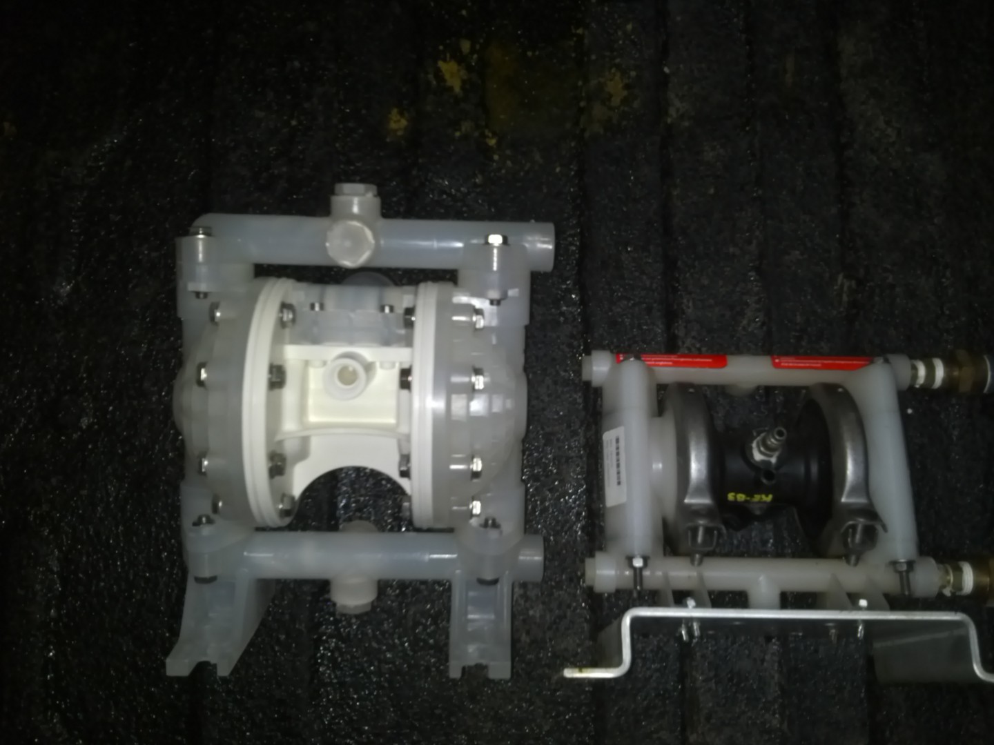

Just received my new 1/2 versa magic diaphragm pump. My 1st impression is it is double the size of my all flo. Now I'm concerned with the size of my compressor. I just figured there wasn't much difference in size from 3/8 all flo to a 1/2 versa magic. I will be calling them in the morning to find out the required cfm and if I have to I will add another 10 gallon reserve tank that I have laying around.

That thing is a beast, did you not like the all flo?

I love my all flo and Im still using it. The all flo worked all year with out one problem. I didnt buy the versa matic to replace the all flo

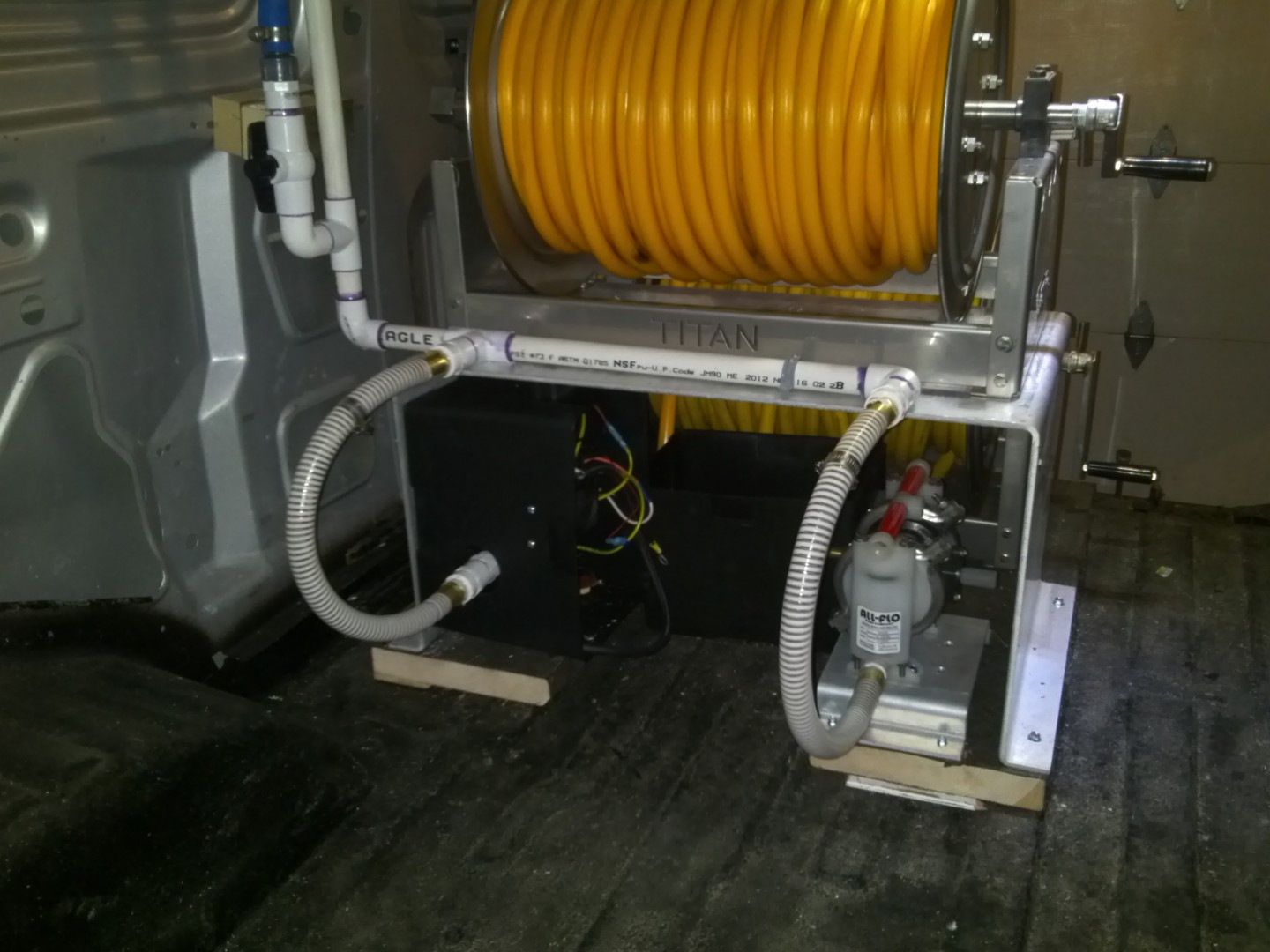

Im using the versa matic as a back up pump in case the all flo goes down but I also have it plumbed as a transfer pump for chemical and water. I can also use it to water bushes. The way I have it plumbed it has multiple uses. Sick of low GPM and water pressure and want to make thevan ttotally self sufficient.

Pat you should set it up,it is alot easier than 12volt. You could pipe it into the same hose reel and use 12 volt on small houses or early in the morning to keep the noise down. I still use my fatboy ,but on the large roofs or on the 3 roofs a day i stay on the all flo. The air compressor will do 3 roofs on one tank of fuel. Pat hear is a picture of how to plumb it into one hose reel.
