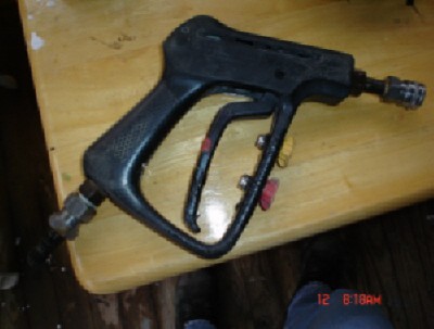

Speaking of those cheaper swivels and the talk about these trigger guns,..I found an old picture of an example of a modified gun. I still modify my triggers the same way,..with the exception of the cheaper swivel. The zero is in there for bees nest mostly and the yellow fan pattern just looks nice in there.

Jeff your like McGiver with all your inventions or maybe like inspector Gadjet.
Jan 25, 2014
Ha,Ha,..Thanks Brian,..It's a great feeling being lumped into the same category as those guys and their one of a kind ideas.
