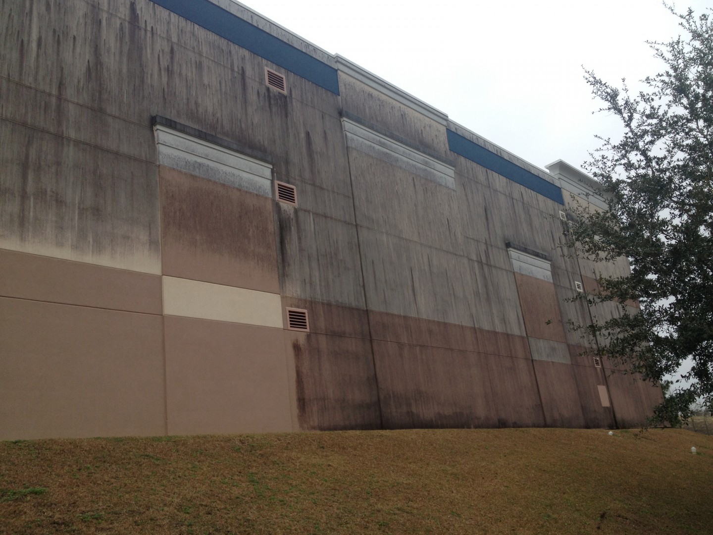

Cleaning this mini-storage facilty today. I thought you guys would get a kick out of the condition of this dryvit. You can see in the lower corner where me and my competition each did a test area.
he was DSing, with a PW, I was applying and rinsing with booster pump. His test spot took 2 hours, mine took 10 minutes.

Haha those results speak for themselves. Good one Ray!
Feb 3, 2014
Well there you go. That's something the customer will appreciate in more ways than one.
Feb 3, 2014
If he was really "competition" he wouldn't have been DS'ing dryvit. All he did was waste his time.
Feb 3, 2014
Wow that is bad. That's gonna be great when all is done.

Huge difference
Capital Roof Wash said
Feb 4, 2014
Dang you werent't kidding. That is some nasty Dryvit. That place isn't that old and I'm surprised it got that way so fast. Was that test spot on the north facing side of the building? Just about every case, the north side of a house or roof, the north side always the worst. Great job as usual Ray! Who was the other guy (if you don't mind me asking).

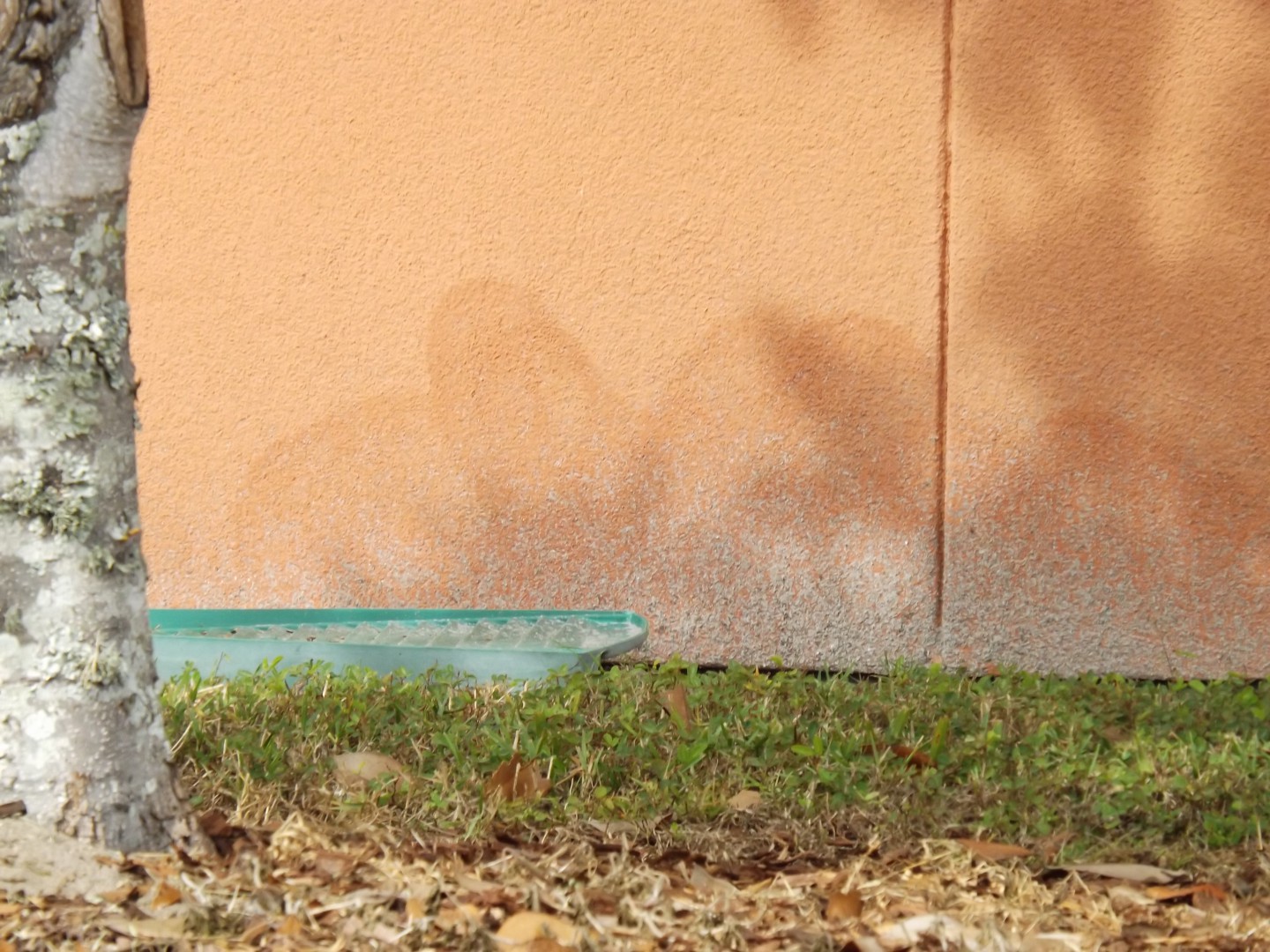

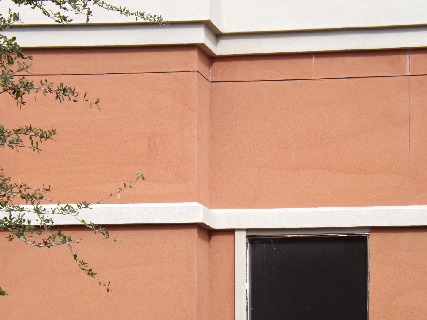

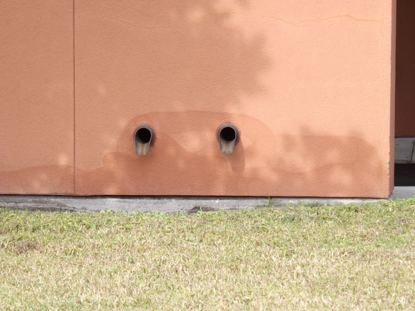

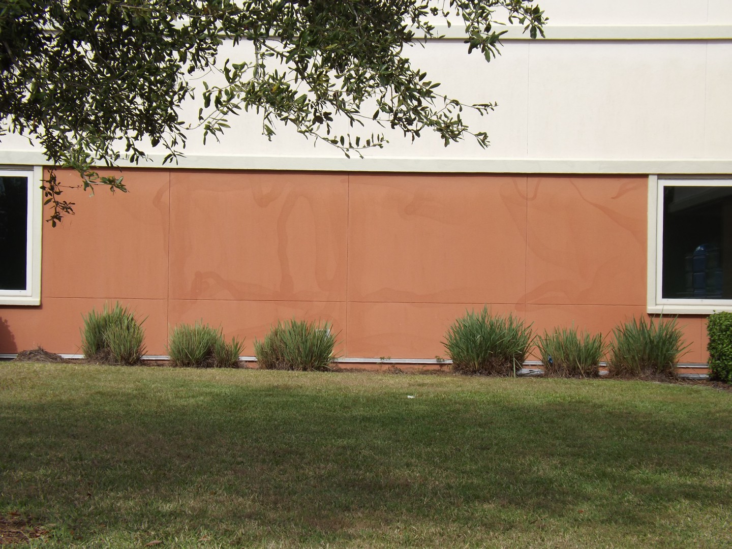

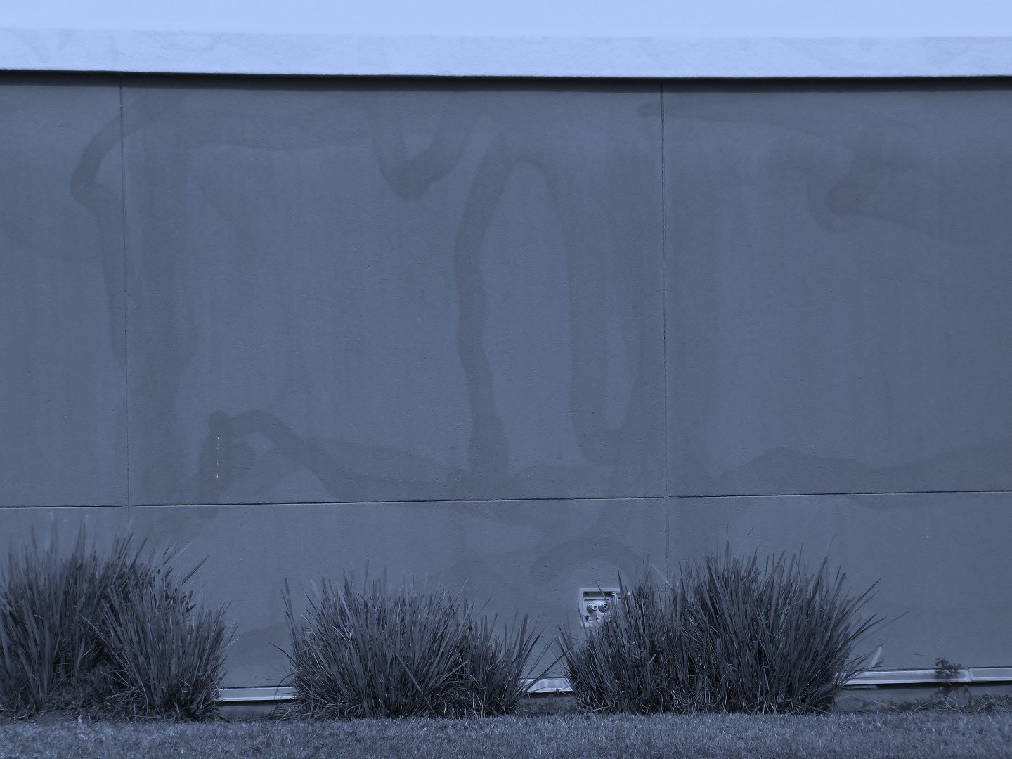

Here is the results from a GC painter using a rotary nozzle to pressure wash off the algae stains off the local hospital,,, looks like graffiti and now needs a new paint job,, which they ended up having to do.
So this "GC PAINTER" figured out a way to get two jobs out of the deal,..Ha,Ha,...
idiots.....
