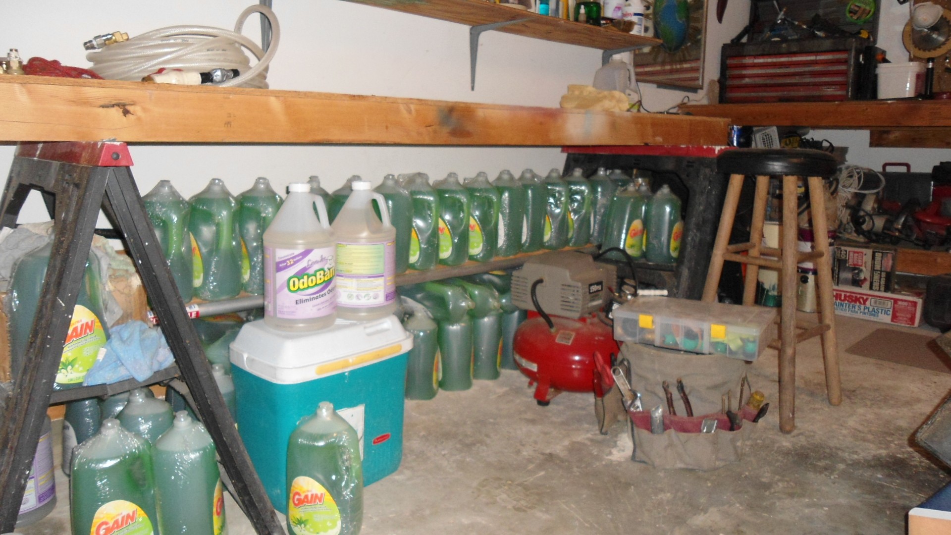

veddy veddy smhaaaat graaaas-hopp-aaaa ... see sumting dat mask owdaaah in picture above???
Home Depot ---- ten dowaaah!
$10 bucks a gal. ... 1/2 gal. treats 65 gallon tank of roof mix.
