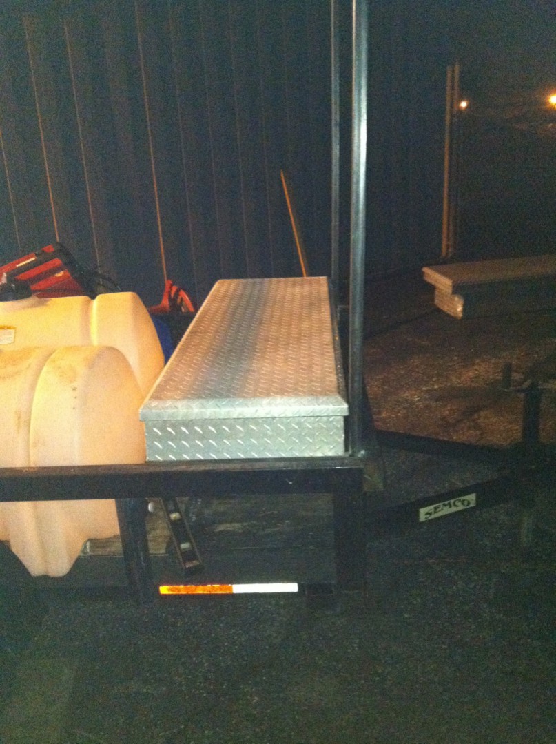

It's time for a face lift!!!! (new tool box on the trailer)

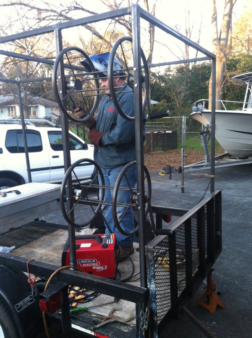

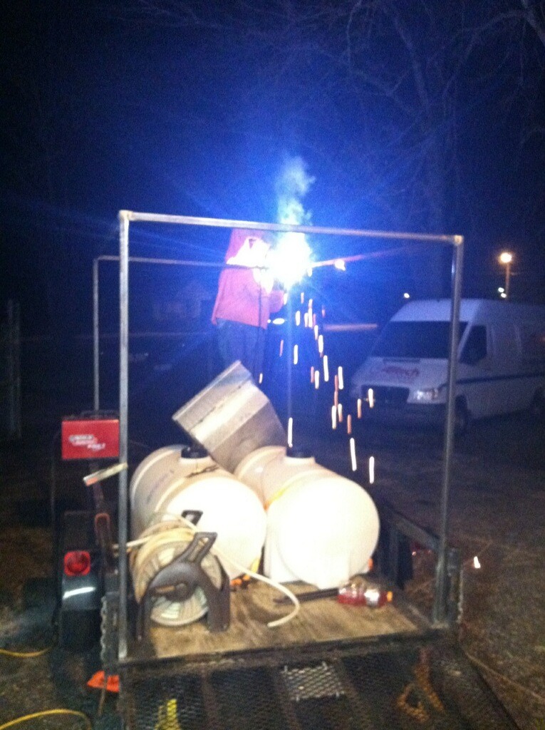

Getting the frame welded for the ladder rack in this picture. It's GAME TIME and no turning back!

Looks like you are having fun! I always loved building rigs, except when you are short something and you need to take yet another trip to the depot... Lol

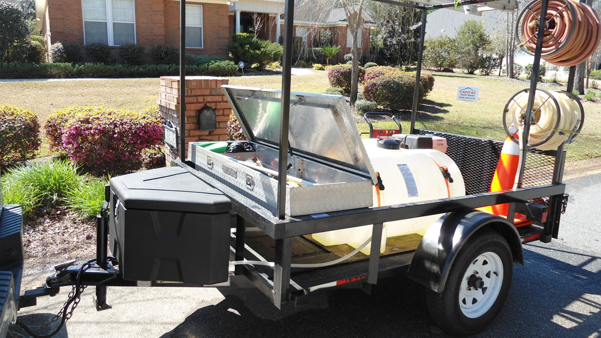

It's coming along and I have a few more pictures to take but these are the latest. I screwed up with the reel placement though. I should have put them on the right side but the new metal tubes have been painted and the tanks have been plumbed with new ball valves down at the bulkhead fittings. (before I used a poly braid/PVC down tube). Also, the chemical reel has brass manifold fittings and hopefully will last me through the season. It's a good place holder until I can fork over a few bucks for a Titan reel after this build. LOL
The top frame has welded eye bolts for the ladders up top and extention poles to be strapped down. The eye bolts that were drilled through the tubes on the first go around, were just asking to cause some stitches to the head! So we cut the threads off the eye bolts and welded the eyes to the top of the frame (I'll take some pics later).
I cut off 2/3 of the tail gate ( it's great to have a friend with a plasma cutter!) and added the diamond plated tool box. The box was smaller that the frame and it would have dropped to the deck of the trailer. So we welded a few 90's to the side rails and bolted it to the angle iron. I could have just gone with a full size box but I'm on a limited budget and had this one in the shop.

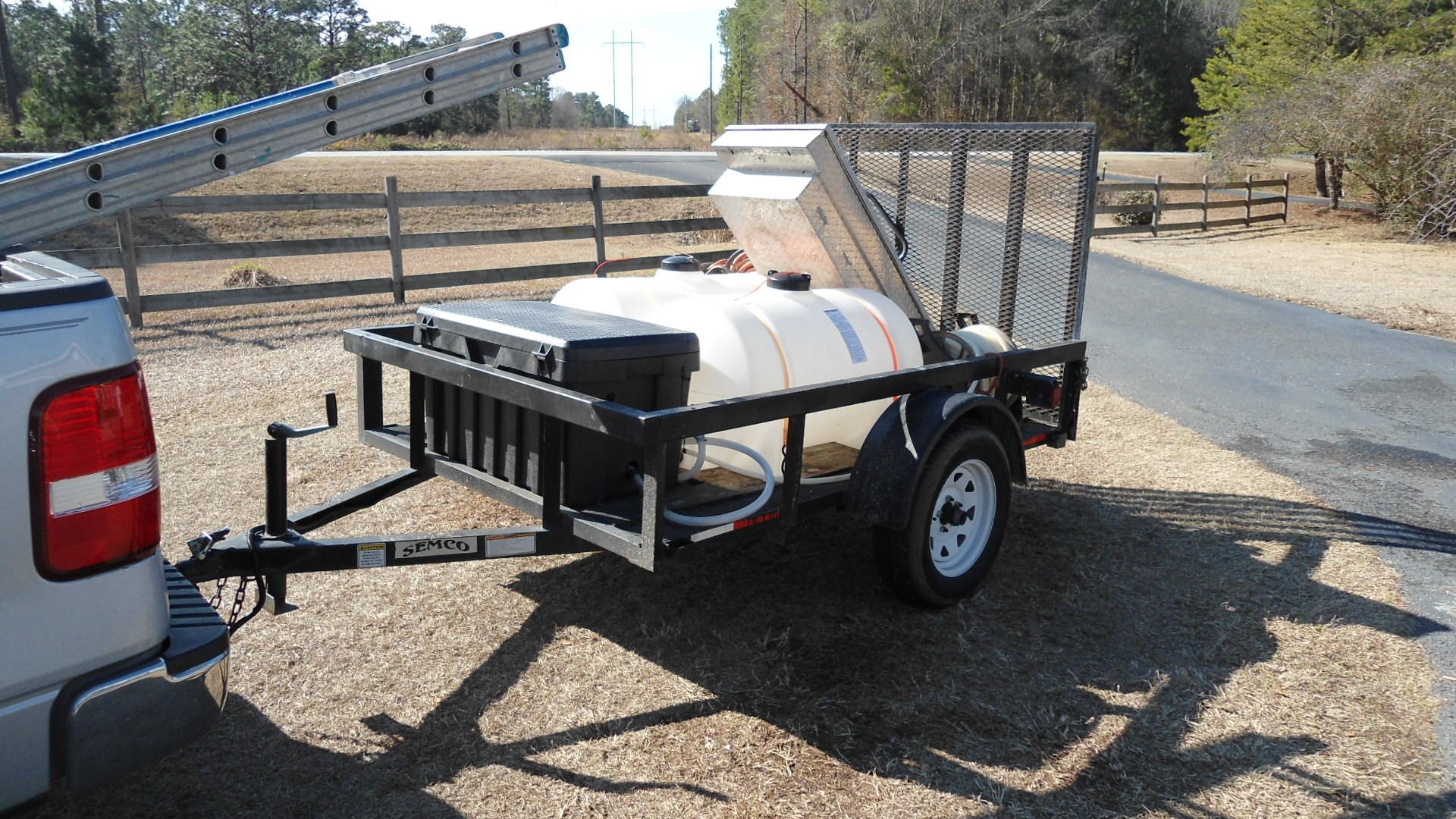

I'm adding a plastic, angled "Tough Box" that's made for trailer tongue's and that is where the pump and batteries are going. The diamond plated box wil hold fittings, pressure washing hose, wands, extra pump and misc. supplies.
I need to take more pictures of the build but here are a few. It's alot farther along than these pictures show and it's real close to start paying some bills.

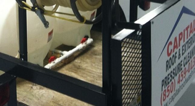

When I mounted the diamond plated box to the top of the rails, I was in a hurry and cut holes in the back of the box for the PVC inlet and the chemical hose outlet. In that scenerio, the pump was sitting about half the leg tank height. I wanted the pump to be level with the bulkhead fittings so the head pressure would feed the pump instead or the pump having to pull the solution from the tanks. That's how I ended up with the toungue monted box. It worked out in the long run because now I have a dedicated pump/ battery box and a dedicated tool box.

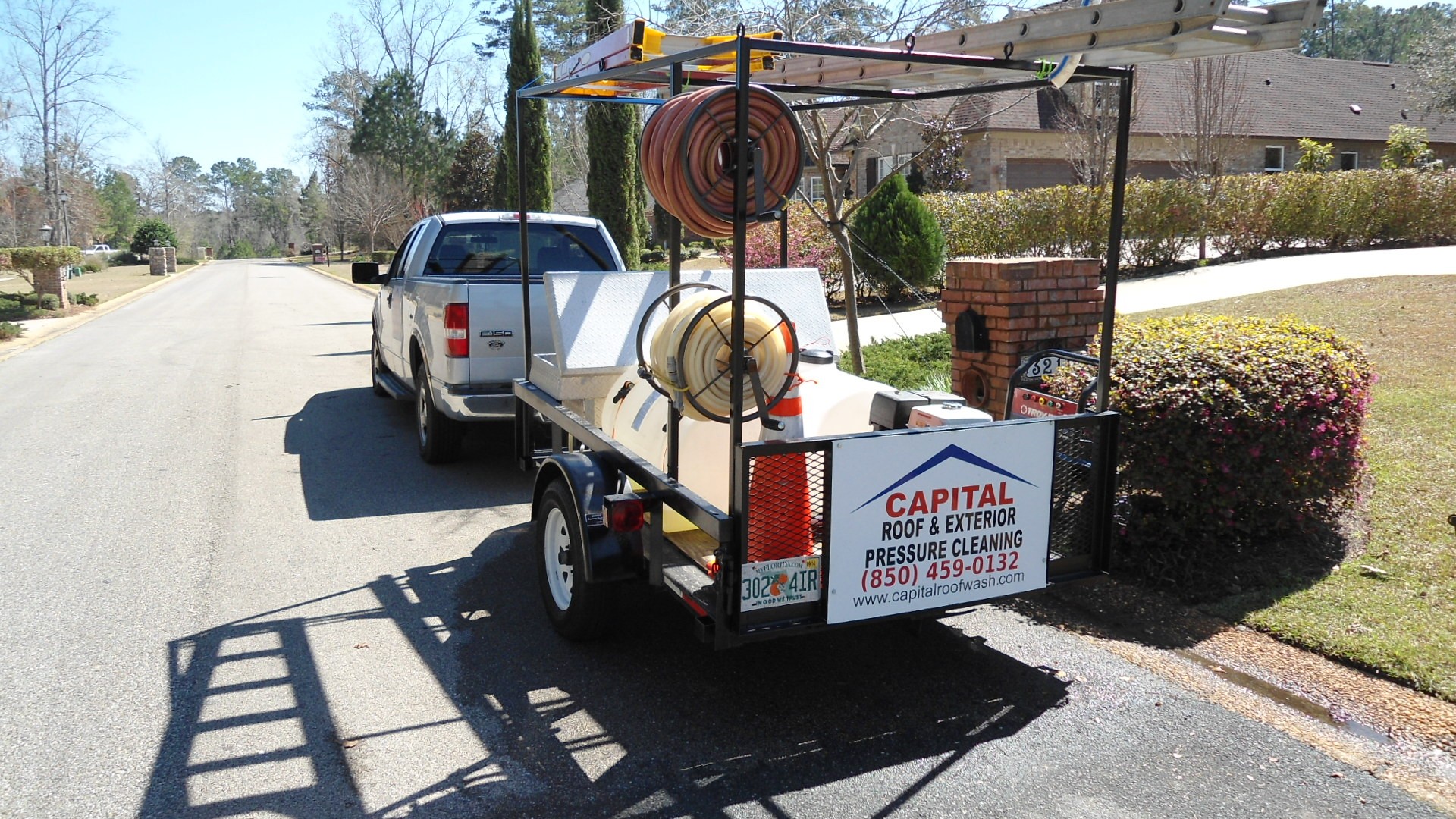

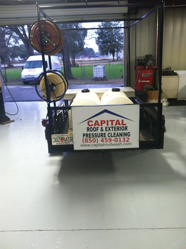

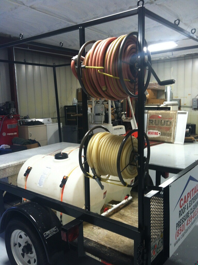

FINISHED!!! For the most part it's finished and needs a few odds and ends. I'm setting up an on board charger for the batteries so I don't have to pull them off the trailer to charge them like I did before. Now, I can just plug directly into the box and charge them.
I'm pretty anal and not comfortable yet with flying down the interstate (I-10) going 65 mph with extension ladders and pole brushes on the new rack on top. Before I had them ratcheted strapped, weighted down with pressure washing hoses, garden hose and other equipment in the bed of the truck.
Here's a few pictures and I'll take a few more of the dedicated pump box on the tongue of the trailer. I like the fact that I can now switch between tanks with a twist of a valve and switch between a roof mix and a house Soft Wash mix with a twist of a ball valve. Even better yet is rolling and un-rolling hose. It doesn't look like it but that is 225' of 1/2" poly braid on that reel (and 200' of 3/4" industrial garden hose on the other).

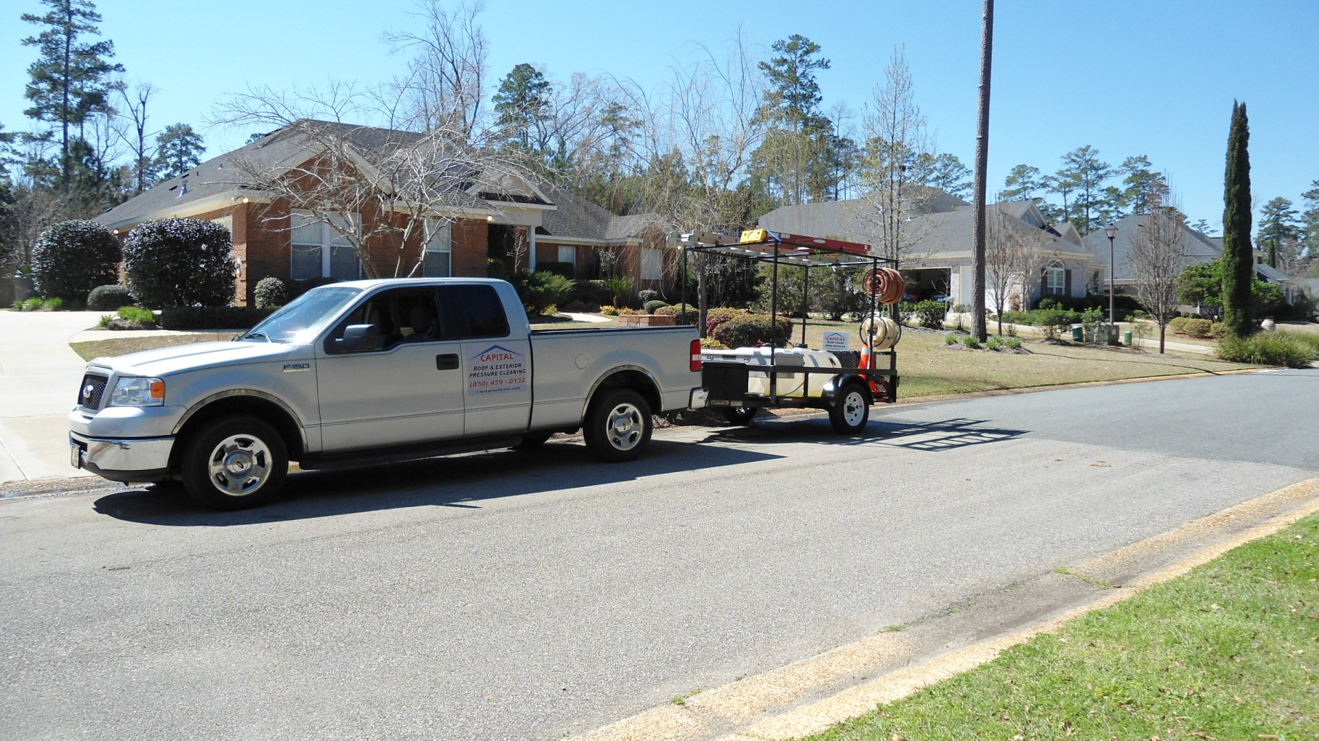

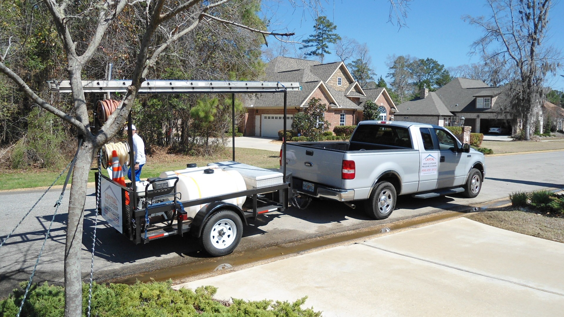

Here's a few pics of the upgraded rig starting to pay for itself. (Not to rub it in or anything but the high for the day was 71). There is a lot of wasted real estate on the sides that is beggingging for some signage. Doug Ruckers rig is giving me some ideas how to fill those voids though!!!
Trailer looks great Ray.. and the 71° comment was rubbing it in...
