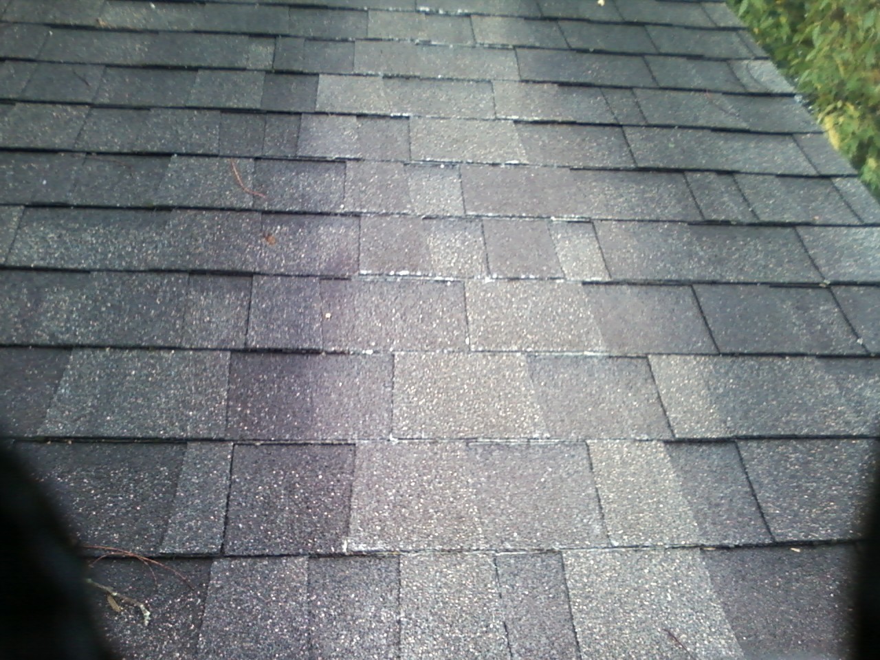

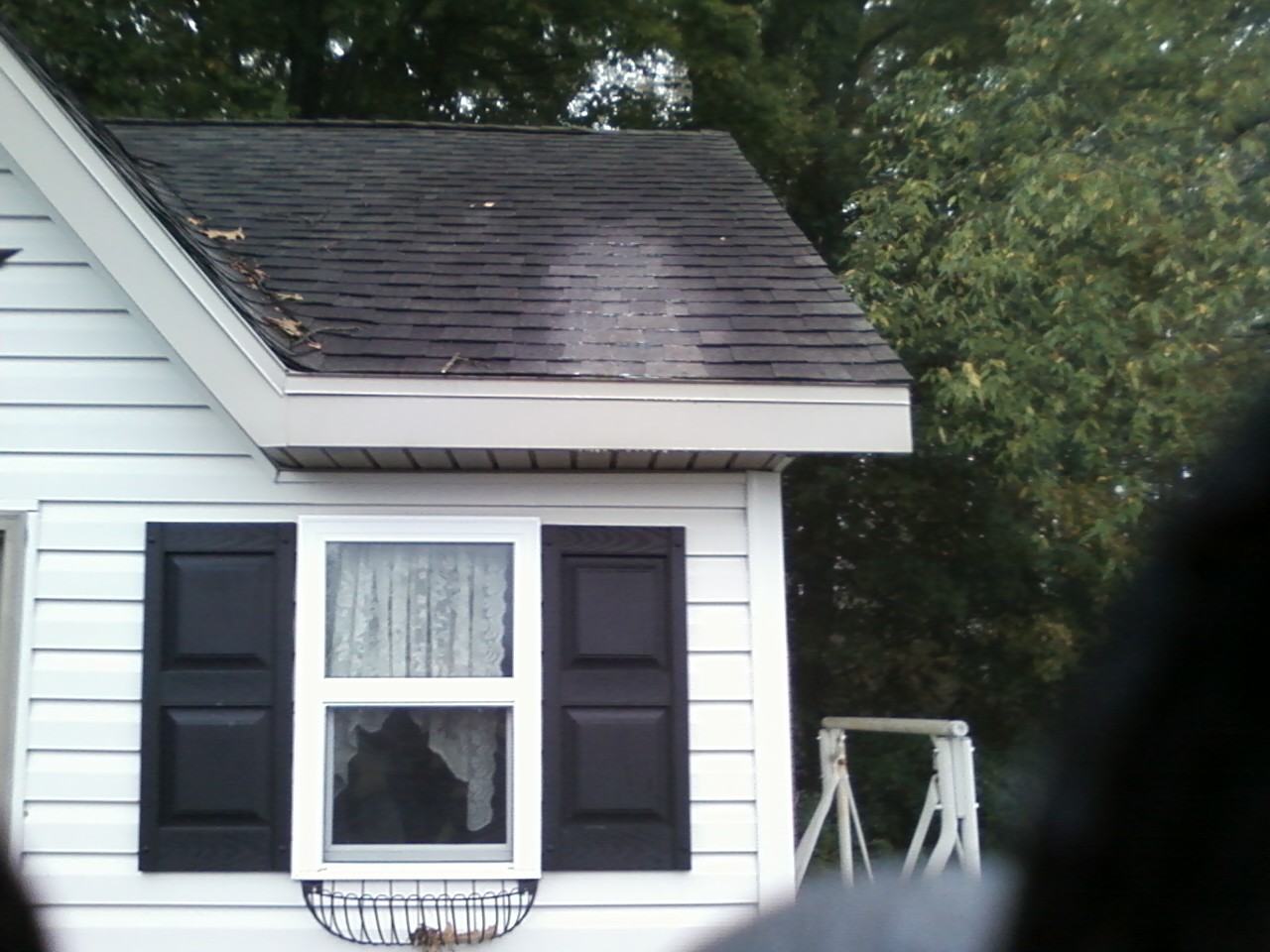

Ok,.back to the CH.
Ok,..for those who may be interested in Calcium Hypochlorite,..here is a picture of a test spot I did on a shed roof on a property today,..I was doing the whole house roof,..which was huge,..and while I was waiting for the roof to dry from the heavy fog we had here this morning,....I decided to hit a spot on the shed roof with Calcium Hypochlorite.
The mix was this: It was HTH from Walmart,..56%. I mixed 3 lbs. into a 5 gallon bucket of water and let it settle overnight,..then pump off the clean CH from the top,..letting the slurry of lime lay on the bottom. I use a small 12V 1 GPM pump for this because I don't want too much suction for fear of drawing the crap from the bottom. For testing I pump it into 1 gallon jugs to use in my 12V hand held spot sprayers I made.
So with my clean CH,..I added a basic soap,.Lauramine Oxide,..(AKA) Ammonyx Lo. I sprayed the spot you see in the picture and it turned this way in 5 minutes or less. Letting this stuff settle REALLY solves alot of the issues with all the hazing. Allowing it to settle and then use as you would a standard mix does work. I did it years ago and had been wanting to dig it back up again. And this is how I remember it working. Oh,.and this wasn't rinsed at this point.
*The recommendation on keep mixing it is severely misguided information! And having to buy activators and all isn't necessary. Anyone buying all those filters and tanks with agitators are really just wasting their money. It isn't needed. This is a simple mix I used,.with CH from Walmart.
I do know that all isn't made the same,..some use a different carbonate in the mix " Lanthanum carbonate" And is said to leave pools more cloudy if used as opposed to standard CH? Zappit 73% is the brand that has this Lanthanum carbonate.
Either way,..letting it settle gives a fairly clear,..yellow liquid,..stick your fingers in it,..rub them together and it smells like regular SH.
