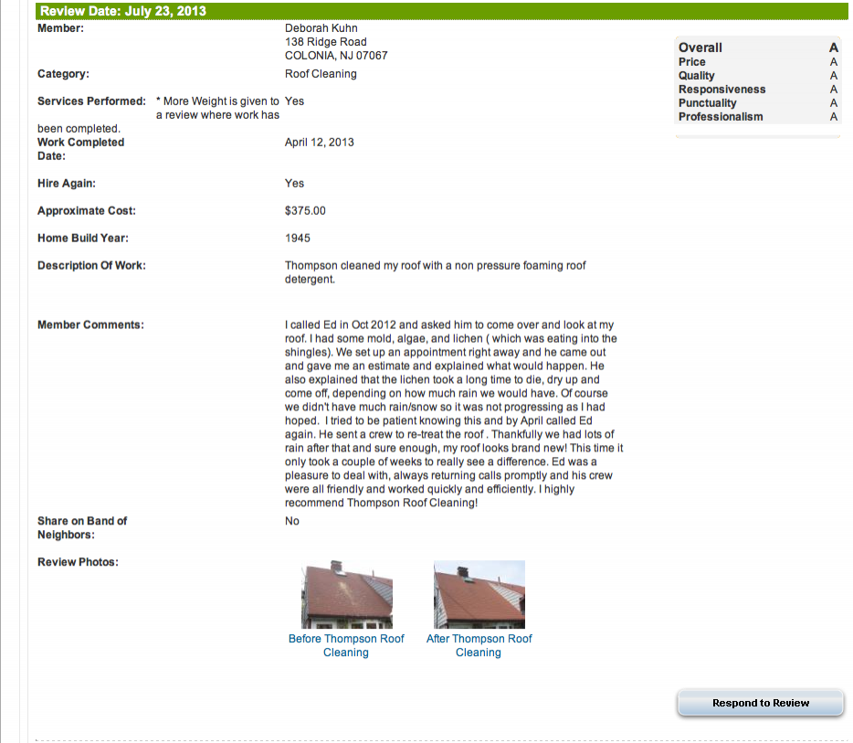

40 days is a little on the low side to inform a customer. People will call you on day 41 if it's not all removed. I tell them don't bother me for 90 days.
It took like 6 months for the customer in the review below.
I personally tell everyone 3-6 months. In writing!
