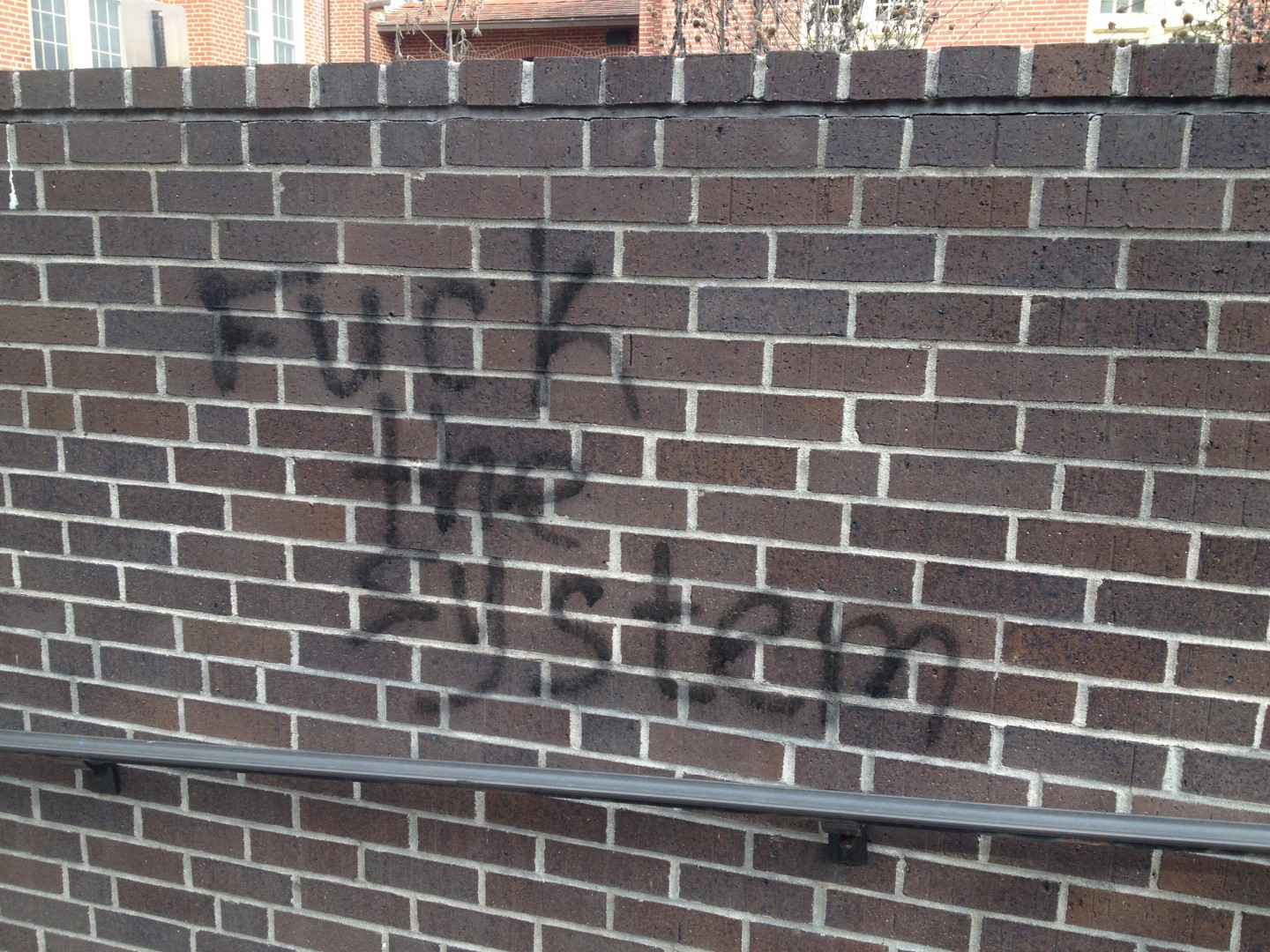

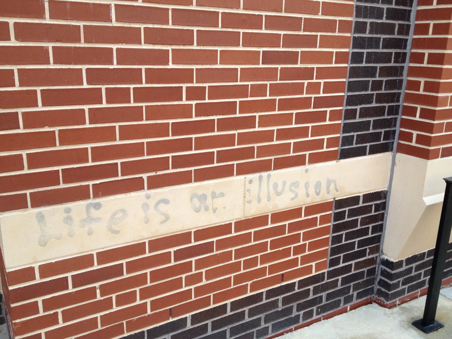

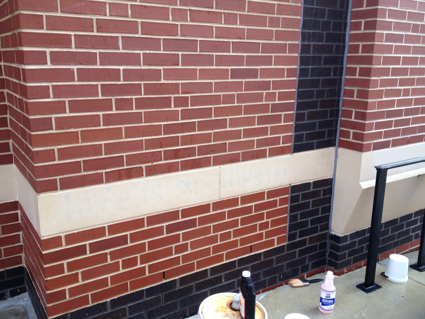

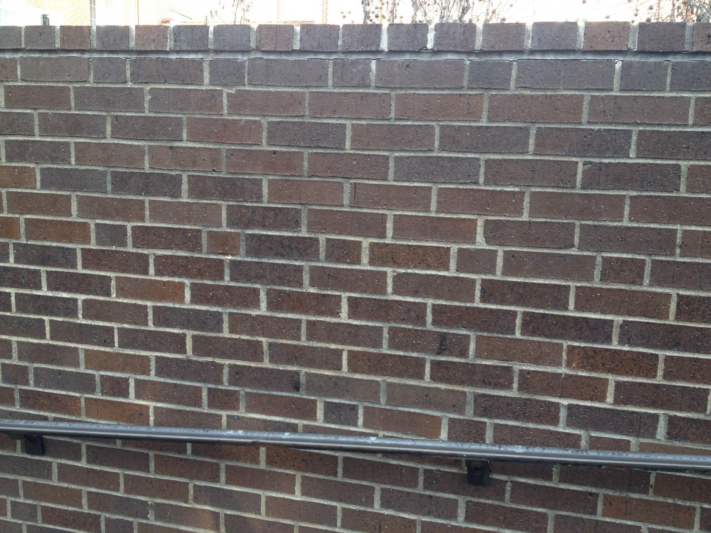

I can't let Doug Rucker have all the fun with graffiti removal! Spray wash received an emergency call today from Florida State University to help clean up the mess some Vandals had made. Ironically the facilities department had worked on the stains for eight hours and caused some damage to the precast, blasting away with a pressure washer. I wish they had called me first.
we used "worlds best graffiti remover" and it made a huge difference. Unfortunately nothing can repair the damage to the precast that an aggressive pressure washer caused.

When you get up close to the precast you can see its no longer "smooth"...the facilities guys attacked it with "the laser beam" ( red-tip)
