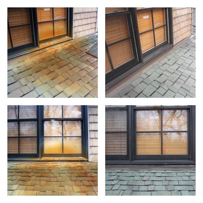

I bought a package of off brand of magic erasers off eBay. I cleaned this home on Thursday. Homeowner is still not satisfied with the glass. Im going back Monday.
What do you think a light scrub with one of these pads will do for loosening this scum up?

Be careful some of those magic eraser type pads can scratch glass and other high gloss finishes. Check the label first

We use magic erasers (whatever brand you get they are all melamine foam originally used as soundproofing for recording studios) and they work great on some things like silicone. If the "scum" is dried bleach or soap you may need something a bit more sturdy like a white scrub pad. Either way some vinegar or better yet a gel type stain remover will definitely help.

Ive been pondering. if F9 BARC removed the rust from this glass. Maybe it will work on dried soap scum.

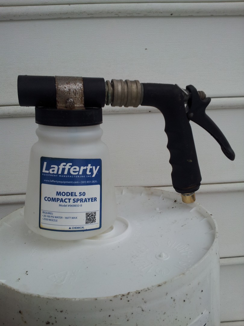

About three years ago I bought some One Restore. I spray it on with the bottle in the picture. I mainly use it on skylights but use it on windows that didn't get rinsed well. A little goes a long way. The Lafferty bottle came with a 5040 tip so I changed it to a 0030. It also has different orifices for the pick up tube inside the bottle. One gallon lasts me about a year. It will even get rust off the roof with light brushing.
That sprayer looks like a nice addition. Thanks

When I first used this we had skylights that looked like they went through a snow storm on the interstate. Sprayed all three, the nozzle has a quick connect to the tank, disconnect and rinse. Done! All three clean in less than 10 minutes counting going up and down the ladder! This system has saved us a lot of time and helped to please some picky customers.

Just make sure it doesn't dry on the windows or you will have a even bigger mess on your hands. Prewet the windows, apply the BARC, rinse before it starts to dry, apply a second coat if needed. Rinse thoroughly.

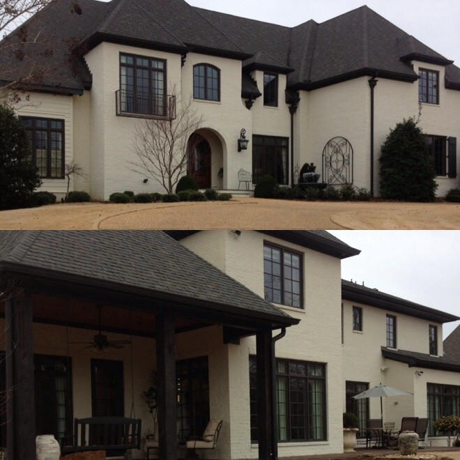

I went back this 35 degree morning to correct our little mess. This is a 5000 sq.ft. home the back side faces east. Morning sun broke through clouds an kicked us in the cods, apparently. The windows that had some dried solution were on the back and just to the right of covered porch.
For the bottom section I misted panes with window cleaner and used squeegee to remove then micro fiber towel to dry. For upper section I poured freshly bought vinegar on a brush then squeegee and towel dry with extended pole. Got Paid.
