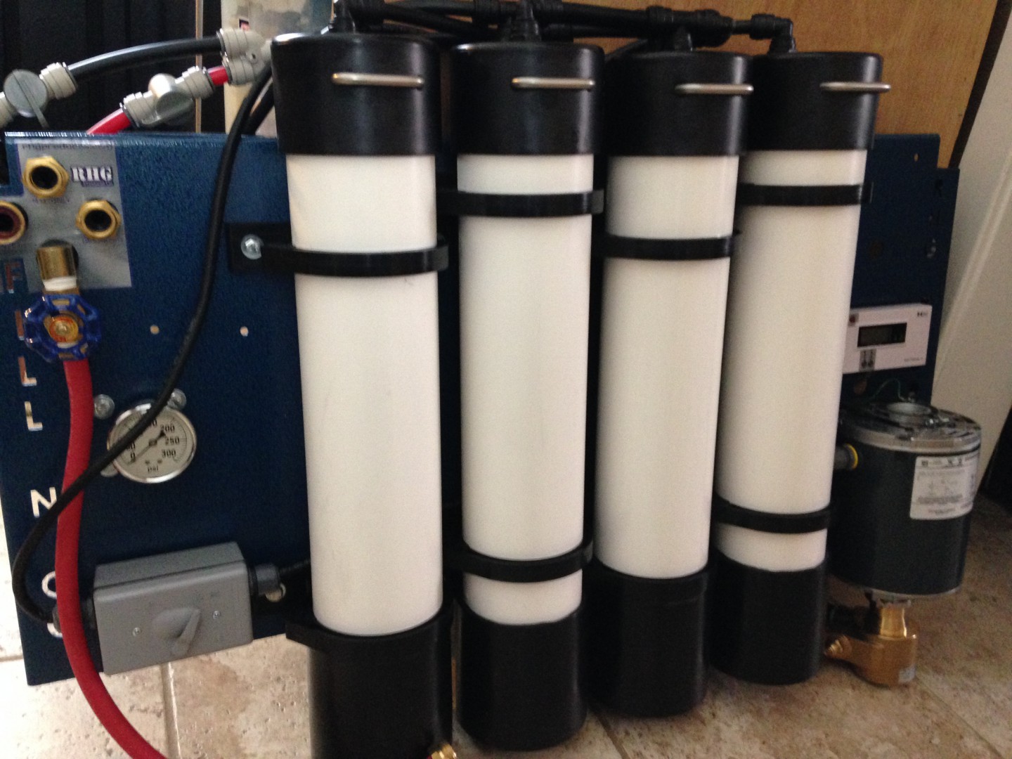

We have recently added a DI/RO water purification unit to one of our service trucks. We have used DI water before with our water fed pole and have achieved great results but have not used RO before. Any help with the uses/benefits of both DI and RO would be greatly appreciated so, I am better equipped to use this as a selling tool too!

For window cleaning we need as close to 000TDS as possible for spot free results which is why most of us use DI or RO/DI. When doing softwashing the RO water will make you surfactants go further since water hardness results in needing more soap to get the same results. Since the surfaces you are cleaning don't require the same spot free results as windows then RO is all that's needed. One other benefit for the surfaces you are cleaning is during the rinse. Less minerals afterward to dry on the surface you just cleaned.
