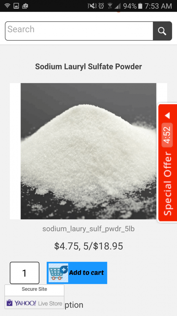

Posting this here so not to start new topic. If anyone is curious of SLS if hazardous
SLS pure powdered form
"Biodegradability --Product is readily biodegradable"
"Product Description
Sodium Lauryl Sulfate Powder is often used as a foaming agent in many common products: Bath products, shampoos, foaming powders and more
Highly Active, high quality SLS Powdered sodium lauryl sulfate. Useful in powdered or tablet or blended liquid hard surface and carpet cleaners, powdered bubble baths, and cleansing preparations, scouring and foaming agent in textile and industial applications Also used in powdered hand cleaners and powdered bath preparations. Even used in liquid hand soaps and shampoos." AND marshmallows
-- Edited by Maverick Contracting on Wednesday 1st of February 2017 07:56:07 AM
AND marshmallows
