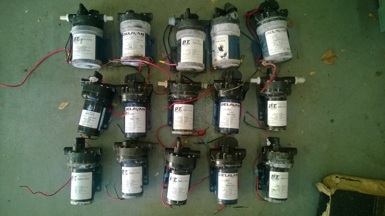

You mean these things in the picture Lee? We eat them for lunch I've added a few more to the graveyard since that pic was taken.
With multiple trucks, and multiple tanks, time is money hence considering taking the plunge. I have no problem doing so if it'll stand the test of time. They're designed for corrosives, but only have a 1 year guarantee "against defects". Hence trying to find out if anyone has had them for any length of time. At least they're modular, ie the motors run about $400 and the pump that I'll need (for a large vat) runs about $1200!
wow thats alot of pump... I can understand how the insides would wear out especially if they are not rinsed, but how does the outside get that corroded?? The only problem I have ever had was the in-line fuse blowing.. And I have had maybe 3,000 gallons of 12.5 through one pump

They came off of the trucks Lee, and we abuse the heck out of them. Very seldom do the ever get rinsed. Most of those in the 'pile' are salvageable though. I just need to set aside some time to go through them. (When a pump on one of the rigs acts up, if it can't be fixed in about 5 minutes, it gets replaced - all in the essence of time/production.) We're about to take delivery of 1200 gallons of SH at a time, so I'm looking for a fast way to transfer now hence the research on Thompson. 30+ gpm vs 7.

Ted it might be worth it to rinse the pumps out everyday. It only takes 5-10 minutes.

We should do it daily Mike, but seldom do (I even have them plumbed for rinsing with no power required). We work until dark almost every day (5-10 roofs / day) and after a loooong day, I just don't bother with them. I sell more jobs instead Most of the pumps in that picture can be fixed. I just need to set aside the time for it.

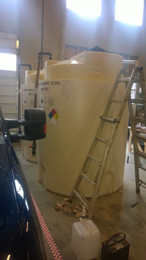

1200 gallons of liquid gold (SH) has been delivered!
