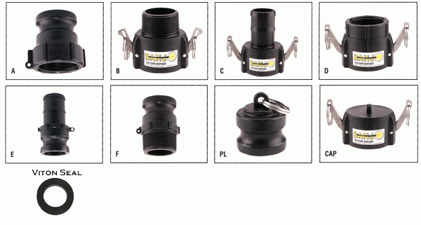

BANJO poly connectors are what I use
I'm sure you can get them around here. They are widely used in industry.
I believe I got them from JMEsales, looking for recipt now as I need more
http://www.jmesales.com/product/34-polypropylene-cam-lever-couplings,5911,7170.htm
I use 5/8 hose but ordered 3/4 couplers so interion diameter was the same.
Had to heat up end of hose to make soft enough to get on. These are used in agriculture the oil industry ad anywhere chems are involved to give a failproof seal.

failproof sealing. edited my post
Art my bad. that link was for th4inch ones heres the 3/4. $1.28-1.41 each
