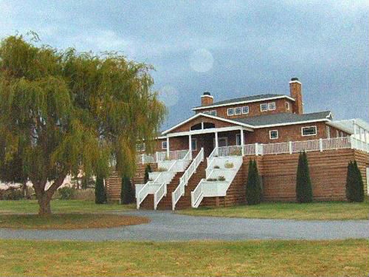

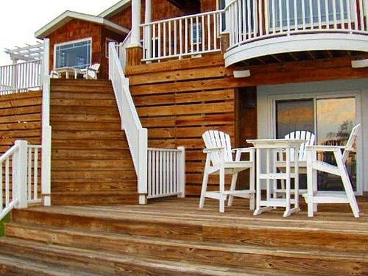

Got a call from a guy wanting to clean and do a natural cedar tone sealer on the entire house.... cedar siding,decks,steps garage,horizontal wood around the base.. a 3 story home with tons of stairs and 2 chimneys... job looks hugeee..
ive never done a wood job of this size. im thinking around 1.85 a sq ft since its such a big job.. any input would be nice ...
Lee I think your one of our main Cedar Guy's here. How do you plan on doing this job. Are you going to strip the stain or just hit it with S/H. The job looks on the tuff side. Make sure you charge a premium price and keep us updated on the project. We are all interested in cedar cleaning. Your work always seems to be top notch. Good Luck with it.

This is actually some pictures that I pulled off the internet when they originally bought the house about 5 years ago- it had just been cleaned and oiled. There is currently no stain on the shakes or decking so we will come in and clean with a light house-wash mixture followed with lots or rinsing and oxalic acid on the shakes followed by another rinse... after 3 days or so of drying we will return to finish the wood. I normally do not seal cedar, but after informing the homeowner he said seal it, he doesn't want to have to pay this bill every few years. The home is right on the water and takes alot of abuse from the salt and hurricanes, so I can see the benefit of sealing the wood, and I can't say no! Still trying to work out a price.. When I return to measure when its not raining ill take more pictures!
