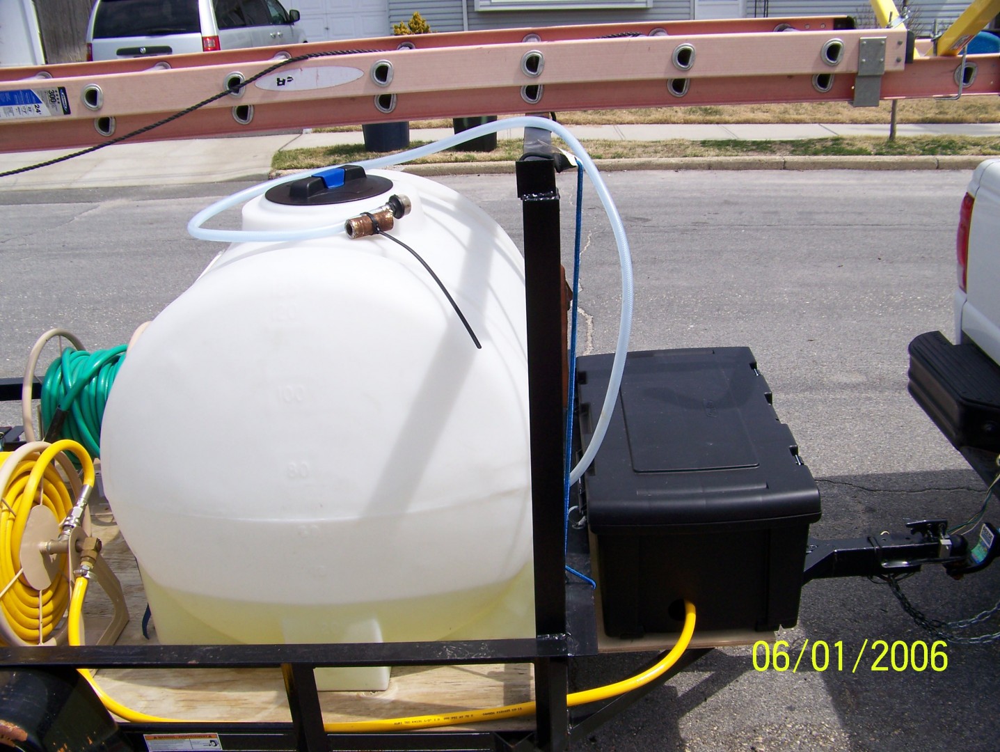

My current setup uses a hose from the pump that i insert into the tank from the screw on cap on the top. I would like to insert a bulkhead somewhere on the tank that i can use for the pickup line. So i dont have to insert and remove the pickup hose at every job. it would always be ready to go. and save a few minutes.
two issues I have:
1- I like to rinse the system with fresh water at the last house of the day. right now this is easily done by placing the intake tube in a 5gallon pail of fresh water. I usually run 7 gallons through the system to be sure
2- I've heard a few times that bulkheads should not be used at the bottom of the tank because they're prone to failure. And the top of the tank is for the most part round.
Any suggestions on how i could simplify this process and achieve both. Id like to do this without breaking the bank either.

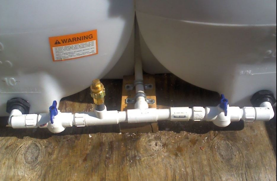

ray i have the same style tank. you dont have a problem with the bulkheads on the bottom?
Zach Maynard said
Apr 23, 2014
Half of my tank are bulkhead on the bottom... I never had any issues until recently The threads had cracked on the bulkhead. I believe it was from handling and storage though not from chem deterioration.
Apr 23, 2014
In 4 years i've probably replaced 2 bulkheads. About once per 1.5 years I totally strip trailer down and reweld/repaint/remodel. I have more of a problem with PVC breaking than I do bulkheads. Will be going Flex tube during the next breakdown.

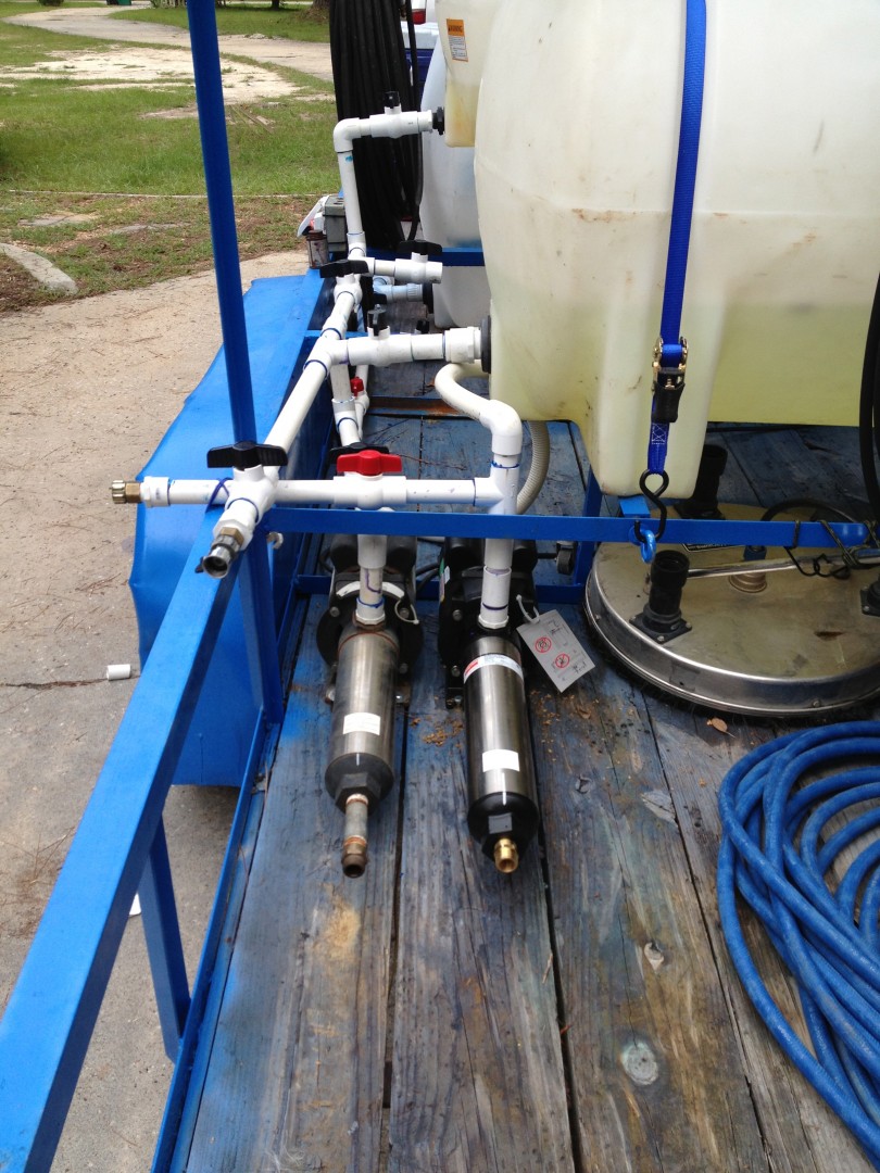

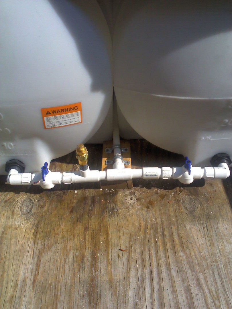

Erik, perfect timing on your question because I just retrofitted my rig last week. I did a total overhaul last winter and plumbed the bulkheads to eliminate from drawing from the top with a draw tube. Only problem was I wasn't able to rinse the pump every day like I did before. Within 4 months, my 5850 was on it's way to Delavan heaven.
With a little bit of thought, a pad of paper and a few carbonated beverages, I came up with this! (picture below). When I am finished at the end of the day, I close both ball valves and screw on the garden hose to the fitting and rinse away. It's just a tee between the ball vaves, with a female garden hose fitting. In the top is a brass plug so no debris gets in the line when not in use.
-- Edited by Capital Roof Wash on Monday 28th of April 2014 09:15:01 PM
The only thing I think everyone should be considering is using 3/4" clear poly hose, instead of PVC pipe. It takes the humps and bumps easier and does not leak at fittings much. Worst thing you ever have to do is tighten a hose clamp. Just my opinion.

Two comments on your comment John. First is, it was a great idea but the pressure from the hose does not let the pressure switch kick in and the water just flows thru the pump without running. I want the pump to cycle during the end of the day flush. To fix this, I have retrofitted a 6' length of 3/4" poly to drop into a 5 gallon bucket (pictures coming soon).
As for your 3/4" poly braid hose comment .... you must have been reading my mind because that is what I was thinking of doing but stopped short just because I had the parts and needed to get it back together before I lost a few jobs. LOL
I traded some Soft Wash work for welding and re-plumbing of the tanks and when I got it back, it had the 1/2" PVC line going straight to the pump. Previously, I had a 3/4" drop tube and from day one of getting the rig back, that is exactly what I wanted (3/4" poly). It was my fault because I didn't specify the size/material.
When the ball valves start to stiffen up (even with schedule 80 pvc), I'll cut it all out and replace it with the 3/4" poly.
Thanks John for bringing this up and letting me explain my learning curves and to help others down the road! This is what the forum is all about!!!
