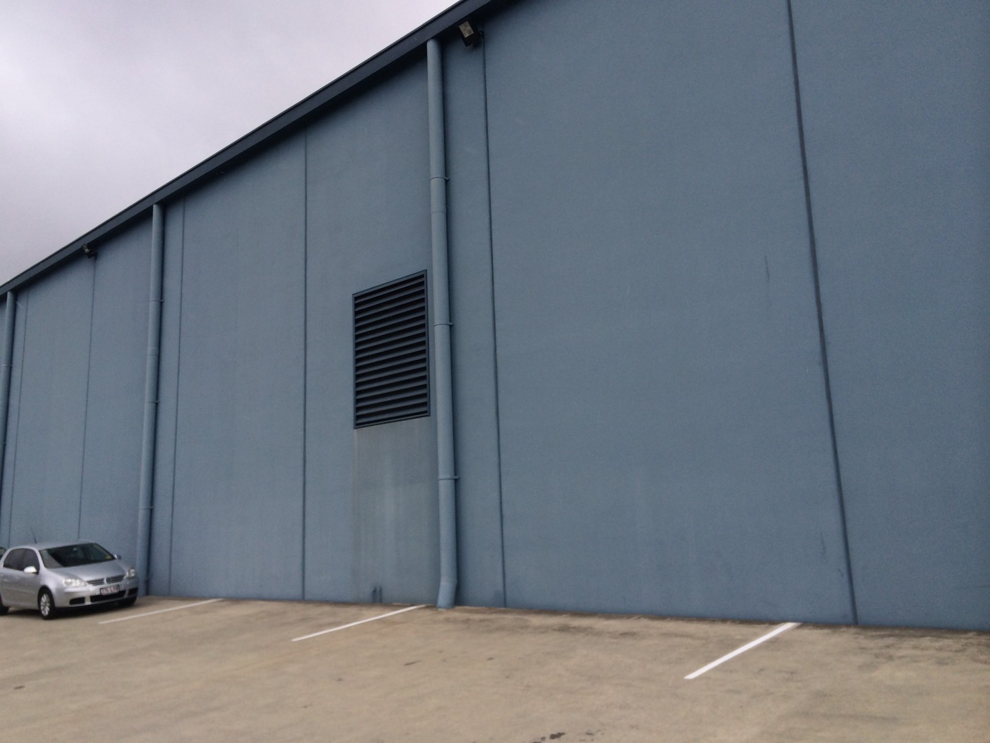

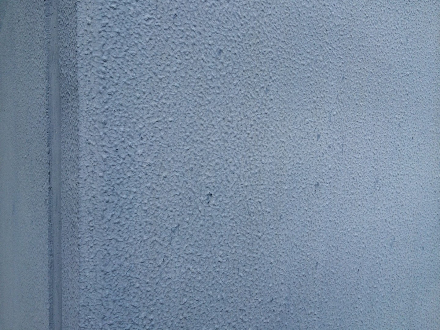

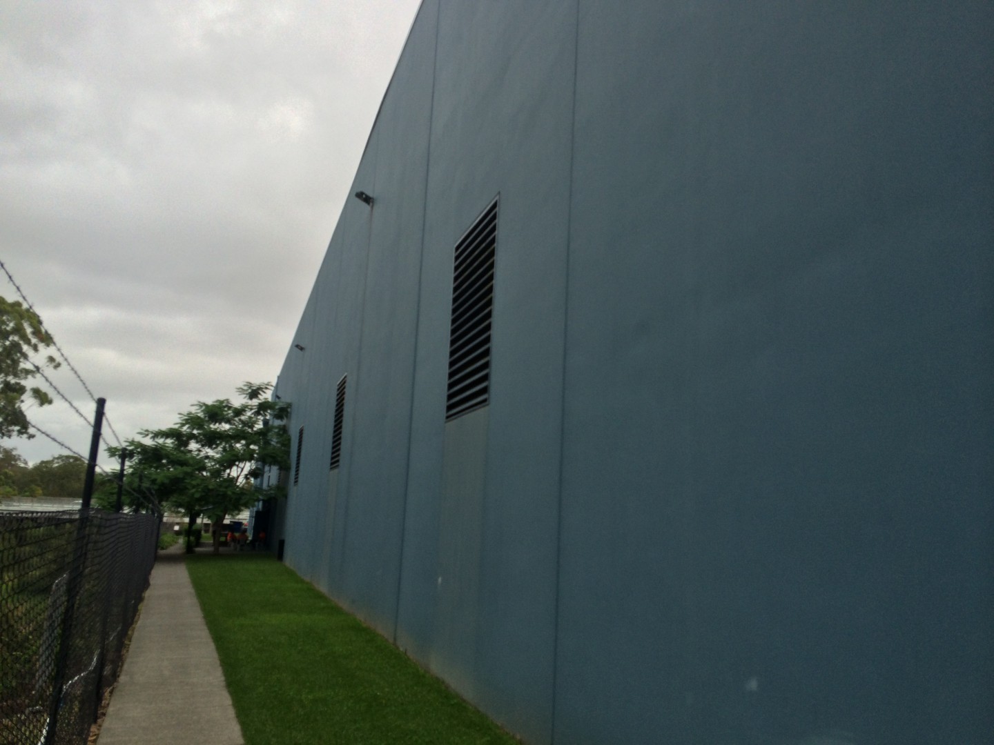

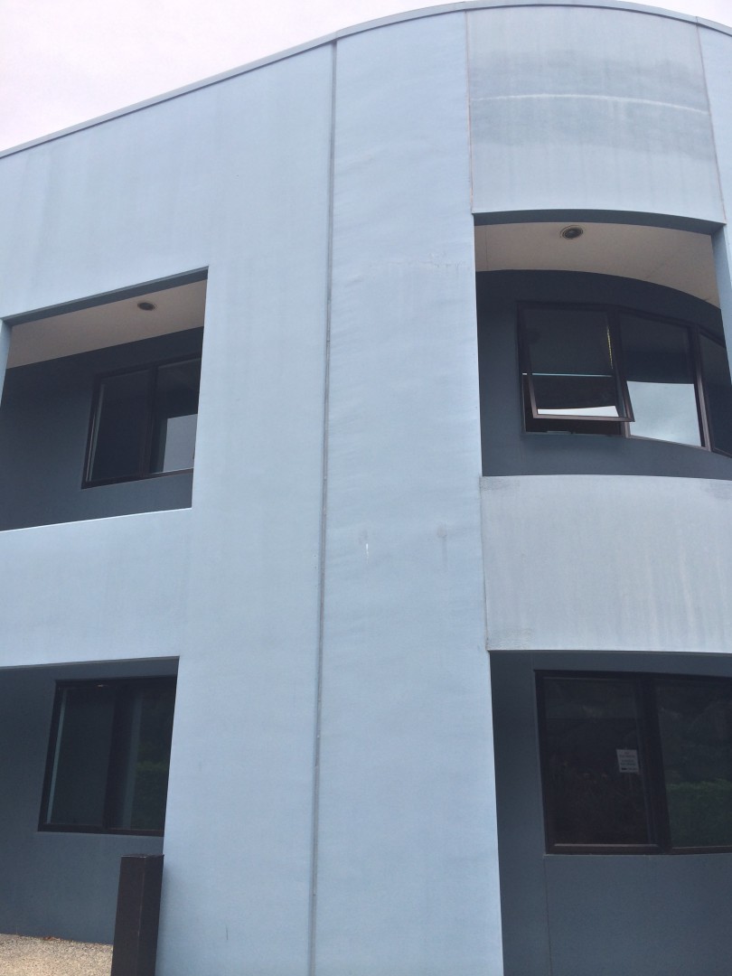

Hi Guys. I hope you may be able to assist with pricing this one up.
See photos attached.
Total vertical surfaces clean in preparation for painting. Total 150 000 sq feet of walls. Client to provide all lifting gear.
Questions.
Will softwash remove frosting oxidized paint?
Will I need to pressure wash as a rinse?
How would you approach the job?
Price?
How long would it take with 1 Crew.
Any assistance is greatly appreciated. The hardstand is all really flat so height access is good. Its just a physical approach and guide that i really am after.
I doubt a soft wash is going to get much of the oxidized paint off of there. Maybe if you used something like the f9 gutter greened product, but I've never tried to spray it on such a large project.
you are going to need to PW this to get rid of flaking/fouled paint.
I would get a 45 SP lift, for quickness.
Depending on how much "flaking" you have during rinse I'm seeing 4-7 day of work here.
The key word you said (to me at least) are 'Paint Prep'...some GC and painters are very meticulous about have ZERO chalking form old oxidized pain before repainting. Its a harder beast to tame.
Questions.
Thanks again.
Nick
