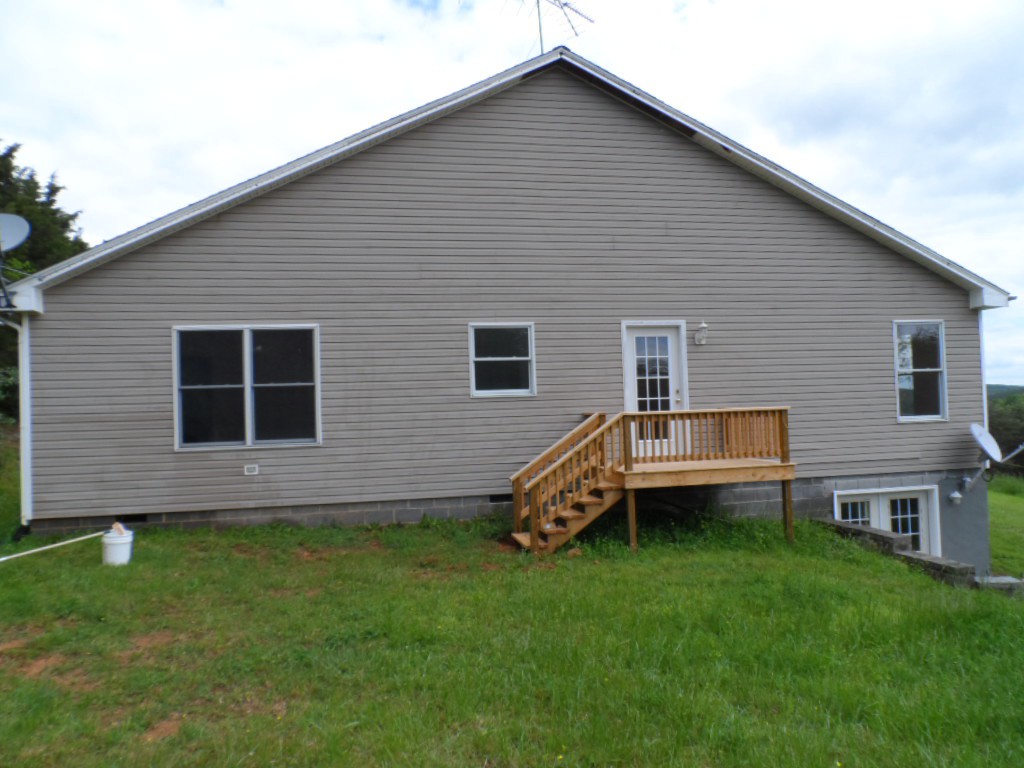

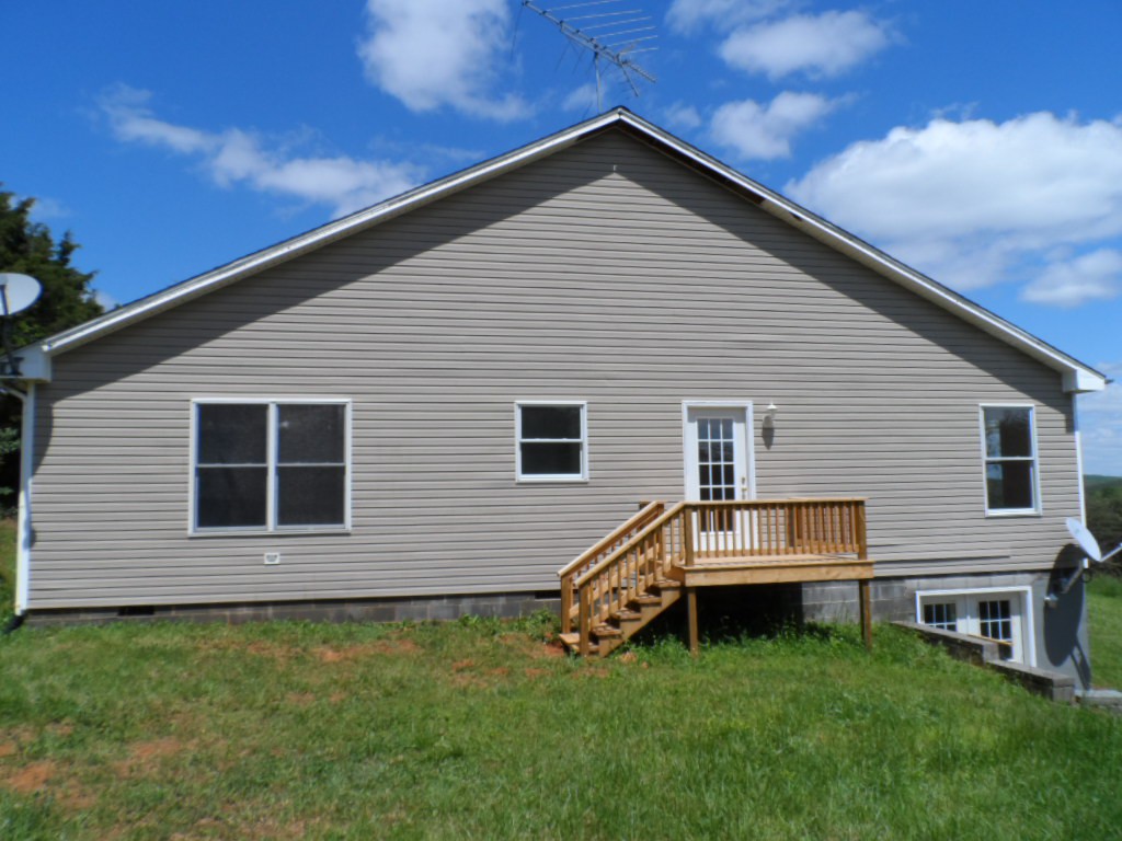

We just did a house that had pressure washer marks all over. My initial test was my favorite, One Restore. It did a fine job. I didn't have enough on hand but did have Deep Clean and was impressed with the results, as was the home owner. We sprayed it on with a back pack sprayer and brushed, when the house was finished we cleaned all the siding and metal as usual. I'll post pictures later when I get to the other computer.
Pictures added... the originals you can see the marks in the before pictures much better.
