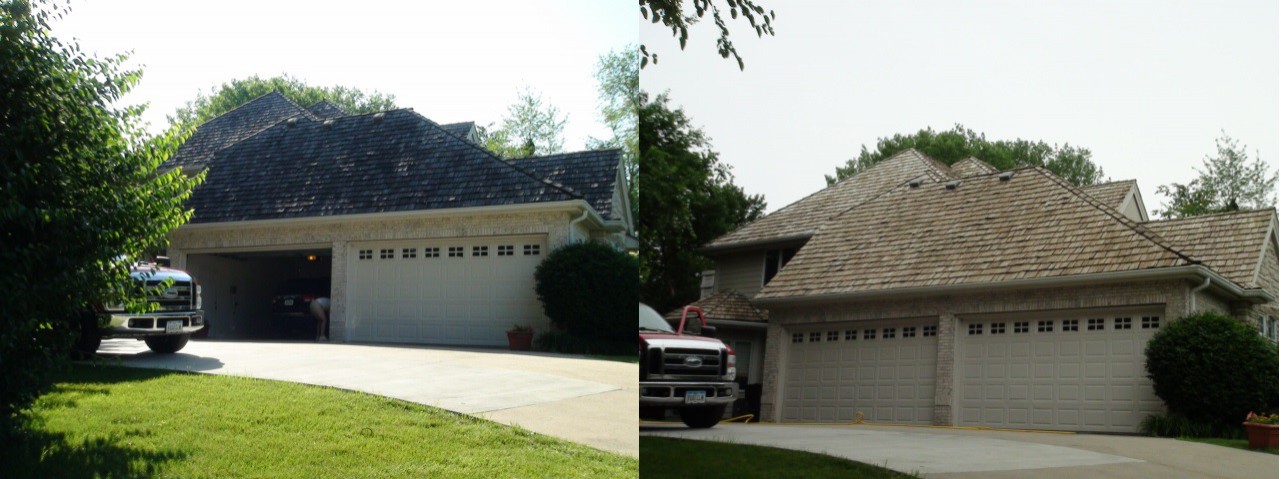

I have noticed that many cleaning cedar haven't considered the factor of tannin. Cedar is among a group of woods ( like Cyprus, Redwood and Mahogany) that have a natural acidic chemical called tannin which is caused by moisture in the wood. Tannin is water-soluble.
Here is a cedar roof we just cleaned that had a lot of tannin, combined with brown rot fungi and other infestations. What many miss is the proper cleaning of tannin ( those using SH will find it doesn't remove tannin) and when the roof dries from a cleaning it will look like a checker board. When first cleaned a cedar roof always looks good but a few weeks later will have a completely different look. On a cedar roof the tannin will have a black look to it. In most cases some section will have it and some won't because of the moisture content of the cedar roof. Just food for thought

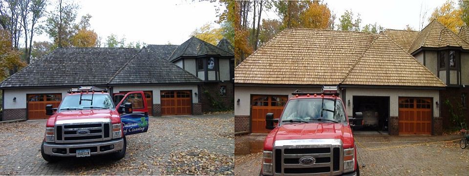

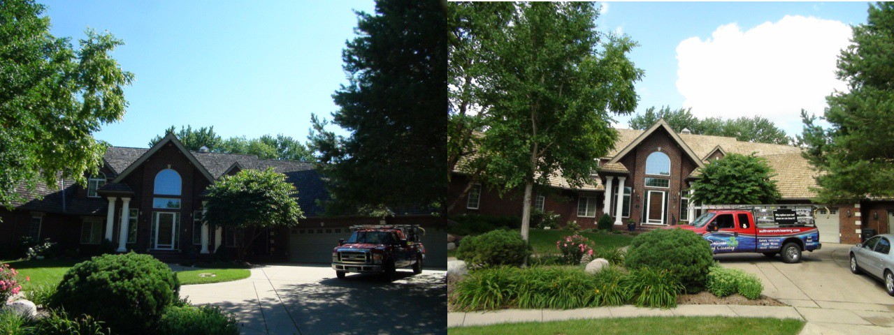

Here is another example.

Tannin stains disappear during the second step of a normal cleaning,..cleaning first then neutralizing with oxalic or ox-citric blend. Nothing to worry about really, even if it takes a second application. High PH cleaners will also cause tannin stains to become worse during the first step of cleaning,..but as stated, the neutralizing will remedy the issue.

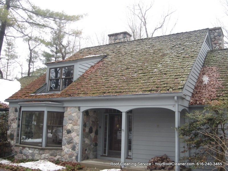

Here is our next Cedar roof cleaning, quoted it back in March. It is now scheduled for this week.
