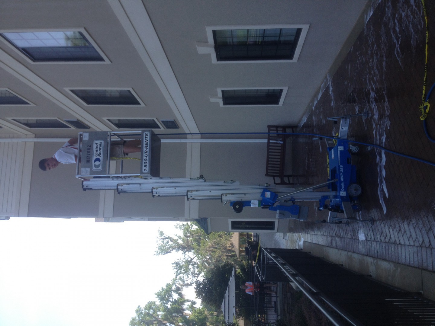

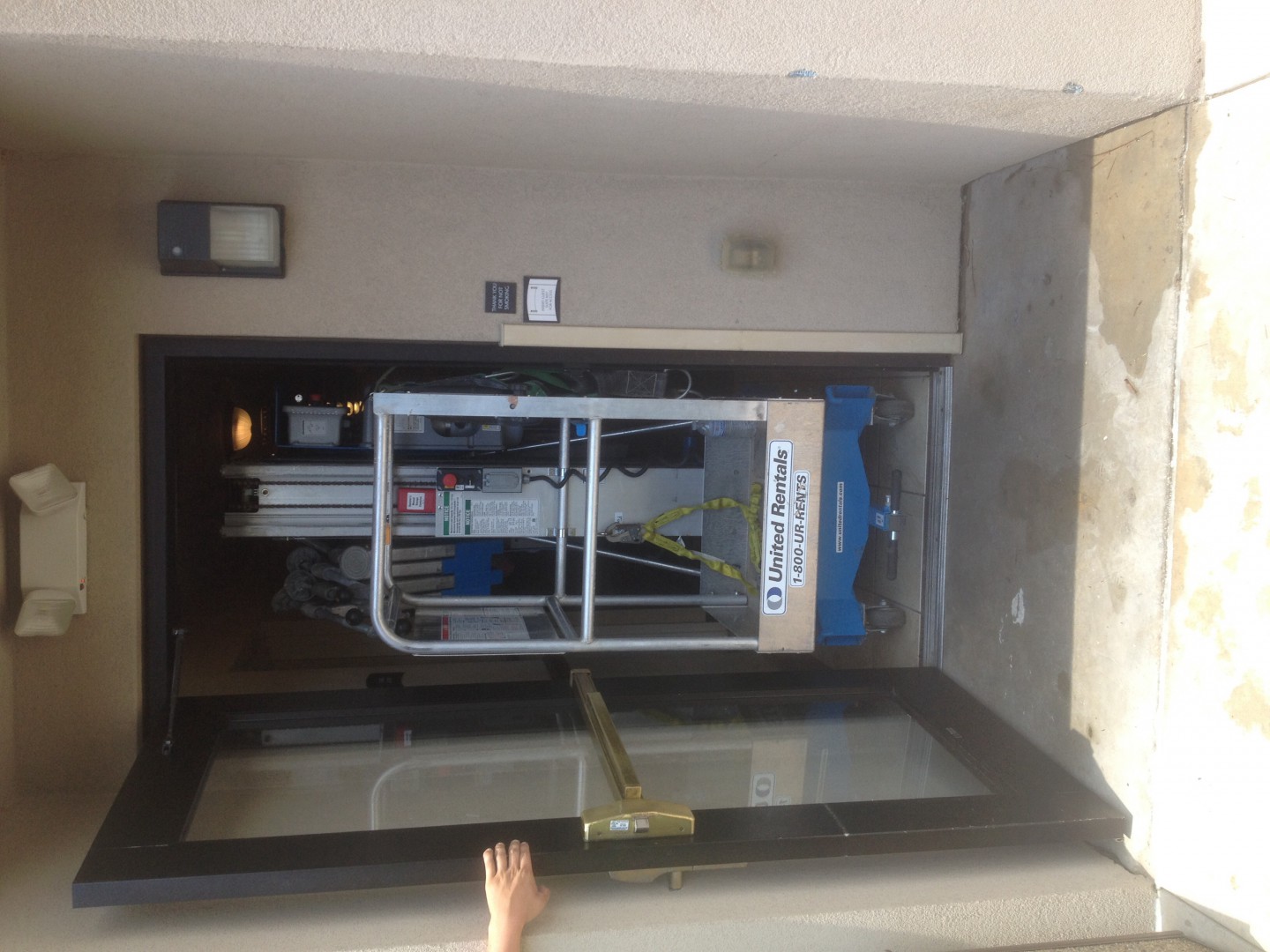

Doing a unique project at a hotel this week. Rear access of this building is very limited due to a two 200x 50' raised patio. Had counted on getting a scissor lift for some of these areas and just rolling through the hotel lobby, but had some concerns about cracking the marble and tile in the entranceways. Even a 19 foot scissor lift Waze about 2000 pounds. I found this little one person manlift at United rentals. It only weighs 850 pounds, is small enough to go through doorways and puts your feet at 22 feet above ground. It's light enough for one crewmember to move around, rents in my area for about 140 per day

Nice find...

I spoke to a rental place recently about a 60ft articulating spider lift thats only 30inches wide for doorways, gates etc. 6ft high 13ft long stowed that even though it is 5000lbs because its on tracks it displaces only 6lbs per sq/inch and was told completely safe for marble floors. they use them for malls etc.
