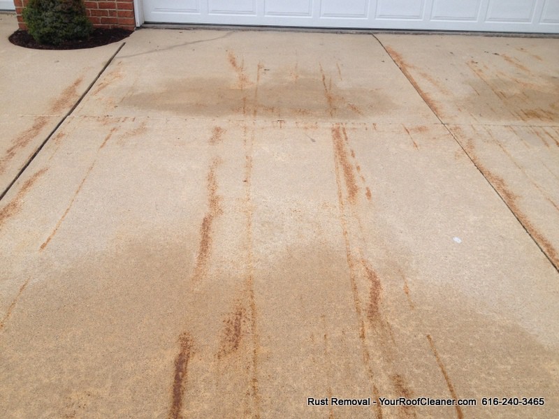

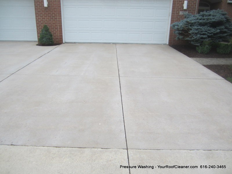

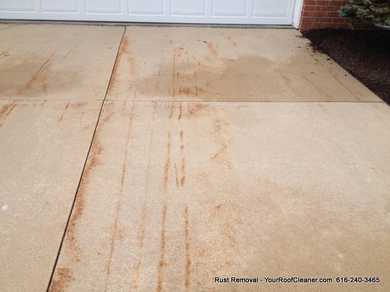

Roof Cleaner got a call from a local landscaping business about one of their customers driveways that had been damaged by the snowplowing over the past winter. The plow had left rust marks all over the driveway and the customer was very unhappy and wanted the rust gone. With some help from Craig and some F9 we were able to remove some very stubborn rust, the homeowner is once again pleased with the landscape company, and the landscape company is pleased with Roof Cleaner of Grand Rapids.

F9 - 1gal - water 1/3 gal.
clean driveway (surface cleaner) apply F9 and let it dry, apply another coat of F9, let it dry. Mist with water and broom the water around. Rinse of the whole driveway, let dry and the rust was gone. This rust was actually dug into the cement by the snowplow driver having to much down pressure on his backblade when dragging the snow this past winter.
